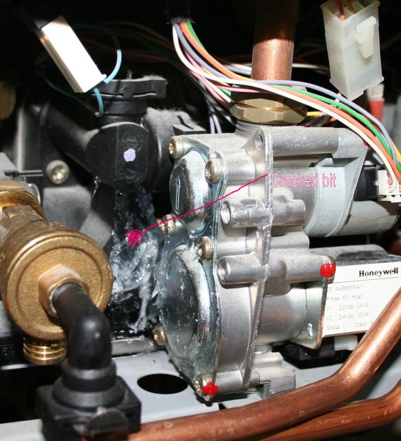

Hello all i hope someone can help me please i have a Glowworm 30 ci plus boiler and have noticed a small drip which is leaking on the floor now on closer inspection i have noticed a very fine spray coming out of a black plastic part in the boiler.I have looked at my manual which was left with me and i cant seem to locate and name the same component the only thing i can identify is the gas valve,and the leaking part is at the very back of this gas valve and the copper pipe which is conected to the leaking part is the domestic hot water outlet.So could anyone tell me if this part is called many thanks.Please Please any help would be great .

I cant make out if that is the bit but i have enclosed a photo of the cracked bit

That's the bit, it's called the saniblock. They all go from here eventually thats why the plastic bit on yours has been replaced by a copper pipe in the pic on the ebay link.

so the one on ebay is the right part for me then???
yes but its beyond the realms of diy. In actual fact you'd get good value from a fixed price repair from Glow-worm, or even a repair and years cover. They'll probably have the part on the van

Many thanks for all your help i have just rung a local plumber who will fit the part for £80 and i will supply the part ,many thanks to all that helped me.The plumber advised me to turn off the main feed to my boiler just in case .
Just a quick update i rung Glow worm this morning and this part is chargable at £250 and the part that is faulty isnt known to glowworm as faulty so legal action is the next step i think
