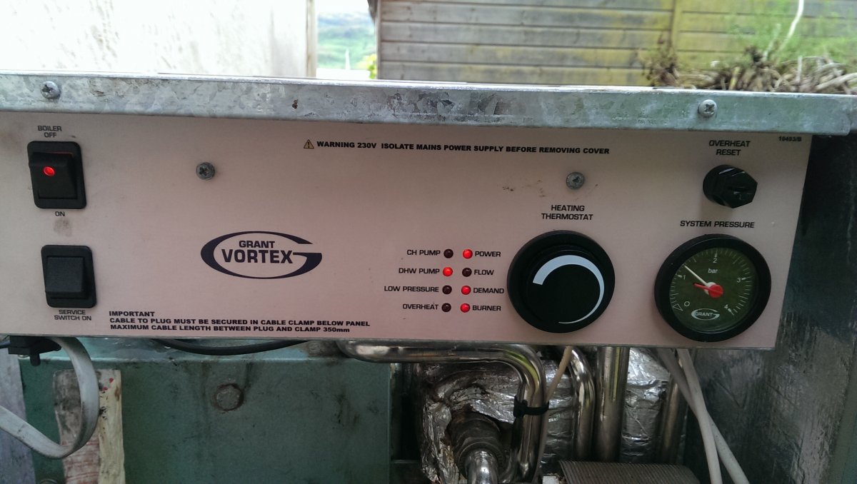

Hi Andy,
Well I did what you suggested this week and although the flow appeared fine I gave the fire valve a quick blast with the air duster anyway as I was there. Once back together and bled the boiler is running fine but now rather than the burner locking out, the boiler control unit seems to be!! The Burner LED has started flashing.
Basically, it is almost all the exact same symptoms (i.e. the boiler runs fine when on full demand, heating the house all the way up from 7 degrees to 20) at which point the house thermostat clicks off for a few minutes. When it clicks to come back on, no heat and on checking the boiler, the Burner LED is flashing. I am going to sit outside today to see if the LED starts flashing once the stat turns off, or if it is triggered once the stat clicks back on.
Could this now be a sensor / main boiler control board issue?
The attached image is an old photo, it shows is the Burner LED I'm referring to.
If I power the boiler off/on then it seems to reset and work fine straight away, right up until the house thermostat clicks off/on again. Gah!!!!!

Sounds like a pcb issue.
If you check manufacturers instructions a flashing burner led states this.
I'd give Grant Tech a call to confirm
Blimey Andy - thanks for the incredibly fast reply!!
I did see in the installation manual about that, thought it worth double checking. :)
Thanks so much for all your help, will see what they say.
