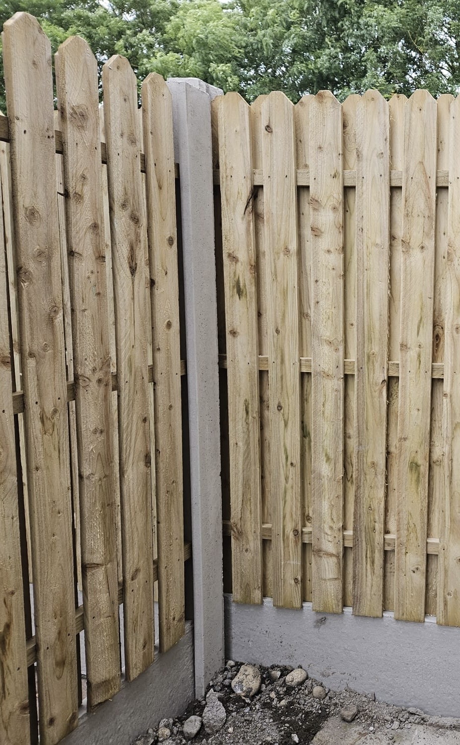

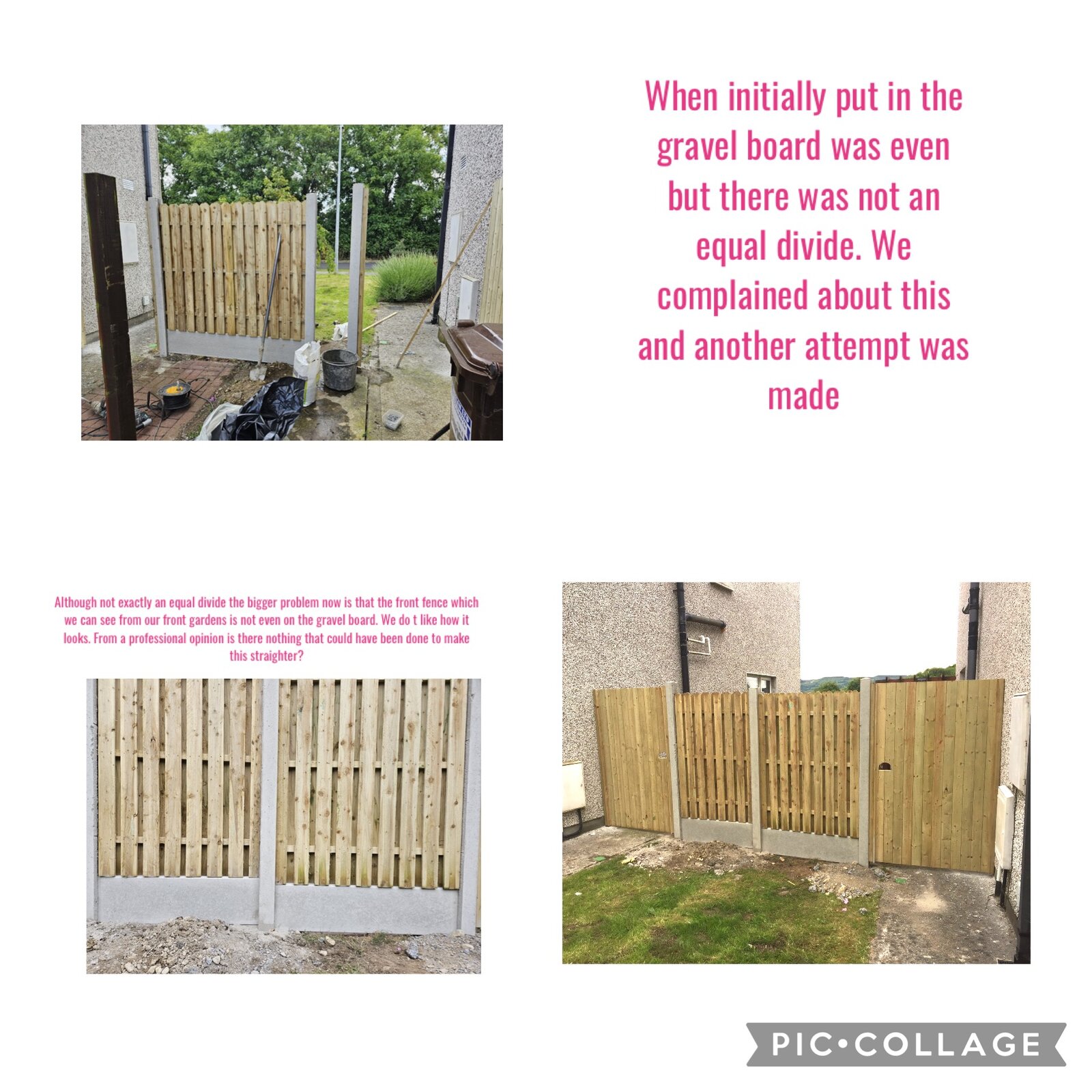

Hi I’m wondering if anyone can help with advice re this fencing - pictures and detail below. My self and my neighbour are paying a fortune for this fence to be erected by a reputably professional fencing company. Am I overreacting or do you think gravel board should be fixed?

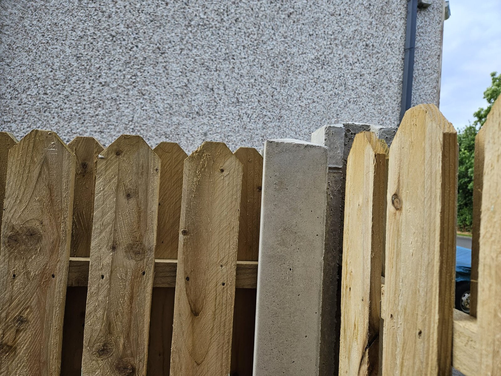

Also this corner piece really looks like it is sitting strangely?

Thanks they said when I questioned it that the gravel board would slant where there is uneven ground but I would expect at least that each individual board would be straight?
Or is the most important thing that the upper part of the fence is in line?
I use concrete gravel boards. Because they are going in at about the same time as the posts are being set in concrete, I often build up a pad of concrete to pack round the toe of the gravel boards. Yours looks like the builders spilled a barrow of mix on the ground. It looks terrible.
But my posts, gravel boards and fencing are level. It would not occur to me to build a woggly one. Except on a hill.
P.s.
On uneven ground, the board does NOT slope.
You can scrape out the soil to bed it level.
It would take 5 mins to dig a level channel for the gravel board to sit in, a 6" one is half the height of yours, you would use that under the normal board to level up, and hide any gaps underneath.
It's a **** show. Never hire 'Bodgit n' Scarpa' and their blind dog, Pew.

It might have been better if they’d created a new level from the gate posts, because the two gates look level — going by the photo — the middle post is still lower than both. Alternatively, they could have stuck to the height of the lower side fence behind the front fence and cut the gates down to match it.
And like others have said, it really needed more gravelboard at the front to raise the fence so the gate posts made sense, or to match the overall look — even taking a few inches off the gate height would’ve helped.
But in a nutshell, its doesnt look good on the eye — gravel boards should always be level.
