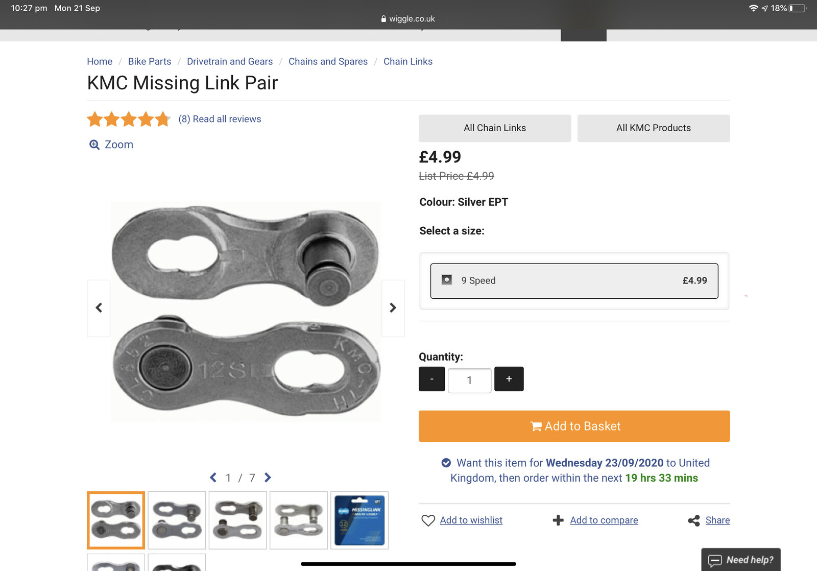

    surely you have to size the chain to fit? they don't come ready sized and if you size it to the size of the old one it will keep getting longer and longer.
    Big + Big + 1 inch is the formula I use.

    Country:
    That’s what I thought but you literally buy one according to the number of gears on your rear wheel. 7,8,9,10 speed etc. The more gears, the thinner the chain links are. If you’re still not sure, get one with the 'missing link' (no tools needed), check it for size, remove any links if you have to and then put it in your pouch. The worse case scenario if you don’t do that is that you may have trouble getting the very highest and very lowest gears (largest front and largest rear or smallest front and smallest rear) but at least you will get home!

    No you've misunderstood me. The chain needs to be sized according the the length of the chain stay and the number of teeth on the big chain ring and largest cassette gear. The 7,8,9,10,11,12 etc determines the width of the chain. An XS Frame will need a shorter chain than the XL frame for the same gears.

    Easier way then is to buy a chain dependant on whether you have 8,9,10 etc gears on the rear and then just count the links on your existing chain and ensure that your replacement chain, including the missing link, has the same number of links. I am of course referring to something that will get you home. Any fine tuning by the addition or subtraction of a link can be done at home in the warm and dry although if you have the same number of links on each chain, it should be a perfect fit.
