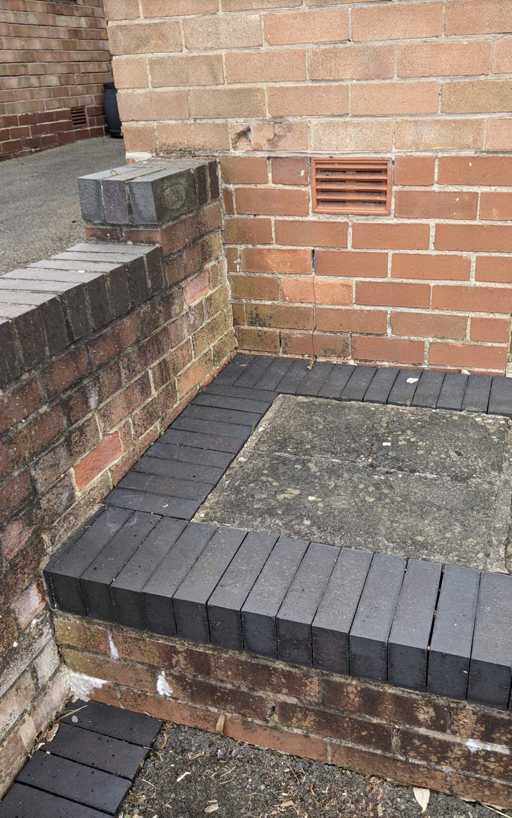

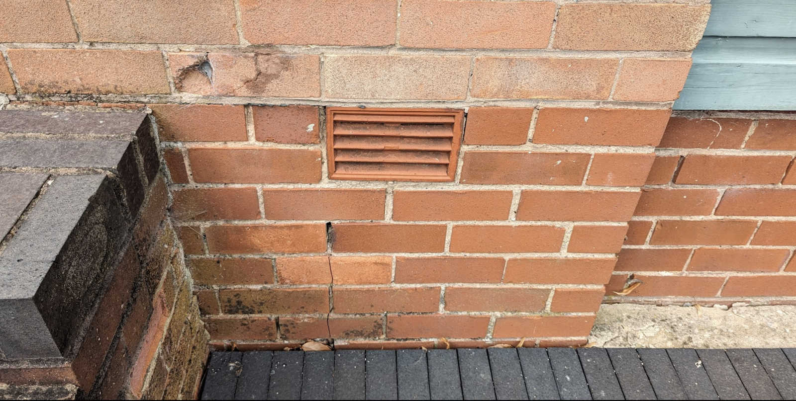

Had a builder come and take a look at the bricks below DPC on my detached 60s suspended floor property.
I asked if he thought it needed repointing and to quote the work if so.
He recommended grinding back the bricks severs inches (if i remember rightly) and then attaching cut bricks.
Can anyone comment on this? The bricks above DPC seems to be fine and appear to be of a different type. I don't want to spend loads of money on something that doesn't need urgent attention. I was concerned the coming winter would lead to further damage.
He also recommended putting some kind of resin on the raised pathway here in front of the house in addition to the adjacent wall being rebuilt or rendered.

I'd just jetwash it, put some sort of sealant on and forget it.
There are one or two you could replace, but you won't get a good colour match and it's definitely not going to fall down within anyone's lifetime.
Unless I'm missing something it all sounds like justifying taking a load of money off you.

What sort of sealant?
Don't waste your money. Even the clean is optional. You could actually help that along by spraying or brushing it with a biocide, such as decking or path clear.
That person is touting for work - work which I'm sure he would love to do and charge handsomely for the privilege.
Was this all the result of a cold call? If so then don't listen to a word they say.
I was assuming you were concerned about the appearance, hence the suggestion of jetwashing. If you're happy with it cosmetically then nothing would be the best course of action.
Any decent jetwashing company would be able to advise on biocides and/or sealants. I wouldn't put sealant on the wall below DPC, as it may trap moisture in and/or end up going white. It would help the paving to stay clean though.

I asked them to come and look to see if work needed doing to price up if so.
The quote came back as £675 to
Raking out of all bed joints to a minimum of 25mm• Repointing with fresh mortar below DPC in front and side elevations• Joints to be raked out of existing patio slabs on front and re-filled• Small concrete strip taken out and re-filled with fresh concrete to front of house
Quite simply, no.
Jetwash the concrete yourself, and the side wall if you want. As said, you can use a biocide if you wish, then apply a sealer to the concrete. I've seen walls in a much, much worse state than yours, (you should see the property I am renting at the moment), but there have been no issues with the structure or damp etc.
By inviting someone to come to look at something, and then ask them to quote if they think it needs doing, is simply giving them an open opportunity to fleece some money off you for minimal effort.
