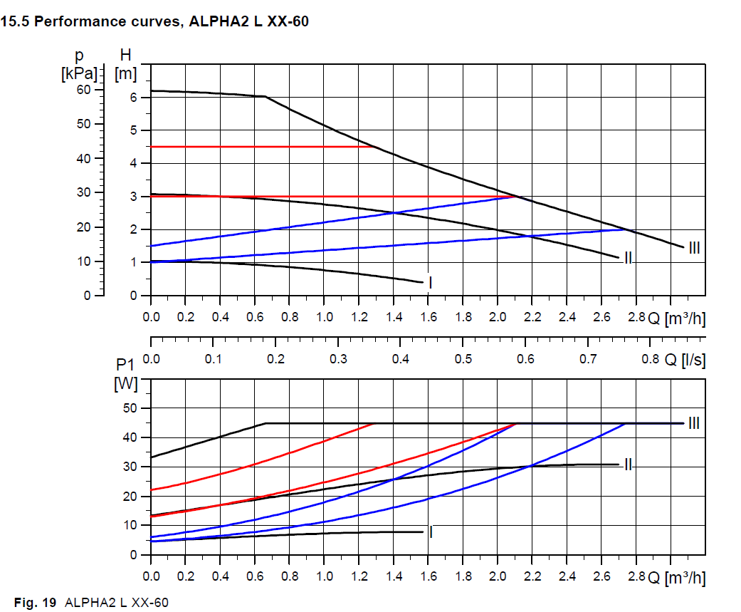

I have a British Gas 330 boiler with a Grundfos Alpha 2 15-60 130 pump, 15 rads plus vented cylinder.
Trying to figure out the correct pump setting, the manual says recommended mode is Auto Adapt but this only runs around 6W and doesn't seem to give enough flow (does Auto Adapt actually work?).
Alternative recommended modes are PP1 or PP2, in PP2 it runs about 11W which would seem to give a flow of around 900 l/h from the graph? AFAIK boiler is set to default 18kW and needs min flow of 774 l/h
What should it be set to?
The only pump I have seen working in Auto adapt mode is a Tucson running at ~ 23/26W.

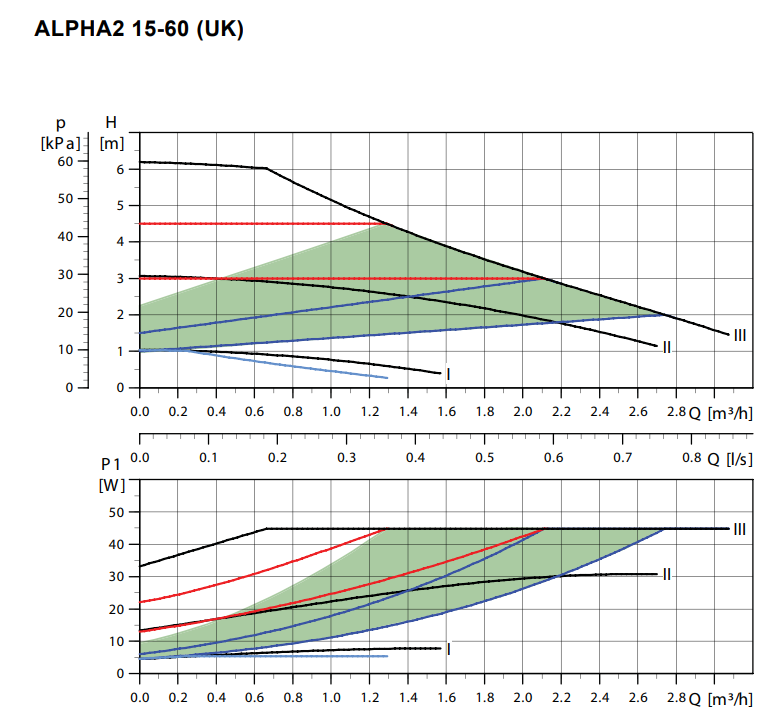

Grundfos PP modes are also far too low, I make out 11W on PP2 as ~ 500LPH @1.8M.
If my curves, below are correct then suggest CP1 as that should give ~ 645LPH. Alternatively, maybe CC2, post back your readings on both and if to hand, the pump curves that you have.

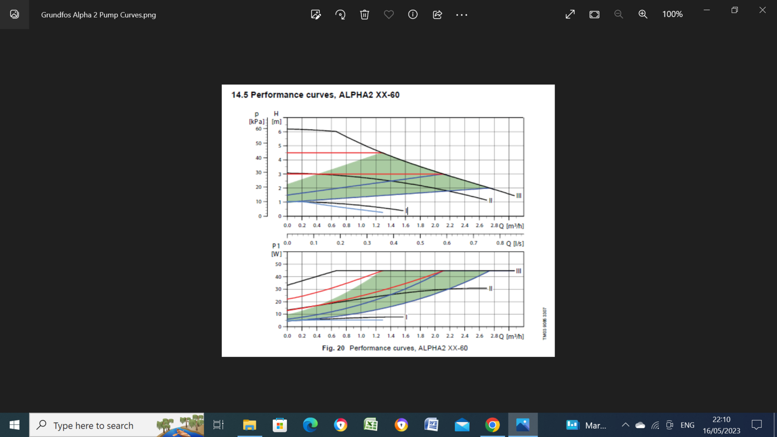

I'm getting a bit lost with it, these are the curves I was looking at, just re-tested and I'm getting 9W on PP2, with 1 TRV open and a towel rad with no TRV I'm getting bursts of heat but the ABV is opening despite setting it higher.
You are getting 0.35m3/hr, 5.8LPM @ 1.7M head, if the ABV is working properly then any setting above 2M (0.2 on the index) should mean that its not bypassing anthing. What index is it set to??
Is it hot on the downstream side say a foot or so away from the ABV?, if so then either its knackered or a bit of crap has got trapped under the seat. The only two settings that will cause it to bypass at 4.5M is just maybe CP2 at 4.5M and CC3 at > 6M will certainly cause bypassing.

You can tell exactly what the flowrate was with that smart pump, just shut the ABV, run the pump on say CP1 (3M) and read off the power and then read off the flowrate from the pump curves, that will give a good feel for whats going on.
Assume your two rads have a combined output of 3kw at their full rated output, if so then the boiler will probably still cycle unless its min output is < 3kw.
If you have a few readings post the mode and watts but with the ABV shut.
What model Drayton TRVs?.
As a guide, if you use a flowrate of 1.0LPM per kw (rad) this is a dT of 14.33C, so those two rads IF ~ 3kw will flow 3LPM (0.18m3/hr) and the pump will have a power output of ~ 14W on CP1.
14W on CP1
