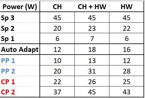

I also checked fixed speed II on HW only and this reads 15W, doesn't this mean the flow is still very low looking at the graphs?
Yes, very low flowrates.
CP1 at 15W, = 1.7LPM
CP2 at 26W, = 4.83LPM
CC3 at 40W, = 6.3LPM
Flow is prop to the sqroot of head so CP1 at 3M should flow 4.83*Sqroot(3/4.5),
3.89LPM and CC3 at 6M should flow 4.83*Sqroot(6/4.5), 5.6LPM.
Wonder if this pump is now suspect, if you are confident you could remove the complete head and check the pump ports and impeller vanes for crap, if you have the pump isol valves with a spindle that you shut with a adjustable spanner then no problem with leakage but if they are the ball type with a allen key shut off then almost guaranteed to leak.
This may be of some interest, from someone with 10 rads + HW cylinder. System in excellent condition with F&E Tank.(same, Alpha 2 Pump).
CH only, CP1, 22W = 13.3LPM.
HW only, CP1, 25W = 17.5LPM
