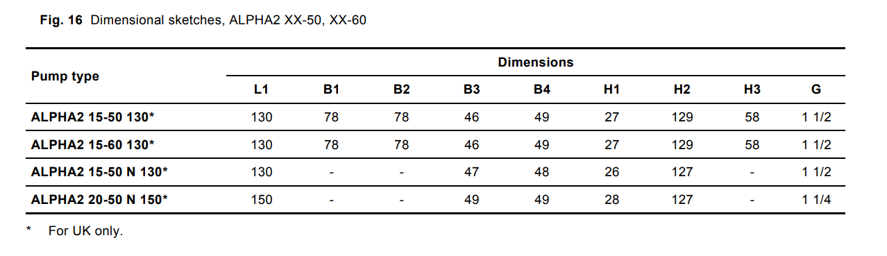

Grundfos Alpha 2 15-60 130 Setting?

The OD of the 25mm port pump (and I would think, the Wilo) is 47mm if thats any use to you.
Probably right, the Wilo I think is 1.5" BSP, 47.8mm OD. 1" BSP is 33.25mm OD and 1.25" BSP is 41.91mm OD. so you will need new valves if you purchase the Wilo.

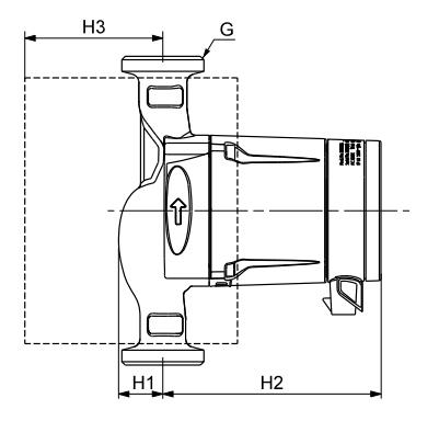

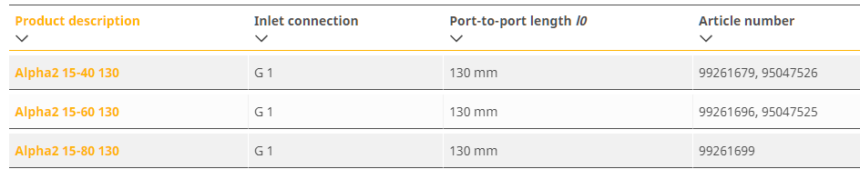

The Grundfos manual says G on this digram is 1 1/2 so I'm confused now, maybe thay are both 1 1/2?

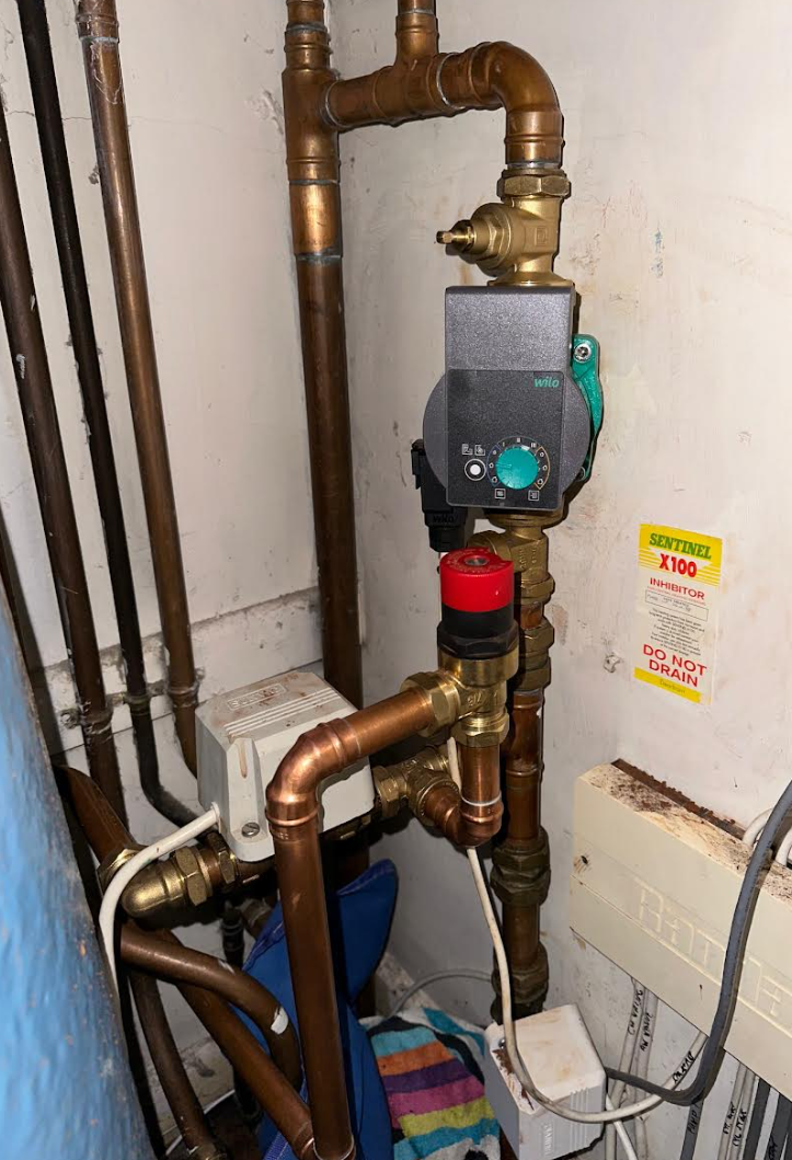

It's fitted!! Added another bottle of Fernox F3 for good measure. Seeing some better flow but the ABV seems to be open.
Old pump had a lot of deposit around the inlet, checked the impeller with a camera and it wasn't clogged up. Pipe and elbow above the pump also had a fair amount of crud so cleaned it all out and replaced the input gate fitting.
Flow seems to be improving all the time, need to sort out why the ABV is now open, its wound right in as well.

Fantastic, :giggle::giggle:, definitely on the right track now, cleaning out the crap probably had a big effect.
That Wilo displays the flow I think which is very handy? Does it display the running head as well?.
Did you have to replace the pump isolation valves?
I would definitely renew the ABV but not with a Tower.
I wouldn't go so far as to say they are no good but have seen very poor posts re their TRVs, if you have replaced it again with another Tower and it works, then fine.
Are the readings above taken with all 15 rads "on" with the TRV heads removed?.
