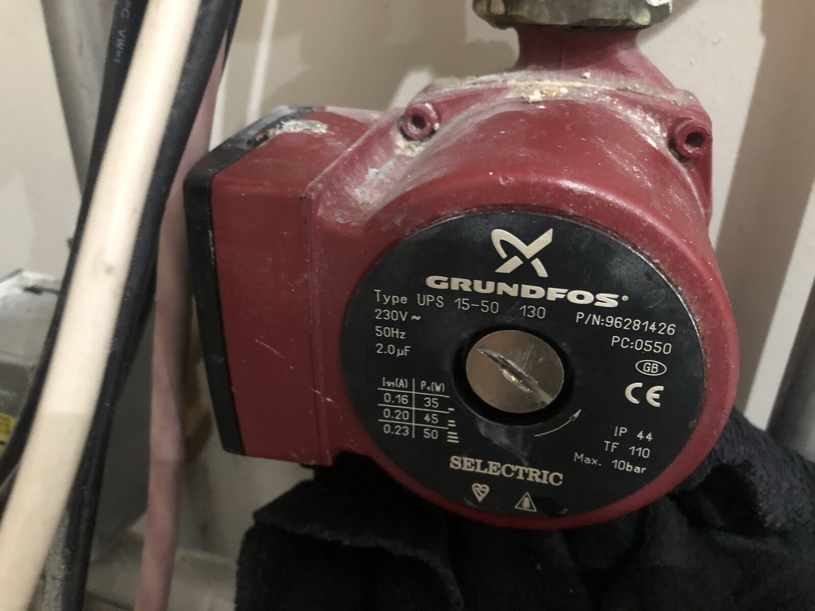

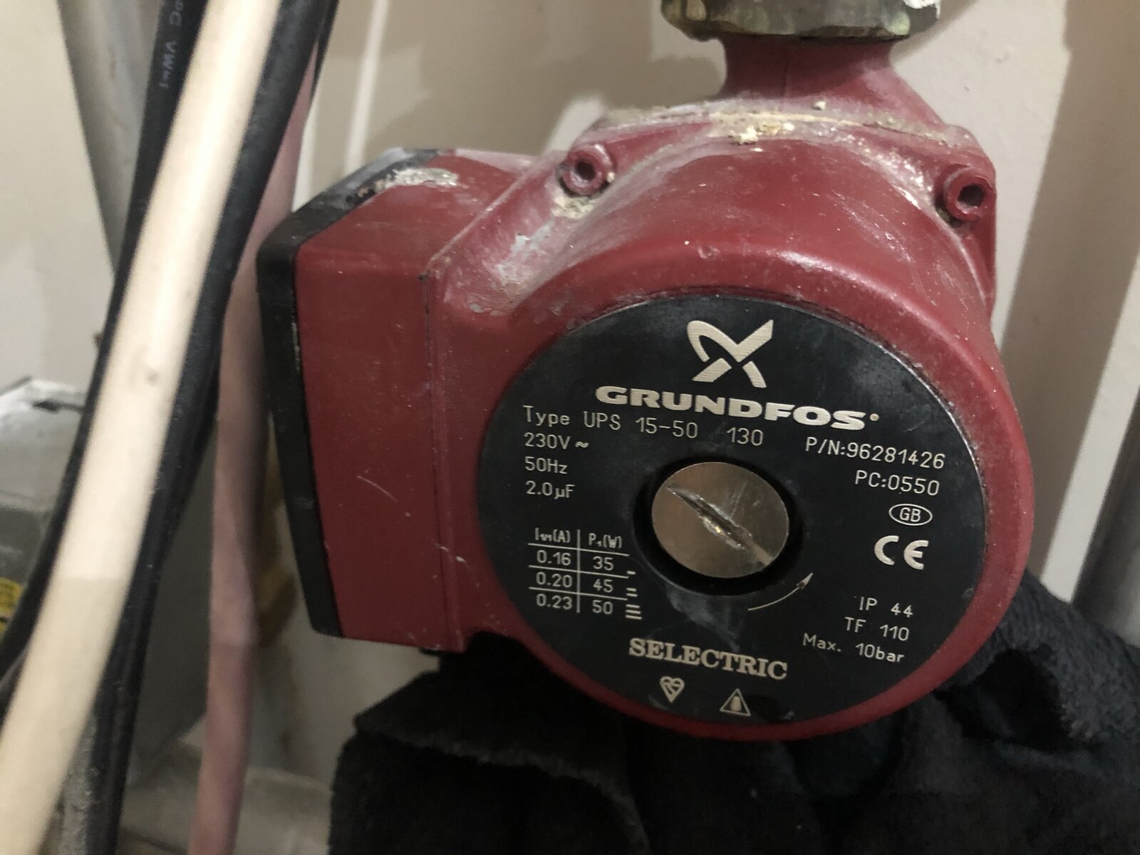

Hi all,
I have a Grundfos pump which seems to be struggling to start on its own. Yesterday I noticed the house wasn’t heating up very quickly and as I had the same issue about a year ago, went straight to the pump. I opened the valve and the spinner wasn’t spinning. Whilst calling for heat, I used my screwdriver to turn the spinner either way and it still didn’t start spinning. After some time I realised I needed to push the spinner into the pump for it to start catching to then start spinning?! Eventually after a few attempts, it maintained spinning and seemed to be operating (at least to some degree). This morning after the heating was off overnight, the same issue has happened. Do I need a new pump or is there a part I can replace to save cost? Thanks in advance. Chris
Update, I’ve just had to kick start it again and the heating hasn’t been off!

1. The start capacitors are replaceable. They are about 7 or 8 microfarads, but MUST be mains AC rated. Not electrolytics.
2. However, it sounds a more mechanical fault if you have to push on the spindle to get it to start. I'd replace the whole pump.
...... and maybe get the system cleaned. That may be more obvious when you have removed the old pump and can inspect the volute. THese circulators use the system water for lubrication and cooling and any crud can jam the rotor in the stator.

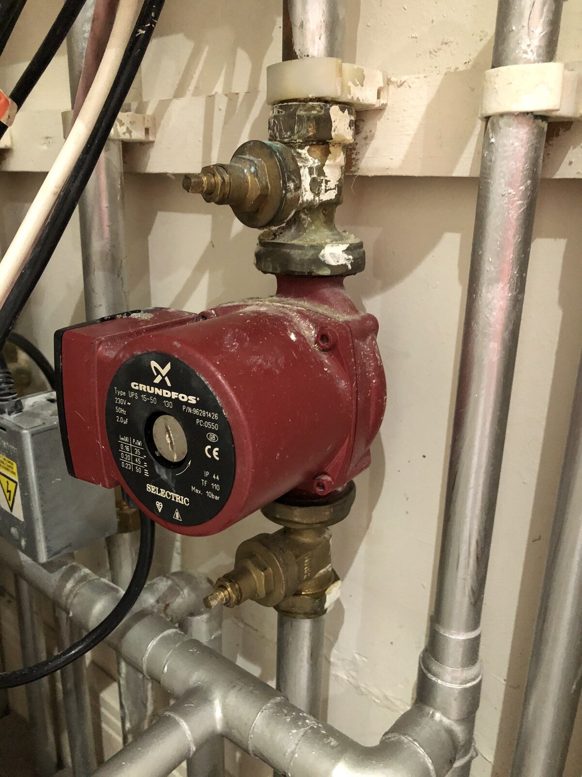

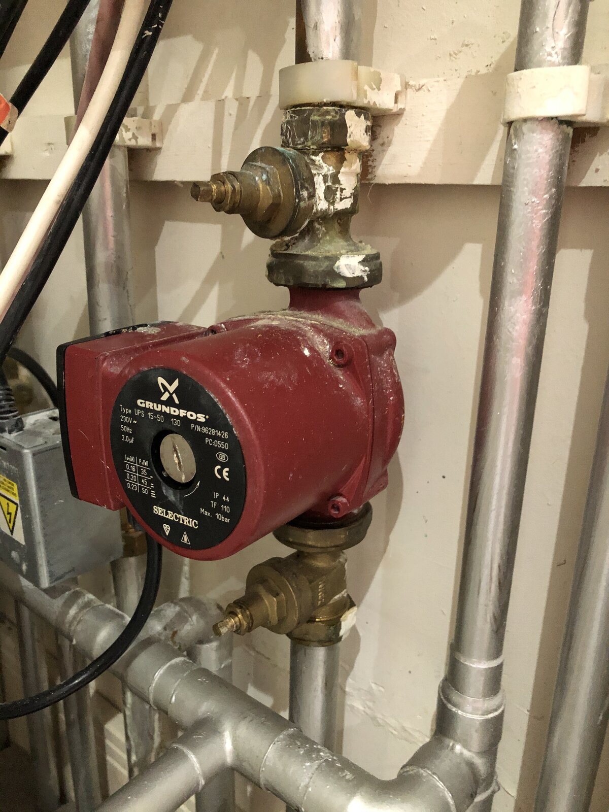

Hi all so an update. New pump has arrived, gone to switch valves off and at least one of them isn’t holding which means a system drain. I’m thinking it may be an idea to replace the valves at the same time as the system drain? If so can anyone recommend suitable valves I need please? Current ones say 28mm on them.
Cheers, Chris

1. When you say one of the valves isn't holding, what do you mean?
2. The valves are on vertical pipes. These are usually the least troublesome, as the muck which can cause them to let by is usually washed through. Try slackening the gland nut (the smaller brass nut nearest the handle end of the spindle) a turn, then opening and closing the valve a few times. Might seal better.
3. If its only letting a small amount of water through, you could consider just letting it run and catching the water in buckets / old towels etc. provided you are quick with the pump change.
4. Or consider freezing the offending pipe.
5. If the pipe outside diameters are 28 mm then you need 28 mm valves. Screwfix 1743V would do, but if you can find them Pegler valves are probably better quality. Whatever you do, don't get the valves with 1/4 turn screwdriver slots.
