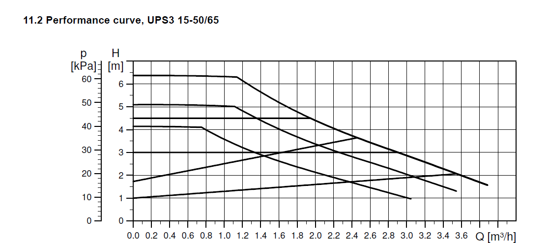

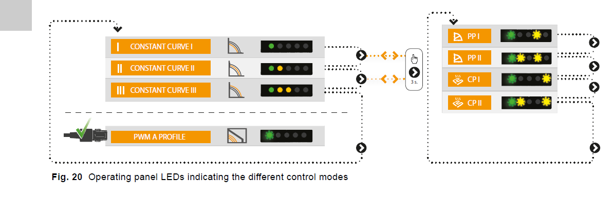

Constant pressure doesn't work for plumbing with variable flow.
Basic fluid mechanics.
Constant pressure means that flow reduces as area (valves close) reduce. It can't cope with system loss and differential.
This is why it's used primarily for ufh.
PP whilst not perfect is actually designed for head loss found in typical CE systems.
It's not perfect but nothing is.
Use PP.
Or CS.
