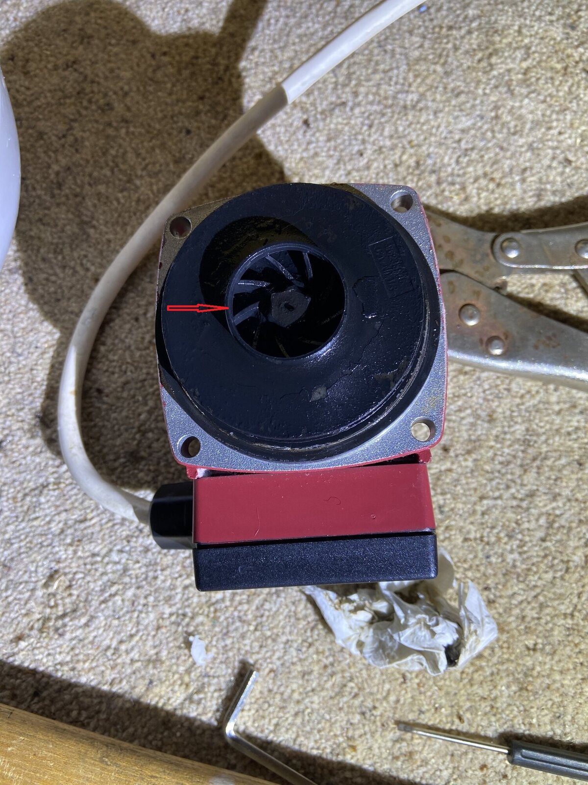

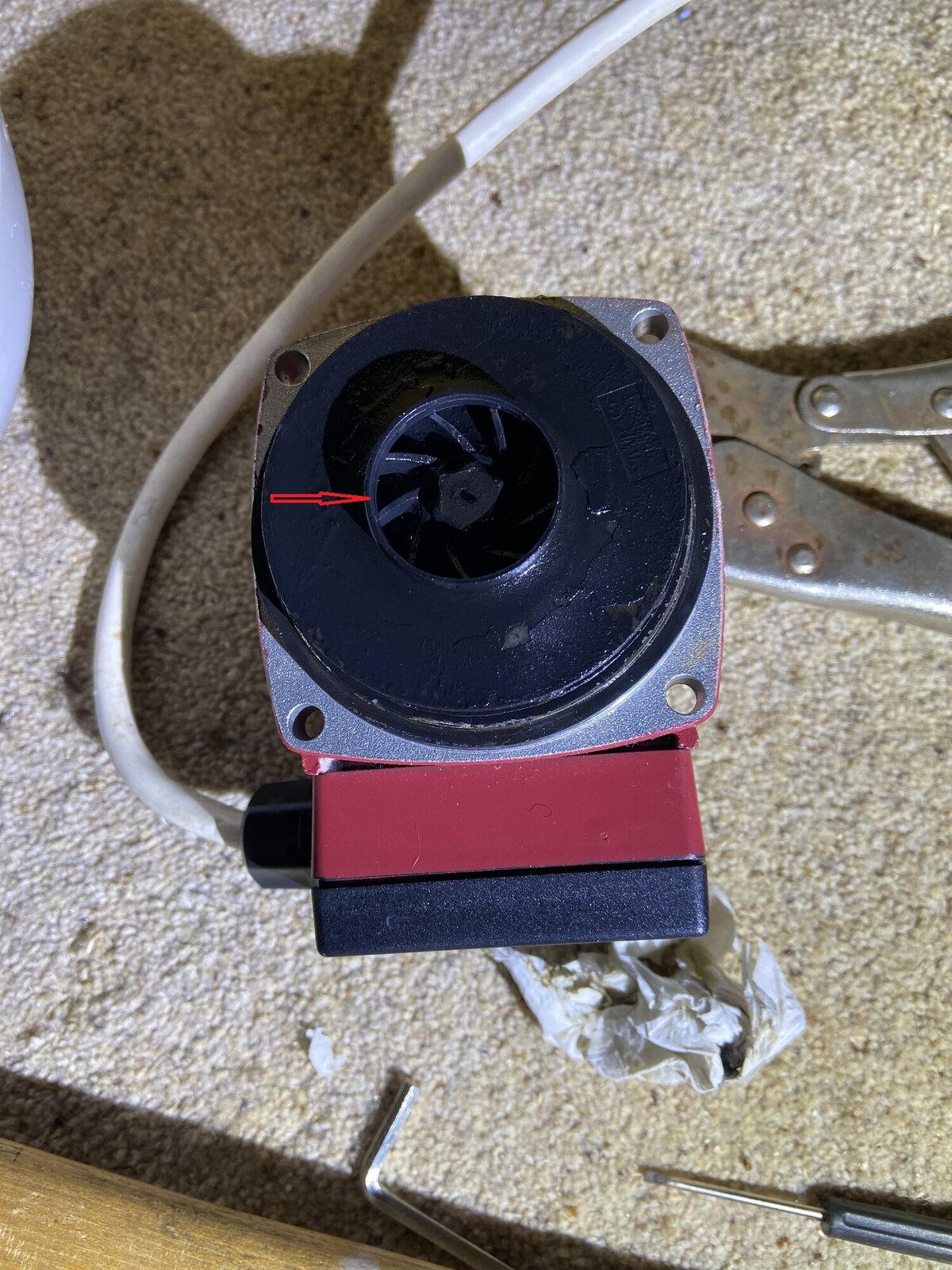

You can inspect the pump two ways, one, the proper way, is to isolate the boiler, shut the pump inlet/outlet valve, remove the 4 stud bolts and remove the pump head complete with impeller, (see below). Check for sludge in the pump body ports, then open say the pump inlet valve partially to check that you have a reasonable flow and flush 2 or 3 litres into a bucket or whatever, shut the inlet valve and repeat with the outlet valve.
Get a tie wrap and push it through each pump impeller vane (to prove clear) in the direction of the red arrow. ("Impeller rev1" photo)

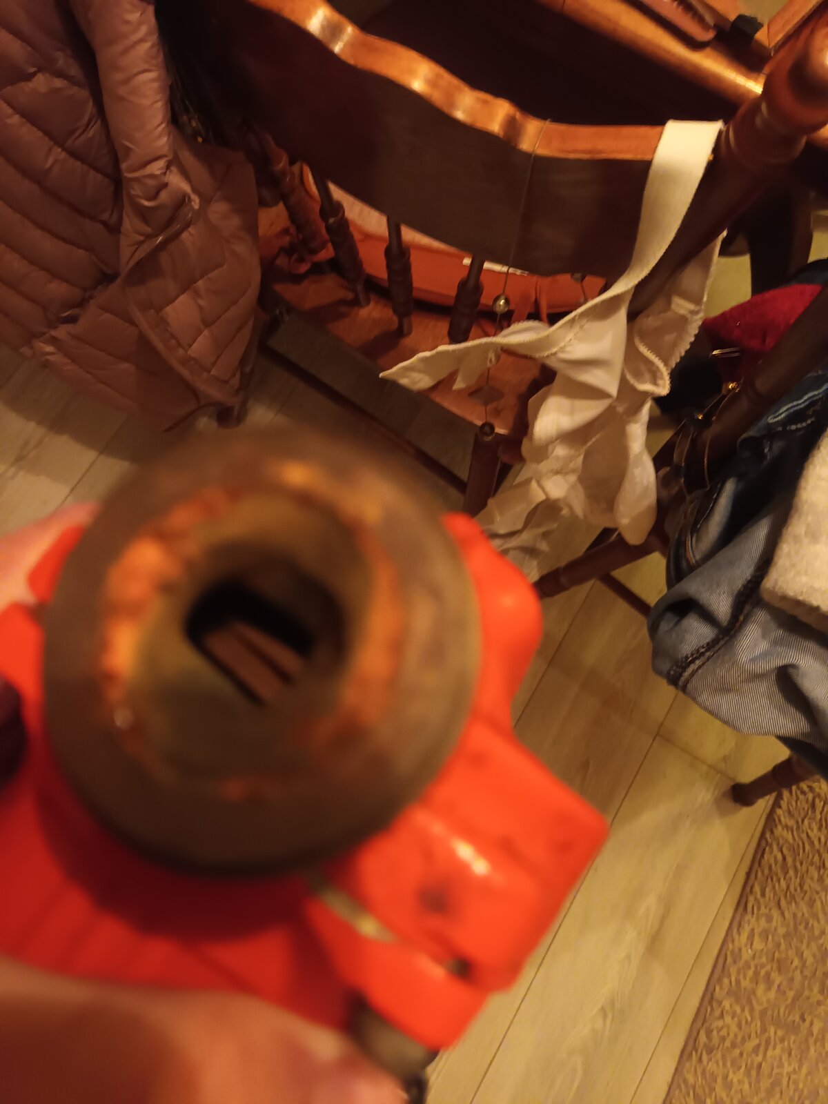

If you are not happy to remove the pump head, just remove the whole pump (which you are certainly used to doing!) and repeat the flushing as above, you should be able to see the pump impeller by looking through the outlet (see "Pump Impeller" photo below) and maybe stick something through at least one impeller vane to prove clear, the pump impeller photo is from my own 18 year old Salmson, still running perfectly, I only changed it because I'm interested in pumps and installed the Wilo, it is now running a neighbours system whose pump packed up one Christmas a few years ago.
IF the above shows up nothing amiss, I would then, if not before, buy that energy monitor which will 100% tell you if you again? have a pump problem.
When reinstalling use rubber gaskets.
