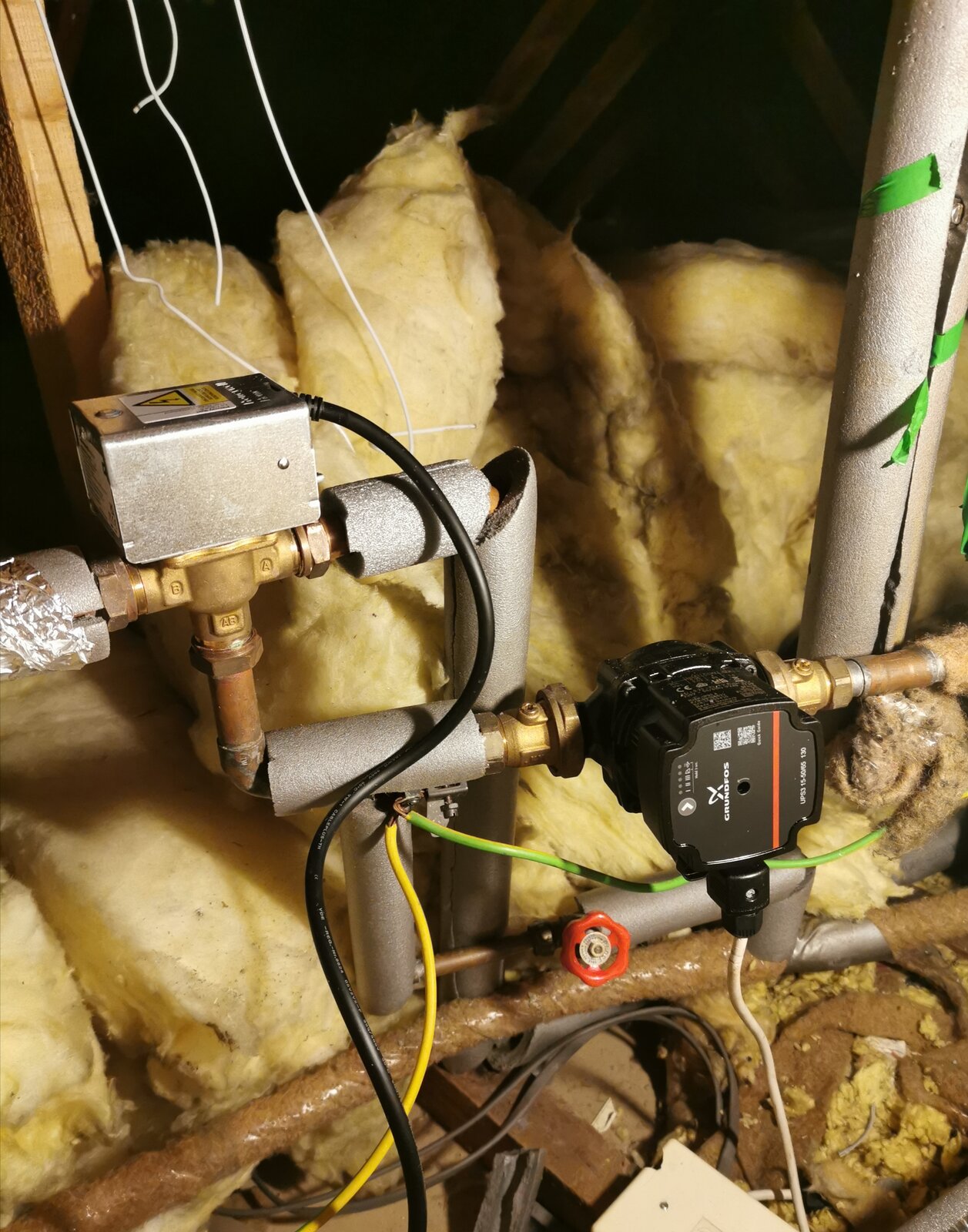

Hi all, I got a grundfos ups3 it's on the 3 setting and as per the attached video it makes a loud noise. This can be heard in the landing and ground floor 2 and the pump is the loft.

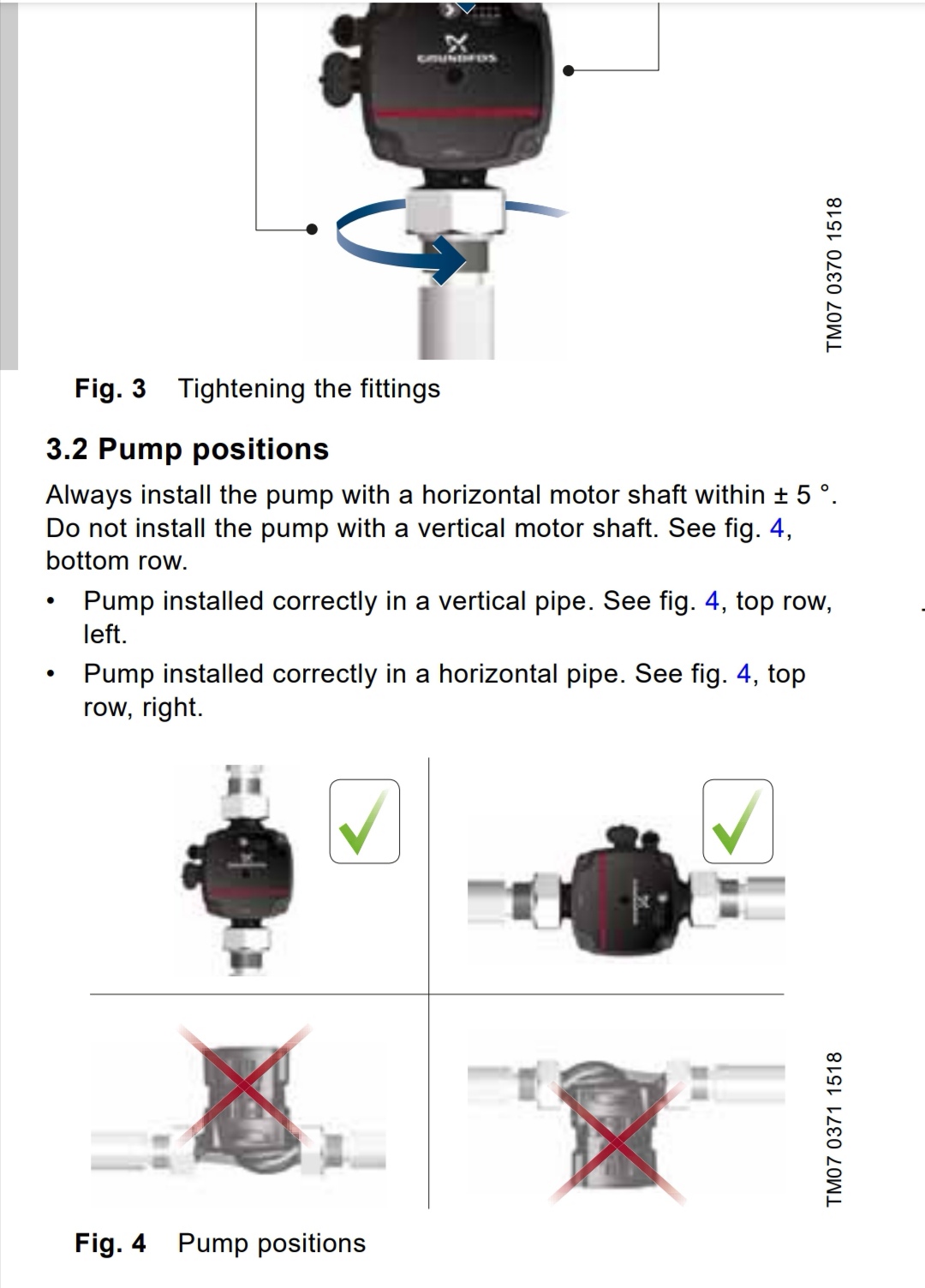

I believe I have installed it correctly however I always get confused regarding the shaft orientation.
I have installed it as the top right image however my cable is on the bottom, installed in the directional flow. The body is facing the side and not upwards.
I can hear water ticking in some of the upstairs radiators but not in the downstairs ones.
11 radiators in total 9 are large type 22 (1.8m x 60, 1.6 x 70 etc) large 4 bed extended house
Is the speed too high?
Getting into the loft to change speed settings everyday isn't easy, loft hatch in the corner of a bedroom that requires removal of furniture and then crawling back into the other side of the loft!

Pump arrow faces towards motorised valves. Without seeing the whole system, wouldn’t have a clue. Open vented or sealed systerm
Yes it does. Apologies don't have a pic of the setup
But it's installed like this with the motorised valve on the left side.
Open vented system.

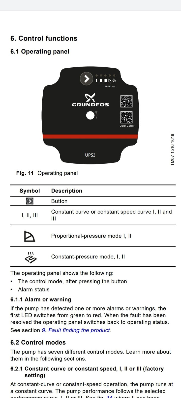

THe UPS3 is a very powerful pump that will still maintain well over a 6M head with flowrate of over 19LPM on speed3, suggest, initially, changing to constant pressure (CP) setting 1 which is a constant 3.0M head, it will certainly reduce the noise, if too weak suggest changing to constant speed 1 which is still a 4.2M head.

I've had this for a few years, replaced it a couple times however. Either due to sludge or incorrect setting /installation. A powerflush was done last month and I replaced it again as I thought the rads weren't getting hot enough.
Originally I had the old type grundfos ups15 50 I believe the ones with 3 fixed speed settings and that used to be on the highest setting.
There is a red gate ABV fitted.
Can you please explain CS?
Pump modes:
CS= Constant speed. (old type)
PP= Proportional Pressure (Variable speed brought in to reduce power consumption on a EU wide basis)
CP= Constant Pressure (For UFH).
If you have a Red handled Gate valve (Not an ABV) as a bypass, that is manual.
(I dunno what voodoo Plumbers use to set the constant flow rate though. I would suggest 1/2 turn and see how you go. Perhaps others can advise.)
For a manual bypass, the boiler will have a minimum flow through rate you should be adhering to.
Thus, when all the valves close (Zone, etc) the boiler still has somewhere to dump heat.
Normally, you set the pump to the lowest you can get away with.
So, with a manual bypass, Set the pump to PP mode 1.
If that is unsatisfactory, set it to PP Mode 2.
If that is unsatisfactory, then you need to look at the plumbing schematic and make sure the bypass is correct, etc.
If you have a ABV (SPring loaded automatic bypass valve), then you can't use it with a pump in PP mode. You should switch to CP mode (Constant speed) and again, walk up the speeds until you get a satisfactory outcome.
