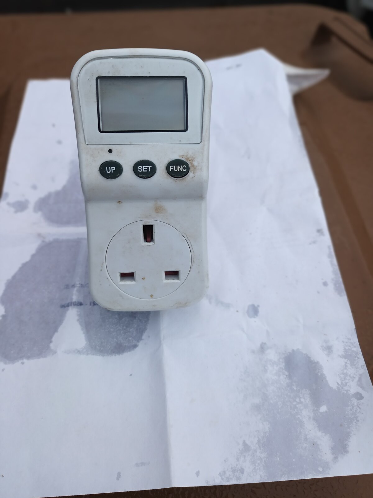

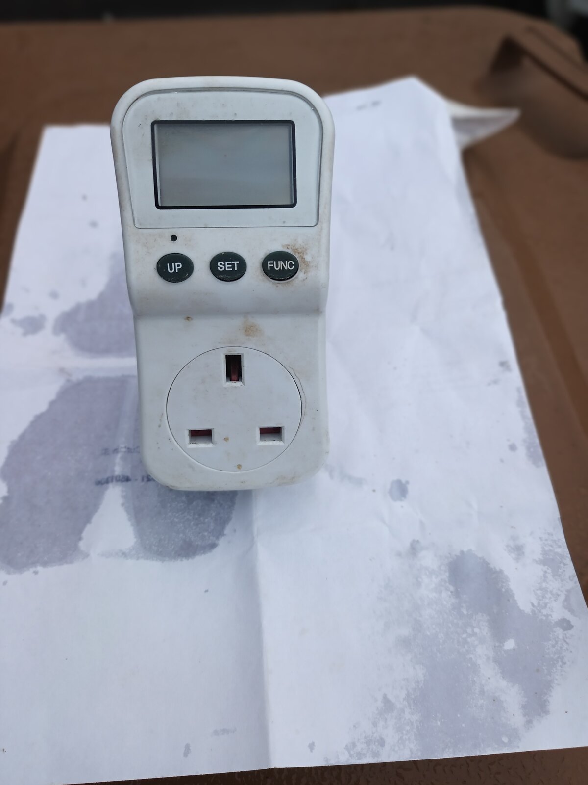

Before rushing off to buy yet another circ pump you might consider spending £15/£20 on a energy monitor (see below), you can just remove the pump cable from its terminal box, stick a 3 pin plug on the end of this cable, get a extension lead, plug the energy monitor into the extension lead and plug the pump cable into the energy monitor, you can then switch on the pump shortly before firing up the boiler and then read off the power in watts from which the flow rates/head and system and pump condition can be easily calulated, it might seem a bit complicated but really isnt and may save you hundreds.

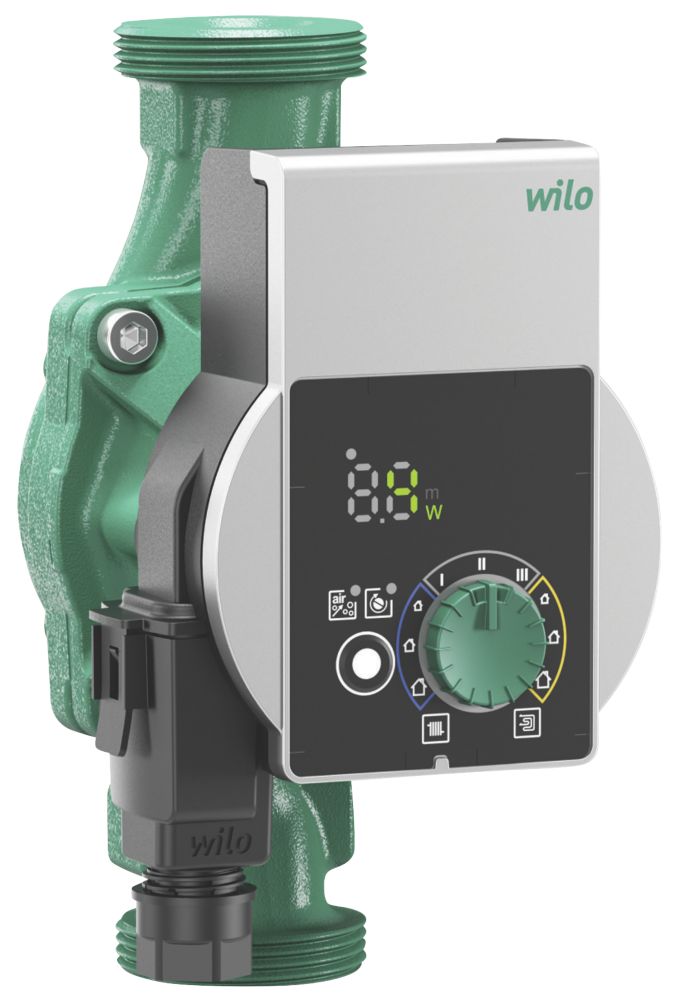

I may get the below. It has 5 year warranty. The 6m head one has 1 year warranty.
Rotating the pump head will achieve nothing.
You should be able to return that and get a refund?
I couldn't advise buying the 5M Wilo as it would be on the weak side even though your original pump was a 5M, the 6M should be OK but remember if you have a system problem the Wilo or any other make won't cure it.
