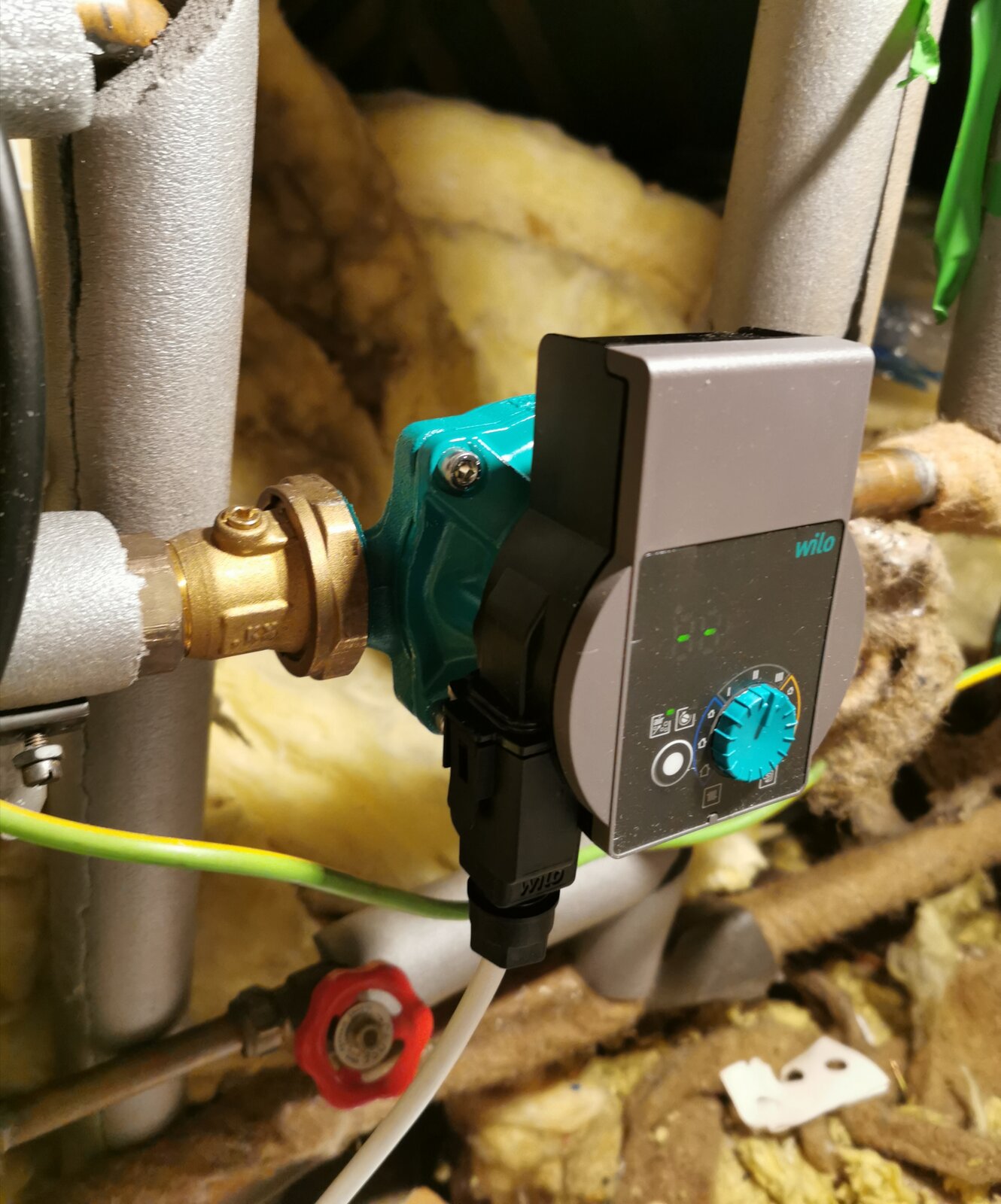

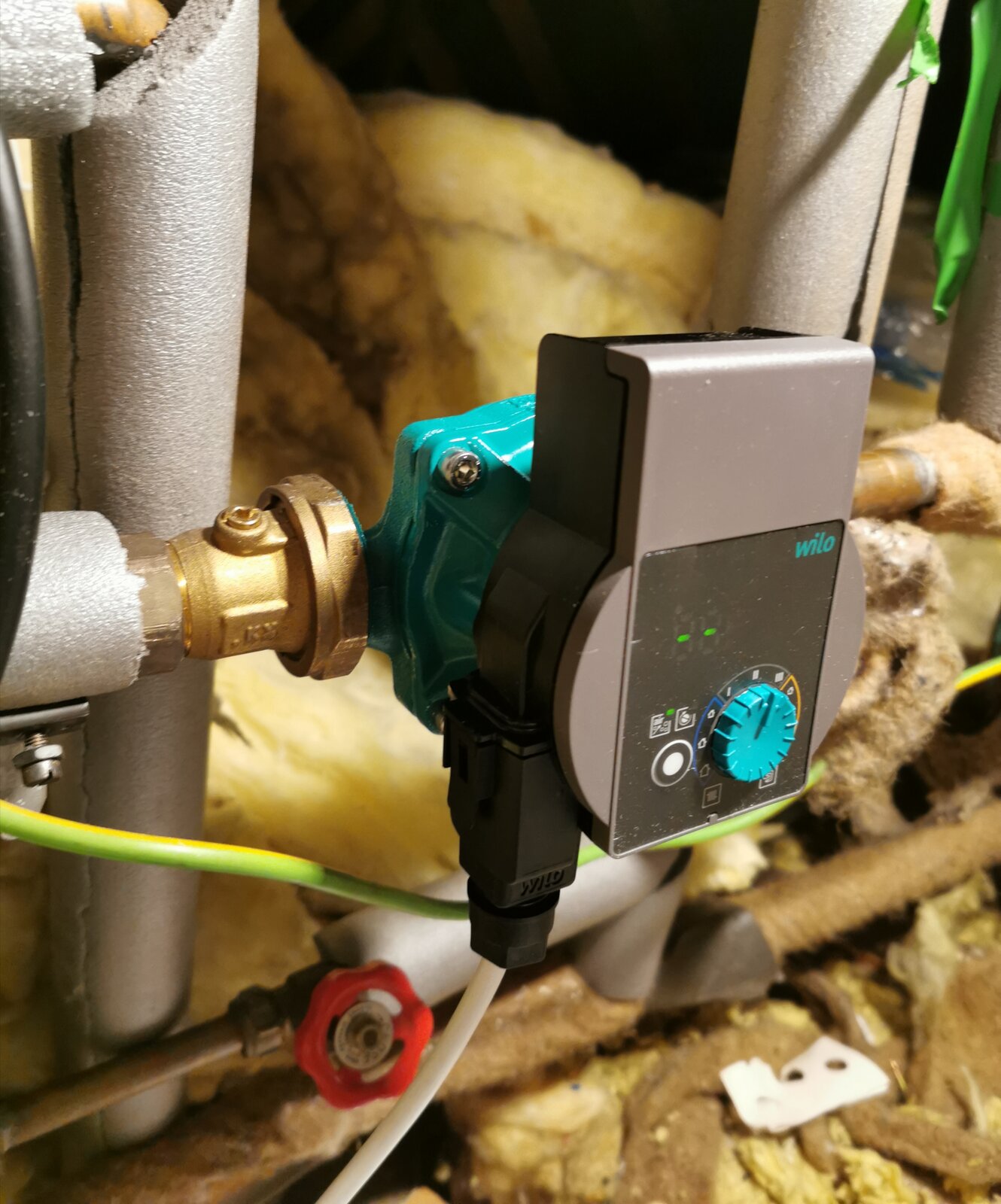

So, you have installed what?, the 6M Wilo Yonos Pico?, you say you have rotated the screen, I hope you mean you just removed the 4 bolts and rotated the whole head?,
Also, forget about the 10minute venting, the boiler may go into anticycle but the pump should continue running, put it on C2 and see what happens.
Please see edited post above

It's doing its 10 minute air release in that photo. It should then, I think, start up in whatever mode you have selected, I will check my own later on, if it isn't then switch off the mains supply to the boiler. Switch it back on and the pump should restart in C2 mode or whatever.

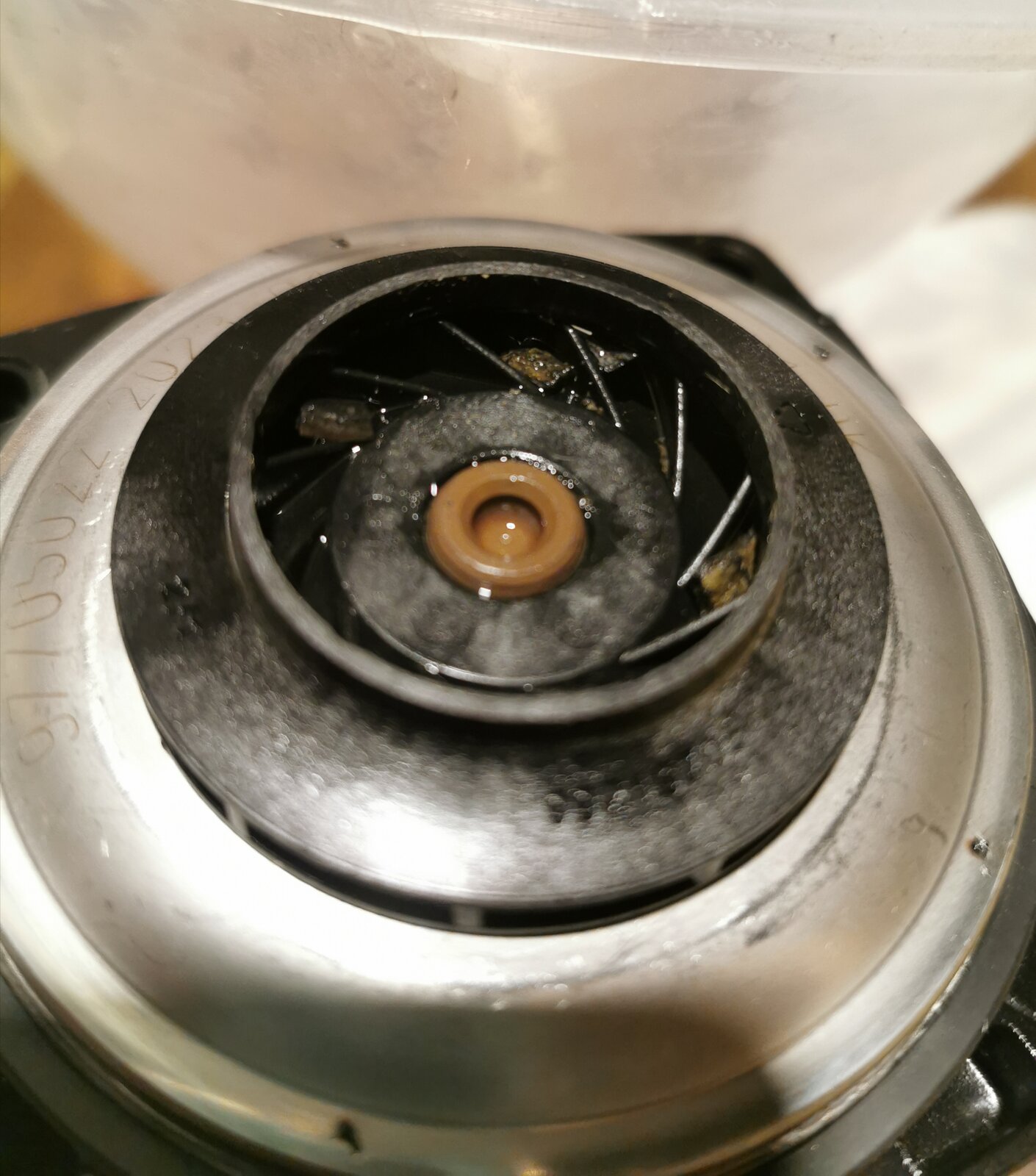

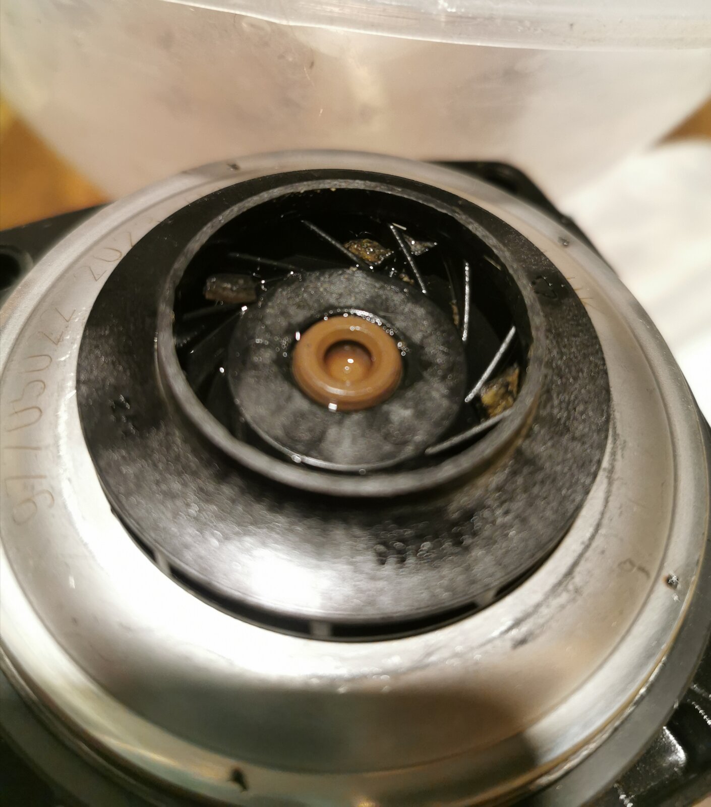

Look what i found inside the ups3
It doesn't say much for the flushing out or whatever is supposed to be done after that proper power flush, is that stuff in the impeller hard or soft?.
Hard bits. Poweflush was done in Oct with old ups3. I was present water was crystal clear. Even bleeding rads water is clear.
Water from ups3 today was light yellow.
The magna clean was full. This is first time i opened it since fitted in Oct.
I will check it daily from now on.
Is there anything I can add to the system that would break down hard sludge / magnite in system?
