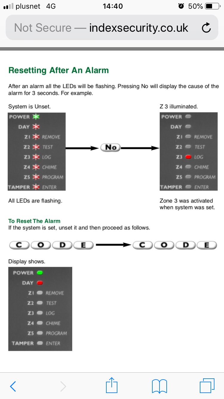

    hi my guardtec 350 house alarm control panel goes off when the alarm isn't set - any ideas why pls

    Flashing lights and the noise of the control box. Alarm wasn't set or anything.

    Classic ! ...they don’t print a icon or a word at the side of every led on on the panel for nothing ....

    Sparkymark there are no words on the display panel just numbers and like I said they are all flashing

    Thankyou we keep doing this / had to do the reset 5 times last night and about 10 times since 7 this morning - don't understand why it's doing it

    Jesus ...as above what light comes on ....my guess tamper

    Yes the tamper light

    So it could be one of many problems ....bellbox, detectors, panel lid ...battery ect ect
