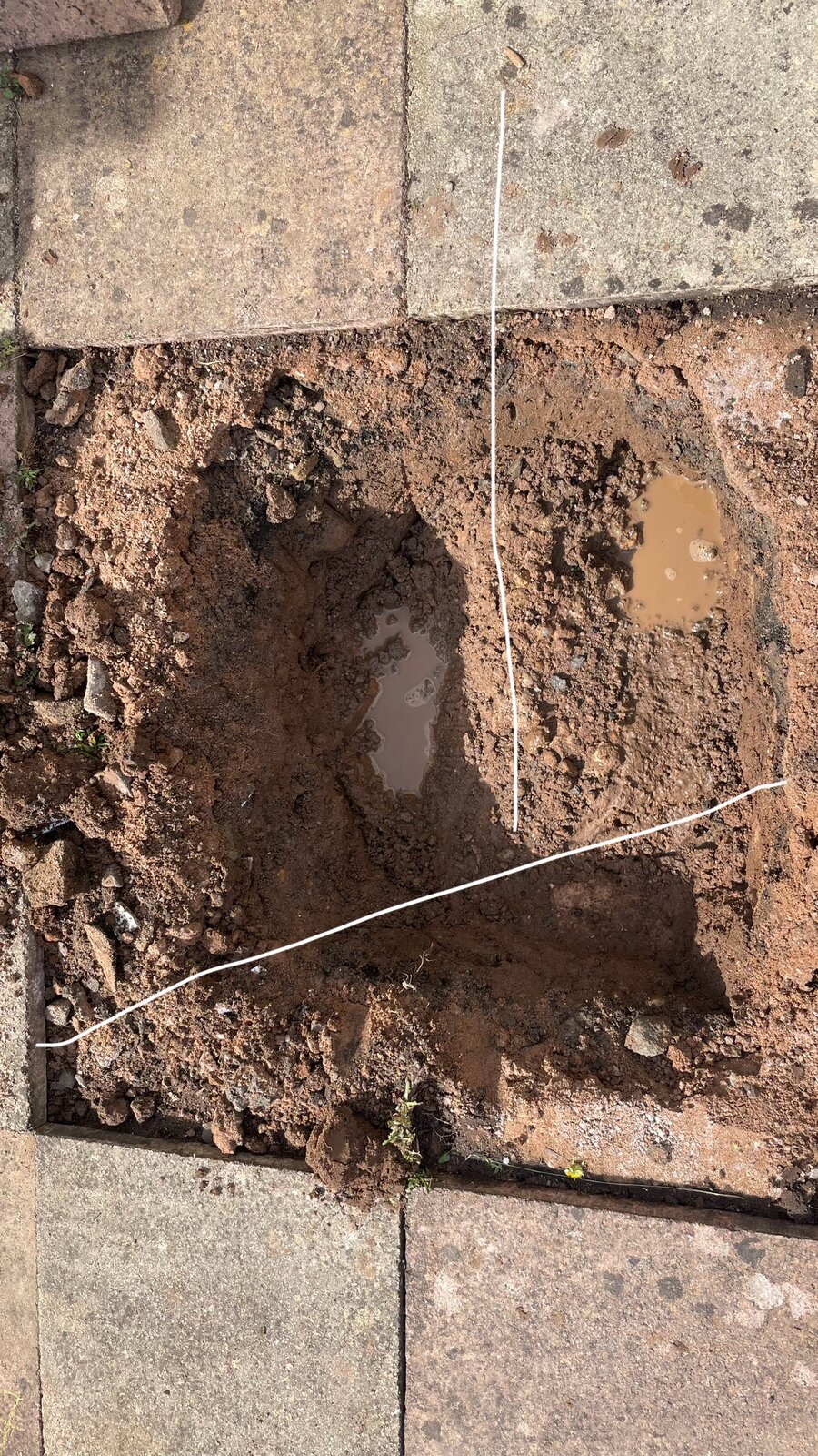

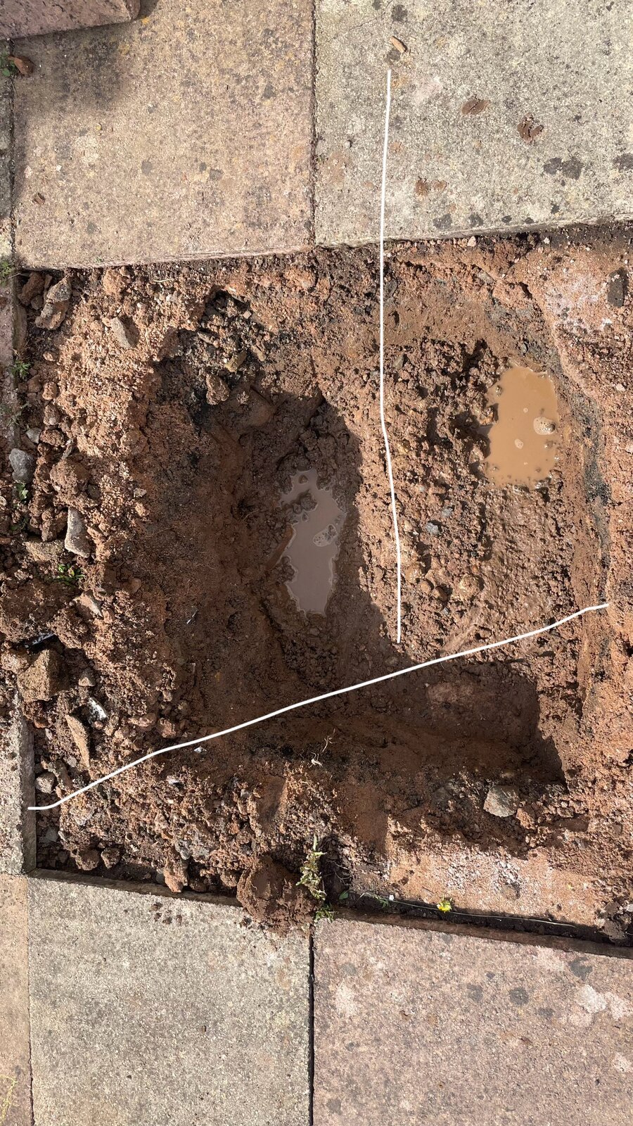

Sorry for resurrecting this but I still haven’t made up my mind. I dig a hole in the patio to see where my pipe joined the common sewer and I found the pipe is covered with concrete.
If I remove the gully and the pipe is also covered in concrete, how do I connect to it?
