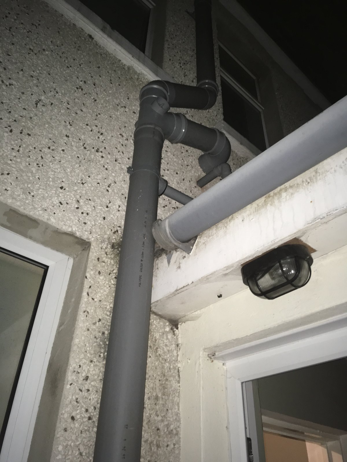

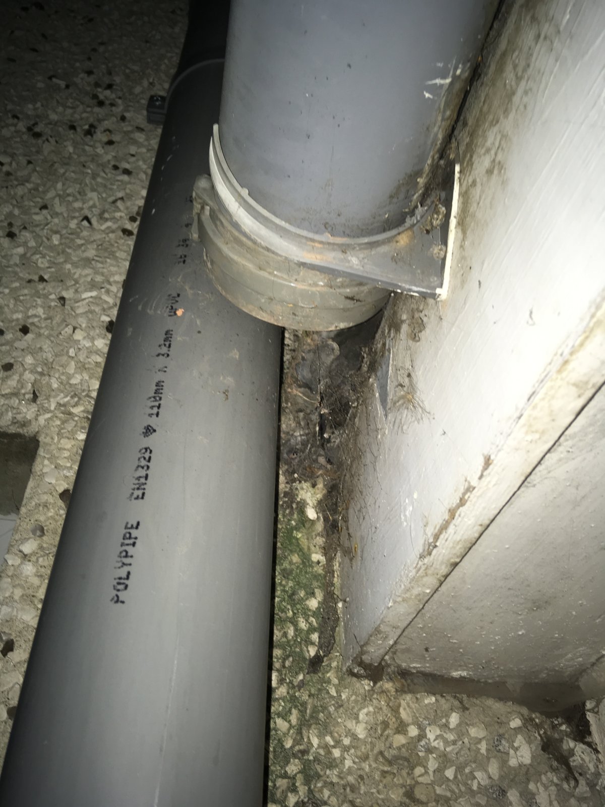

i had my bathroom moved upstairs recently and as a result the soil pipe was moved beside the guttering meaning the gutter had to be cut at the end and is now not flush with the wall and as a result when it rains, water come dropping down the wall and is starting to discolour it. Is there a remedy for this? Thanks in advance.

Slip a piece of lead under the tiles above the soil pipe to divert the water into the gutter.

18x12" piece of lead...slide it under the tiles above the pipe where the gutter has been removed bend it up and slant it down towards the gutter so the water runs down the roof and the lead diverts it into the gutter instead of running down behind the svp.

“ Yes that's slate, I'd say your looking £150 for the lead cut off and labour“
Does that seem a fair price?
It needs to pick up the water from the soaker as well which isn't always easy. still should take any longer than 2 hours to do the works.
