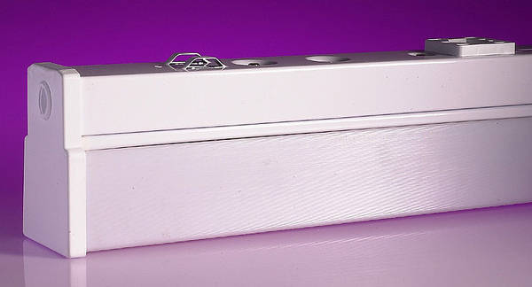

A TRS gland would be good at the fitting, but the two monkey puzzle clips you show fit into the 20mm knockouts, so most people just enter this same hole with the flex.
So, I was correct in my fitting explanation?
On that image, you can see two strips of raised metal, would they be for those monkey clips instead of the knockouts?

Those raised metal bits are simply spacers, the monkey puzzle clips you show fit into the 20mm hole of the fitting, pressing into the hole from inside.
There is a white plastic spacer attached to the fitting in your picture which unclips for this purpose.

Those strips are spacers. They allow the fitting to be mounted onto a normally combustible ceiling without toasting it.
Yeah, I'd go with Lectrician using a rose. Cheaper, easier and less hassle. The other solns, while not wrong, seem a bit of overkill.
If you are taking the flex through the same hole as the monkey puzzle, use a 25mm grommet so the flex cannot chafe on the fitting body.
Think you meant 20mm :D Flourescents have the standard besa fixings with 20mm holes.
All the fittings I have suspended, I have used the larger hole for the monkey puzzle which requires a 25mm grommet. The centre hole is usually 20mm....
