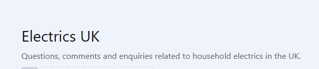

Here IN EUROPE we use 13A plugs containing fuses. And this forum is called
You are worrying about it unnecessarily.
However relevant it may seem, offering advice irrelevant to the title of the forum and the location of the equipment and based on another countries rules and regulations is rather futile.
For example here in Europe we drive on the left but I would not advise drivers in another country to drive according to our rules and laws.
