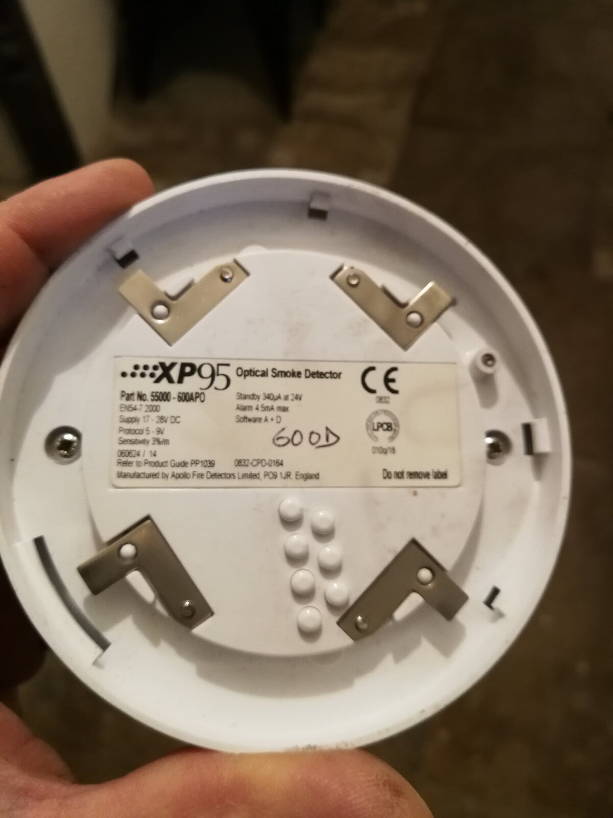

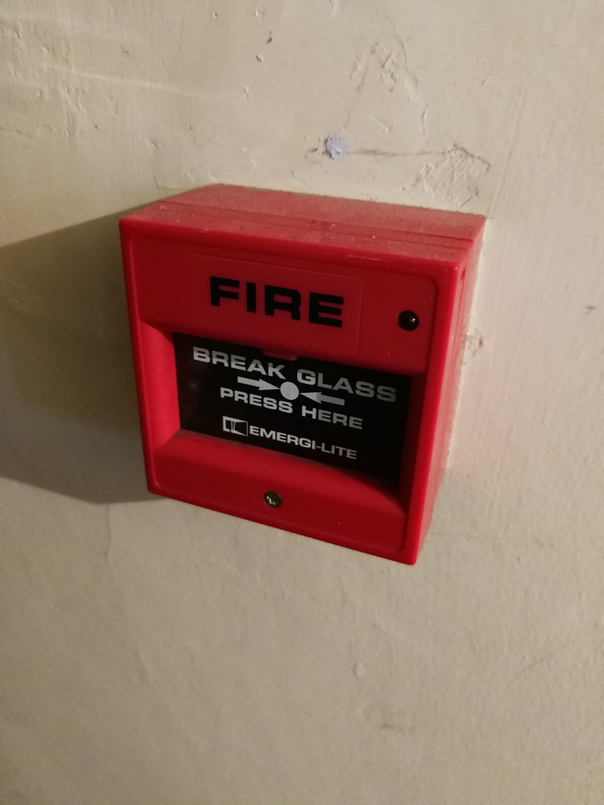

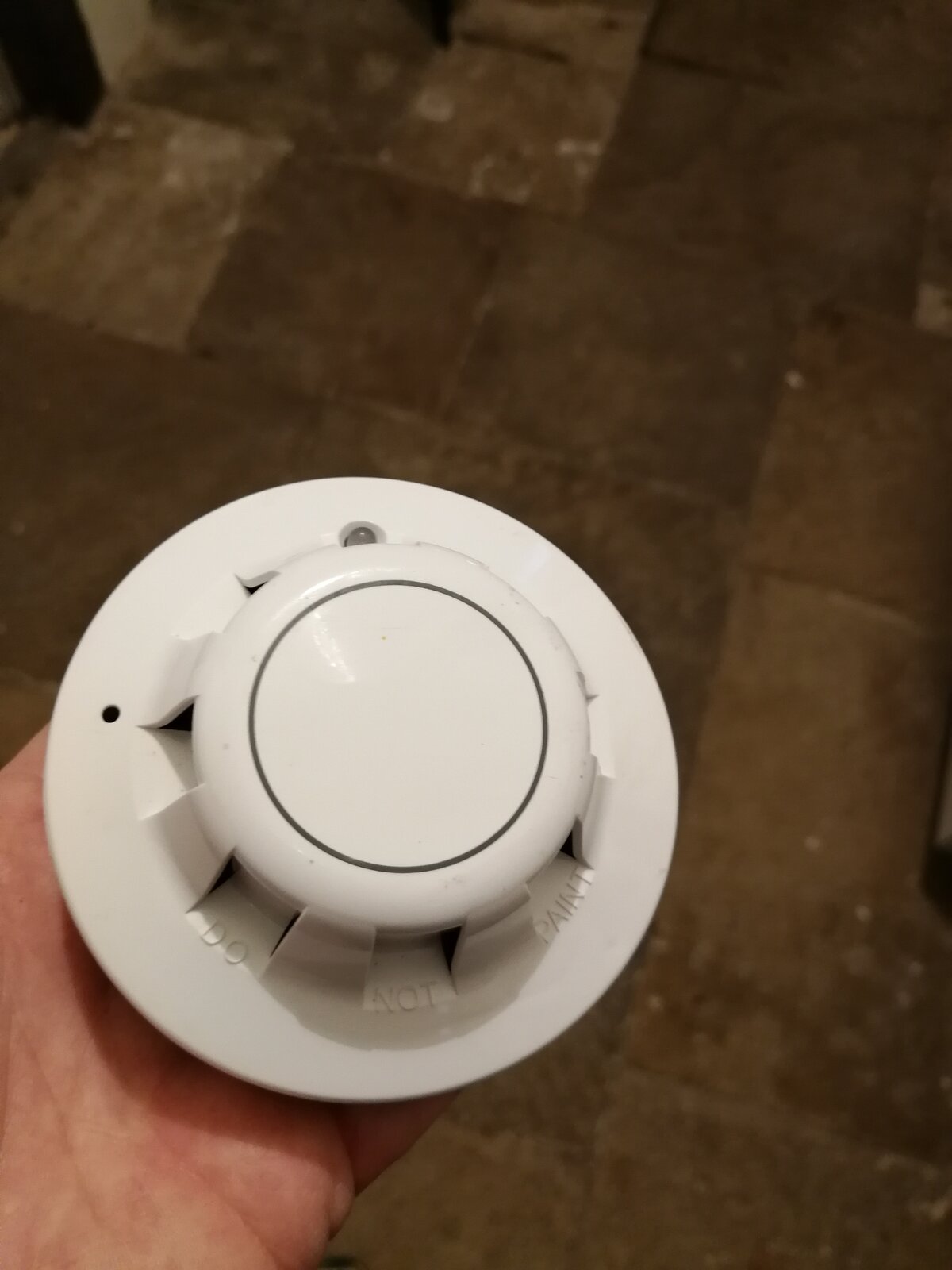

I don't know much about Morley fire panels but post a photo of the type of smoke detectors it may give a clue if or not they would be compatible with a different type of fire panel.
I will post a photo of the devices on monday.
The property is grade 1 listed, has 7 rented flats, a staff area, and an area which opens to the public.
Are you getting false fire activations? Or is it just the double address faults you are having issues with? My gut feeling would be to employ a different company specialising in fire alarm systems to sort this out. It sounds like you may have employed a "part swapper" at the moment who's simply chucking new devices at the system in the hope that it'll solve the issue. A common problem with systems running Apollo equipment giving double address faults is the smoke/heat detectors not sitting in their mounting bases correctly, causing the address switches on the detector to make a poor/intermittent connection with the pips on the address card.
I also had a fault last week where the address DIP switches on a manual call point hadn't been switched over properly on the original install 3 years ago which caused a double address/device missing fault. Working the switches back and forth a few times solved the problem. It could also be down to a faulty device or (less likely unless there are other faults displayed) problems with the field wiring (earth fault/water ingress) causing corruption on the loop. It's not likely to be an issue with the control equipment, though if you did want to look at replacing this, the Advanced MXPro 4/5 would definitely be my choice as a replacement. Rock solid panels and very easy to use. This would depend on your existing field devices though, as not all would be compatible
These devices are the same as those on the system.

Your second pic shows an XP95 sensor head. The row of 4 & row of 3 'pips' that you can see 'read' an address strip that is placed in the base. These strips have matching knockouts that press (or not) the pips in when the sensor is fitted on the base.
Sometimes these unintentionally break off causing the sensor head to be set to the wrong address. This is a common cause of double addressing. It can be a bugger to find. It happened in the middle of the night with our system at work - the sensor head causing it was, of course, in one of the most inaccessible places!
