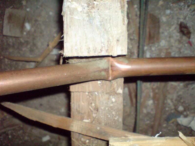

I lifted a board in the bathroom. Unfortunately, a pipe was glued, yes glued to the underside of it.... :roll:
Now the pipe is sitting at a 45 degree angle to horizontal, sporting a nasty "I'm going to leak any minute" kink.
It's the cold pipe, so I can easily isolate at the main cock. However, for a spark of 25 years, with no plumbing experience whatsoever, do you think you I could cut and cap off the pipe without flooding the place?
If so, what parts and materials am I best endowing myself with?
Could I get away with just buying a pipe cutter and a plastic push fit stop end?
The hot is OK, but would like to do away with a piece sticking up above floorboard level.
How do you isolate the hot?
Is pushfit reliable on hot pipes or do you need a compression fitting?
I am donning the helmet now, as I can see it coming as I type....... :wink:
Thanks!!
EDIT: Uh-oh, I've just had a nasty thought. What if it's tank fed cold? Is that likely, or will it be mains? It's the old feed to the basin, which is tapped off the pipe feeding the cistern & the bath too.

See piccy below. The stressed bit is the lighter spot at the bottom.

looking at that, you will need to cut damaged area out, they may not be enough tolerance in the pipe for a single joint as the pipe work will shorten after cut/cuts.
So you may need to repair with short length of pipe and two joints, one either side of joist. if you do manage to get a joint at the notch, you may also have to deepen the notch to allow for fitting.
Have a few towels, rags sponges, mop etc.. handy and a bucket.
You can get pushfit, compression and soldered caps.
Like I have mentioned I prefer soldered joints in areas that are not easily accessible. I am sure there is/was some requirement regarding this?
Also if you do solder and it's potable/drinking water best use lead free joints/solder.
Solder if you can, compression i you can't and pushfit to get you over the weekend..... Seriously, never fit any pushfit fitting where there will be no access in the future....

I don't need to replace any pipe, the bent pipe you see is now redundant and I can just cap it off temporarily.
I appreciate what you say that a soldered joint is the most permanent of the options.
Eventually when the bathroom refit is complete, the pipework will be removed, and any joints will be soldered but for now, a compression stopend will suffice.
Fixed, at least for the time being!
Cheers, peeps.
Capped off the kinked pipe and managed to gently bend the other one (HW) down slightly so it was below board level.
No weeping so far, either from me, Mrs Secure or the joint!
