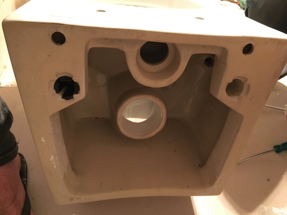

Fix bolts - place plastic bush with captive finger into hole from inside the pan.
Then the fun begins, you have to align the soil the flush pipe and the two bolts into the two captive held plastic bush, these also have to insure they don't misalign the allen screw with the hole so you can tighten them.

pic for a section of fixing View media item 31360

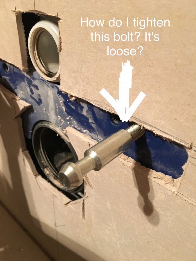

Hi,
i've recently bought a cistern and having a slightly different issue. The bolts that screw into the frame are a little loose, are they supposed to be loose? i've been trying to fix the pan back but concerned its not going to be secure.

Do you mean there is a captive nut fixed to the frame and the bolt wobbles as it screws in ? a picture would help;)

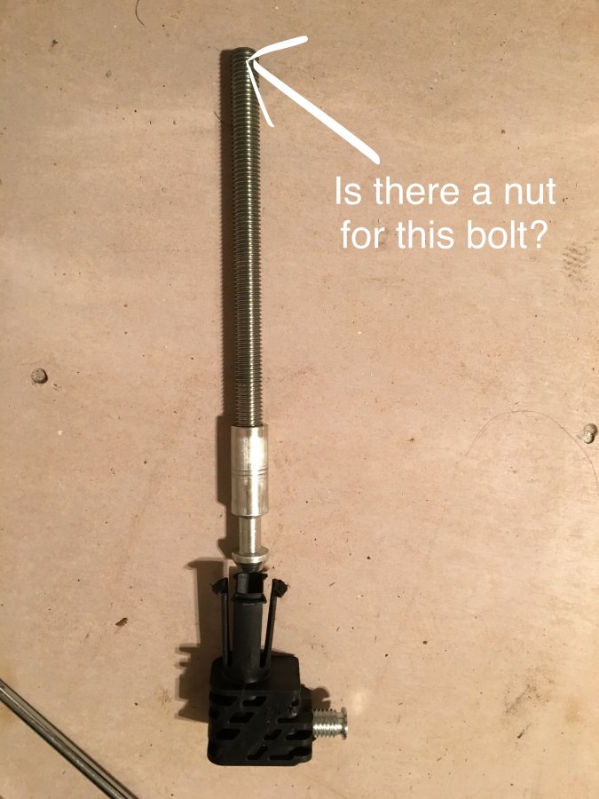

No there is a threaded rod per below photo, but when its screwed into the frame, its loose. Should it have a locking nut before the pan is installed?
Getting the pan onto the thread is not easy as discussed above, but i'm wondering it the thread is a little loose, how secure is it going to be? Will the cam lock / connector really be enough if the rod is loose?
Sorry can't see a photo - but generally a coarse thread will be looser than a fine one - but will be stronger against pulling forces and easier to get a nut started on

AGAS sorry i originally uploaded the pics to the media section and put links to these in the thread above, sounds like the links didn't work, but they did for me? anyhoo i've stitched them into the reply this time. Sorry haven't used forums before.
And just to clarify, its the threaded bolt thats loose in the frame that i'm concerned about. Installing the pan onto the bolts is obvious, although it's proving difficult as the plastic locking mechanism pushes out of the pan too easily, and i'm not sure that a cam lock connection will pull the pan firmly against the tile. Doesn't seem a great design?
