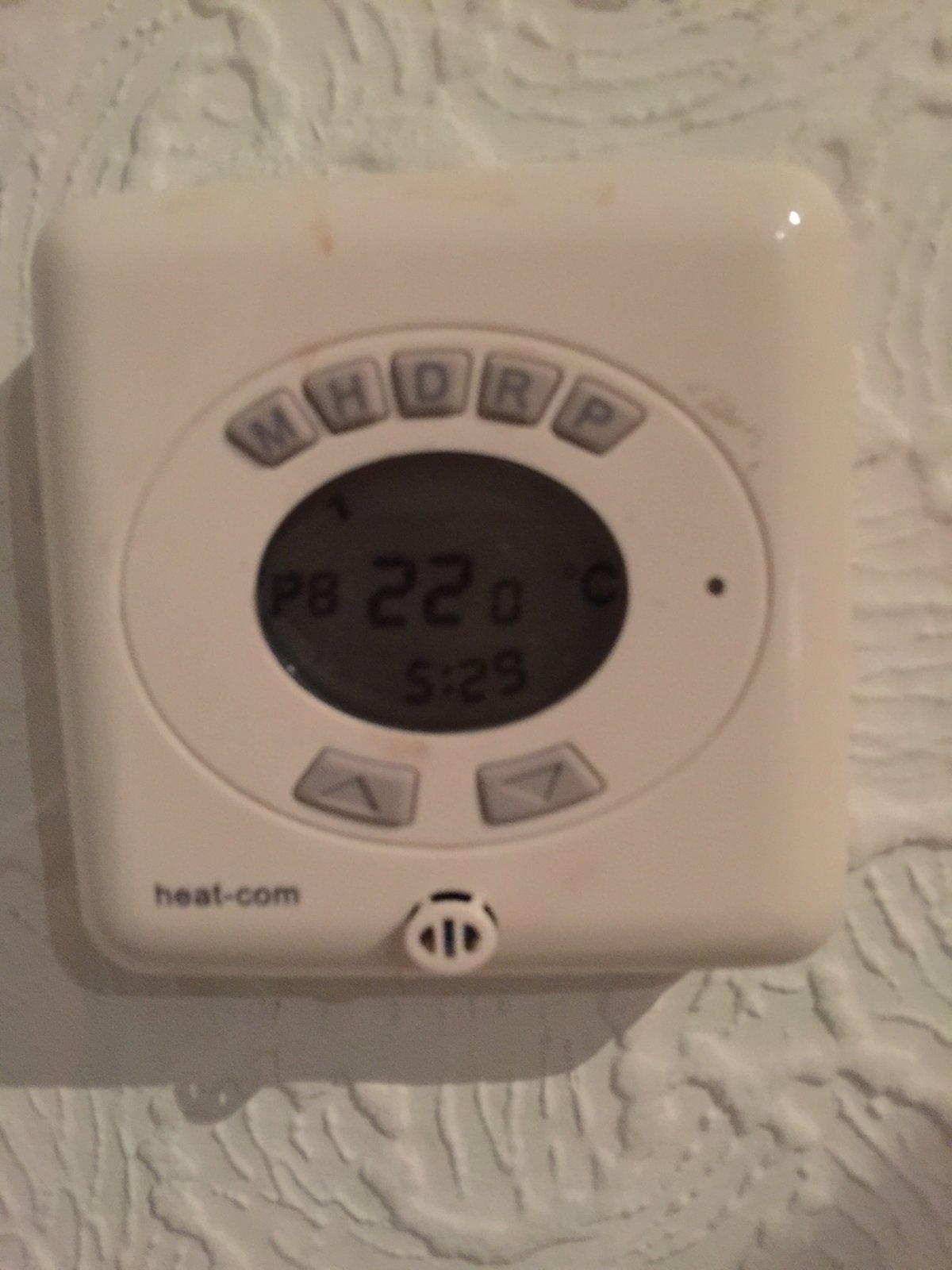

Hi All,
Don't know whether I've posted this in the Right Section or not, but here it goes....
Daughter has recently moved into a New Rental Property & has found that she has Underfloor heating in the Kitchen....She Can't seem to Control the Settings Using the Controller mounted on the Wall, It seems to be on All the time, which will obviously affect her Bills!!!!!
Does anyone recognise the Controller? All it says is heat-com & Nothing Else, Don't even know whether it's a Mat or Pipes......
Would it have a Separate Feed from the CU or be Spured?
So If anyone has any idea on the Model Number or can point us in the direction of an Online Manual or can give some clues on how to Switch it Off or Change the Settings, it would be appreciated....

Thanks for Your Reply....She has asked her Landlord, Who says that the Underfloor heating was Installed by one of the Previous Tenants, with his Consent & He has No Idea where the Instructions are.....A Google Search Doesn't bring any Joy Either....No Comparable Images of the Controller, If I could just find what Model it is, at least that's a Start......Currently it is on 24/7 Which may cost her a small Fortune.....
Could be either. Are there any other switches nearby, in a cupboard, other side of the wall, etc.?
If not, turning off the circuit breakers in the consumer unit one at a time will at least indicate which circuit it is connected to.

Just to let you know....I contacted "heat-com", which is now heatcom & is based in Denmark...The sales department sent me an installation & user guide for the thermostat, which is an atria.....I have forwarded the manual onto my daughter, so hopefully she can now disable the heating temporarily.....
