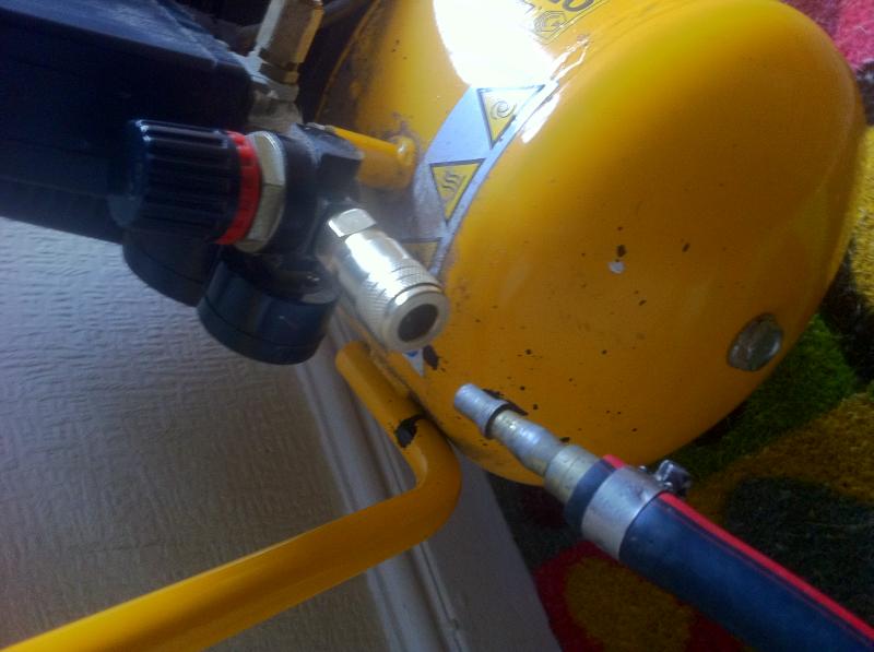

I have just got hold of a 24 litre JCB compressor - model AC24. I have been having a nightmare getting it all connected.
Am I missing a part - should all air compressors have a hose tap?
Or there is every chance I am just doing it wrong - never used one of these before so any advice appreciated! Photos of all the parts I have are below.
Thanks,
Maria
The 'tap' is the regulator knob on top that controls the air flow to the outlet.
You appear to have a quick release connector, two quick release hoses and a threaded hose and something else. The QR connector screws into the silver hex outlet or you can screw the threaded hose in direct. Most people these days would use quick release fittings. They push in and you pull the collar back and pull to release.

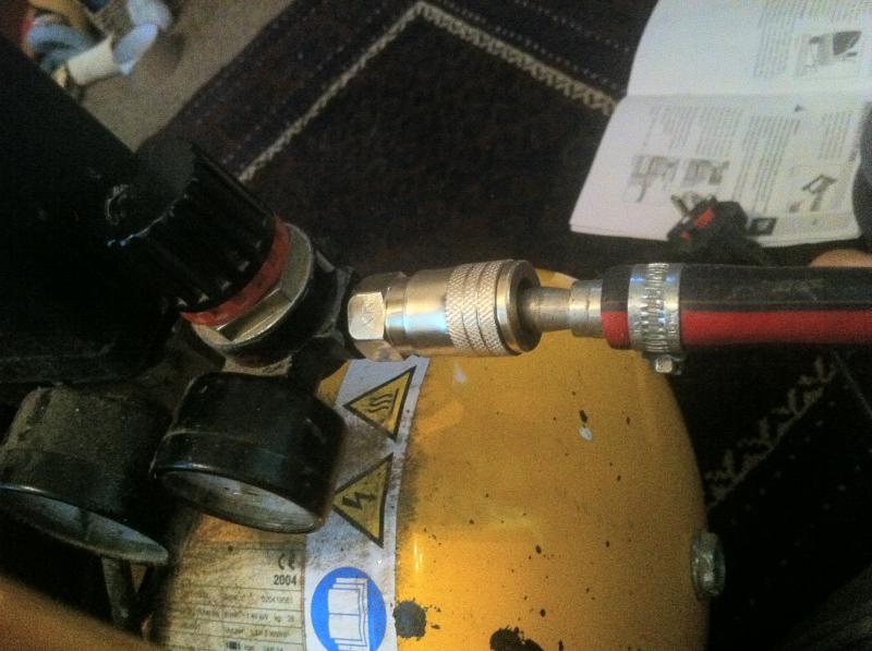

I have connected the parts as suggested (I hope) , but the problem I am then faced with is that the hose will not click into the quick release.
What am I doing wrong now?
Thanks a lot for the help.
Maria
They can need quite a firm push to connect or maybe even pull back the collar to help the bayonet enter the fitting. There is also the possibility that the bayonet and connector are not quite compatible. I seem to recall there being 2 different versions - one bayonet fitting being shorter and therefore will not connect - but cannot be entirely sure about that. It's a long time since I set mine up. :confused:
Yep. Try both. Firm push with the collar pulled partly back. You will hear a click when you've got it. Make sure there is no pressure when connecting or disconnecting.

I've got it in with the push as suggested, but there does seem to be a lot of movement. I can't get it back out, so it is locked in, but wobbles from side to side.
Is this actually air tight and ready to turn on?

You'll soon know if it isn't air-tight as you will hear the air hissing out of the connector. Nothing will blow up as there is a compressor will have a preset limit, and anyway if it's leaking it will never reach maximum pressure.
Turn it on and see what happens.

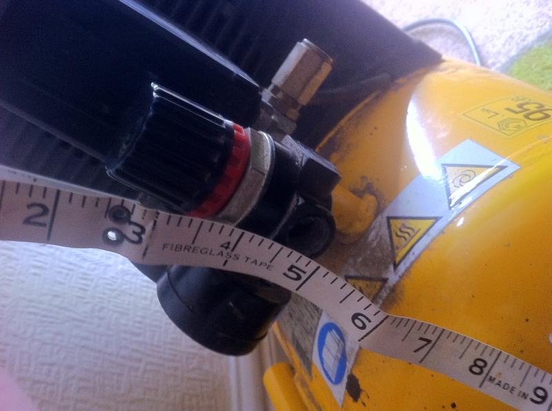

The two common connectors are PCL and NPT....the males on yours are definitely PCL but we cant see the female connector. However, they aren't compatible so if they mate together they are both PCL.

I think the connector is wrong, it doesn't fit right so I'm off to Machine Mart to buy a spare.

You may need ptfe tape and sealant around any threaded items......

Success! Got everything working today with the right parts in place.
