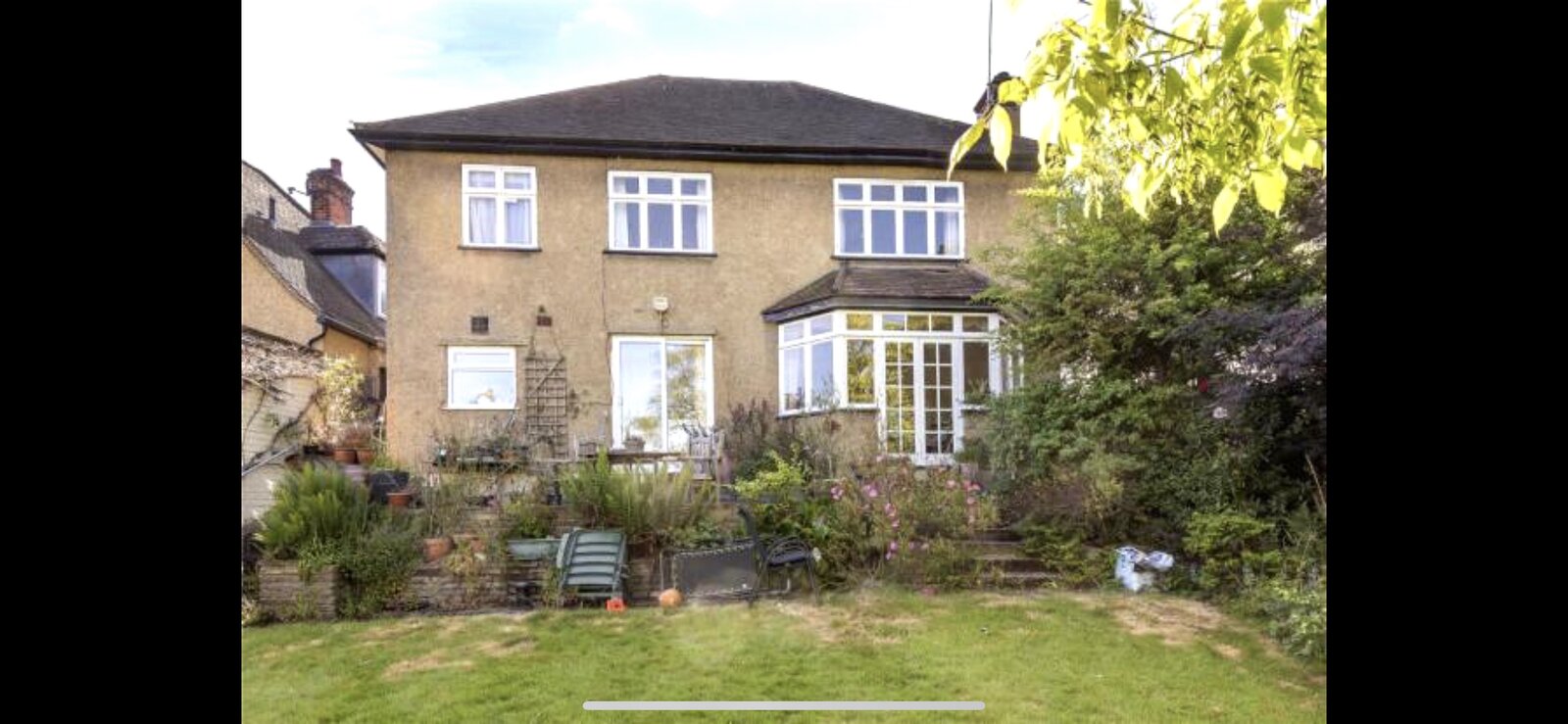

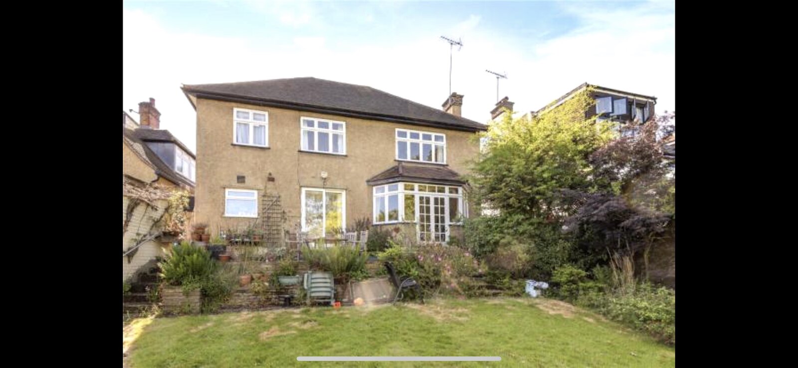

Hello All,
I am trying to understand the rules regarding the 4m ceiling height ruling for a single storey rear extension. The problem i face is that the house is on a downward hill so there is a drop of about 900mm from the patio (3m) to garden.
We are trying to submit planning permission to build a 6m single storey rear extension and am struggling to figure out the best way to do it.
Ideally would like to have flat roof and then basically have some steps coming down into the garden.
Is the 4m from the back of existing house? Or back of new extension?
My garden slopes down and to the left. So can i measure from the highest point? Or lowest point?
Have added a picture of the back of the house for reference. Basically the raised patio is about 3m and we would eat an additional 3m into existing garden space.
Any advice/help would be much appreciated.

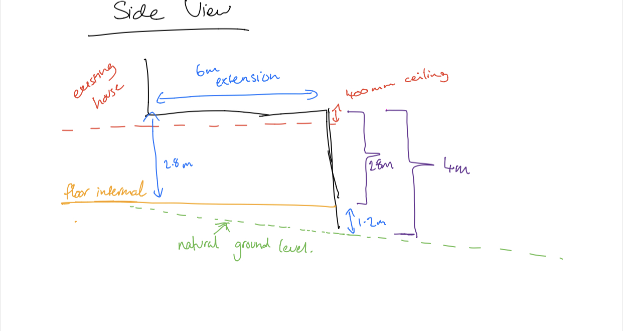

ok thank you. I think I know what you are saying now.. I have had the following feedback from one of the architects which seems to contradict my thinking....
The first is the fact that you have a large drop. The 4m height is definitely taken from the natural ground level at the further point of the extension.
The second issue is that, under permitted development/prior approval process, any rear projections on the back of the existing house will have an impact on how the local authority calculates the depth of the extension. For example, on the rear of the property there is already an original projecting bay window, which forms part of the original rear of the house. Because of this, you would not be able to build a 6m extension (this is a grey area and a technicality, which can be found on the permitted development technical guidance).

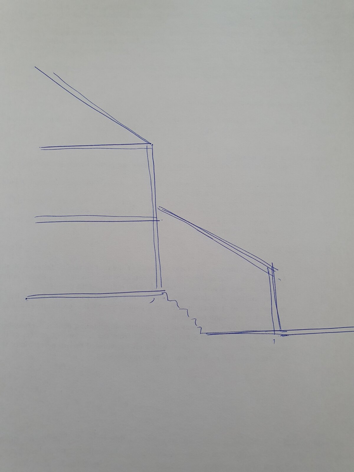

Ultimately, given the site conditions and the fact that there is the rear bay projection which forms part of the original rear wall, my belief is that you will have to submit a householder planning application for the applications to the house. I do not believe you will be allowed to build out by 6m, however, you would have a good chance with a 4m rear extension. The extension would have to be stepped lower down, which means you will have steps internally leading into the extension. Please find attached a little sketch, FYI.
The only way of knowing what you can do is to have a pre-app meeting with a planning officer or just to submit an application and try your luck.
I've had a long look around the area and I cannot see any extensions which are 6m deep. The majority are 3-4m in depth."
he also sent the following diagram as a proposal:
I am not sure I agree with him. Would be good to hear your thoughts on this... Was really hoping for a 6m extension! The neighbour has a 4m single storey and 6m basement extension below the single storey!

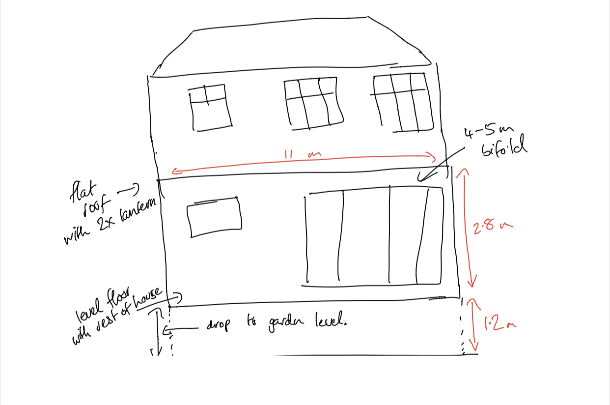

Thank you. I imagine the following proposal should be achievable? Subject the ruling about the dormer. See pics.
hopefully I have interpreted everything correctly.

Apart from the 4m would be where your first 2.8m dimension is. But you should ignore the PD rules if your extension is to cover the bay window.
Ah ok,
So I would start off with 4m and then end with approx 5.2m at the back of the extension. As you said, the 4m is counted from highest adjacent land which would be the back of the current house.
So what the is the best way to go forward, the architect seems certain the 6m will be refused. Im not too familiar with PD/non-pD. Would appreciate some advice and guidance on how to proceed!

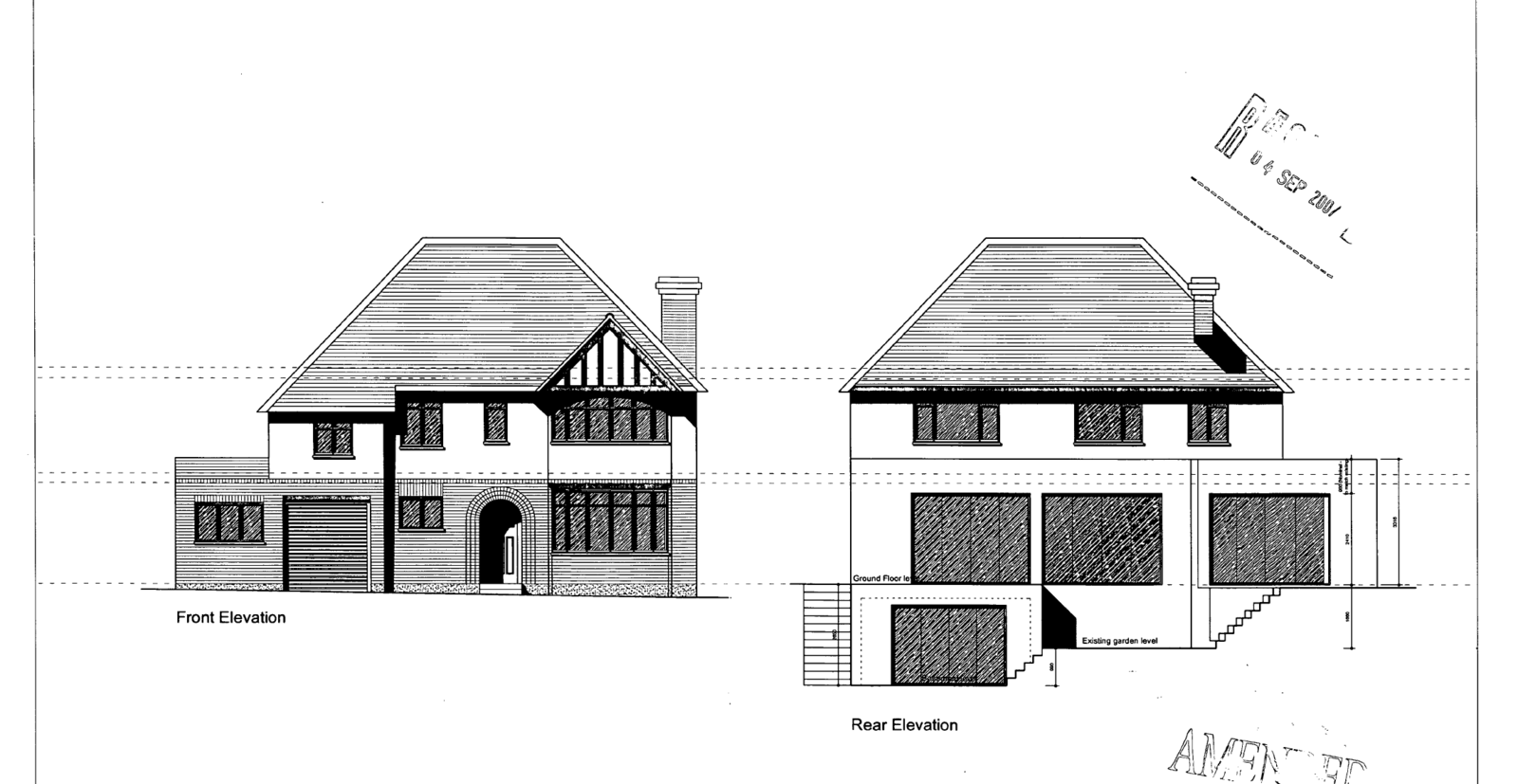

Additionally, looking at the neighbour, they have a 4m back extension single storey and then a 6m basement below the single storey extension which protrudes more than the single storey. See attached.
Am hoping that because the neighbours have had this approved since 2007, we can push for our normal 6m.
Correct.
You would not be able to utilise PD due to the presence of the existing rear bay. So any extensions to the rear would require PP.

Your only option is to submit a formal application of which the design is to meet Local Plan policies and design guidance. The fact the neighbour has already extended will help go in your favour. No point talking about the PD rules anymore as they would not apply to you.
