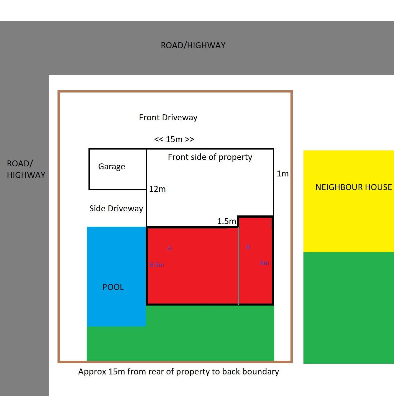

See attached.
A is neighbour consultation scheme rear ext
B is neighbour consultation scheme side ext

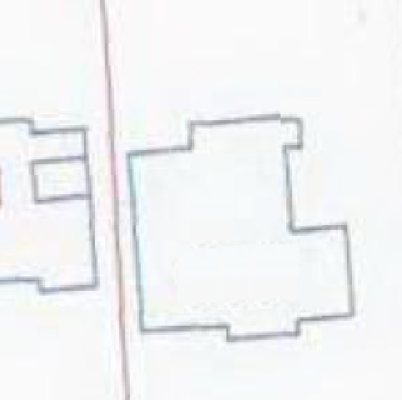

On your drawn plan, the back wall of the house appears to be in one plane, while the satellite pic shows a projection. If that is the case, you cannot extend fully across the back to any depth without planning permission. The 8m rule would not apply because it would not be permitted development.
You could extend on the projecting part by 4m (or 8m if you use the consultation scheme), but any extension of the wider part would not be PD because of the short projection.
It would help get more meaningful responses/explanations if you could post a pic of the back of the house.
See attached.
there was a storage built on the side of the rear - I will be hopefully removing this for a side extension at a later date and therefore have not included it in my plans for the rear extension.

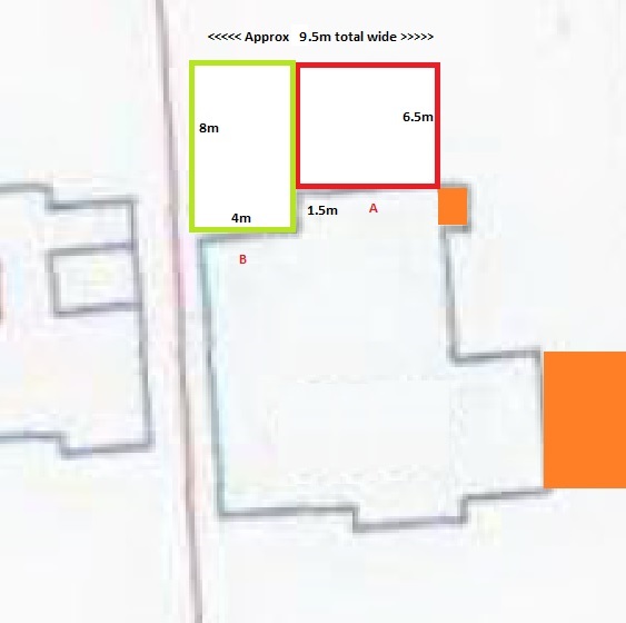

Image 1 - Map
Image 2 - the Orange filled area's are what has been added to the property. A side storage room and an additional garage at the front.
I have highlighted the 2 area's in Red (A) and Green (B).
Hope the images clarify the point I am attempting to make, that this should be classed under permitted dev?

Just submit one planning application for what you want to build in my opinion.
I shall be.
I want to go 9.5m from the back "side wall". This will give me the 9.5mx9.5m that I ideally would require. This will be full planning application. Along with this I will add on to the application the side extension (facing highway so this has to go via full planning regardless).
My questions earlier was as a fall back if I do not get the 9.5x9.5. In your opinion(s) am I correct in thinking I can/will get the 8m x 9.5 permitted dev by applying for the 2 - rear and side ext on a permitted plan?

Im still waiting to hear back from the council PO... but it looks like il be putting in plans for full planning permission.
Had a brief discussion with PO.
Have been told that for permitted Dev i could apply for a side and rear however i will be required to keep a gap in between?! So i guess that option is out the window.
Ahead with full planning ….
