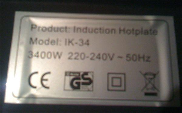

Help identify this two pin plug ?
To the OP, if you can upload a picture of the rating plate (probably on the back of the appliance) it may reveal more.
If the appliance is double insulated then I'd be inclinded to cut of the shucho and fit a standad BS1362 british plug.
Adaptors are never going to provide as good a connection as this, and sloppy connections and high powered appliances don't go together too well.
Here it is, in all it's blurred glory.
I would prefer to have the plug changed to a UK plug. Have emailed them and asked if it will invalidate the warranty. I don't really want to invalidate the warranty, but, to be fair, I'd rather risk invalidating the warranty than risk a dodgy adapter invalidating me !

Looked at the manual - and no mention there of anything but 3400W.

Its 3400 watts at standard UK voltage. I cannot justify plugging it into a 13 amp socket.
Its a 15 amp appliance. Fine with a 16 amp schuko socket, but not with a 13 amp socket. IMO its not fit for use in the UK as a portable, plug in appliance, and should not be marketed as such. Sorry. Others may have differing opinions.
Agreed - it cannot be plugged into a 13a socket. Indeed, in my opinion its on the edge for a continental schuko plug and socket, as supplied. The only domestic plug and socket arrangement I'd be happy seeing it plugged into here would be a BS546 15a (old style large round pin British sockets), but there's not many of those around any more.
To be absolutely honest, I think you should engage the services of an electrician to make a safe connection with this appliance. What they've supplied you with is pitifully inadequate with regard to the small British plug adaptor they've given you with it - its just not safe.
Steve is, technically speaking, quite correct - however in the real world I don't think you'll have a problem. Taking 235v to be the average in the UK you have an appliance running at 14.5A. As I would not expect this to be used for sustained periods I really can't see it blowing a 13A fuse. I would however advise two things, firstly that you do cut the cord and wire it directly to a UK plug fused at 13A - as you're marginally over current anyway the idea of introducing unneccessary mechanical connections does not sit easily. Also (at the risk of kicking off a long-debated subject on here) remember that a double socket is rated at 13A total for both sides so although I would expect it to sustain 14.5A indefinitely, I would certainly advice against using anything else in the other side of the socket at the same time.

The appliance will draw the same amount of current here or in europe.
The supply will try to deliver as many amps as the appliance demands, it will not limit the current to 13A...the appliance could try and draw 100A from the supply and the supply would give it 100A...until the fuse blew.
This ebay seller is either naive or is trying to pull a fast one...I wonder how many more of these he has sold to UK buyers.
