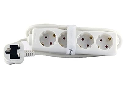

An extension lead is what I used as shown here but I did not pay that for one
mine looks just the same bought it in Turkey on holiday and cut it in half and fitted 4 UK sockets to the plug and UK plug to the sockets.
