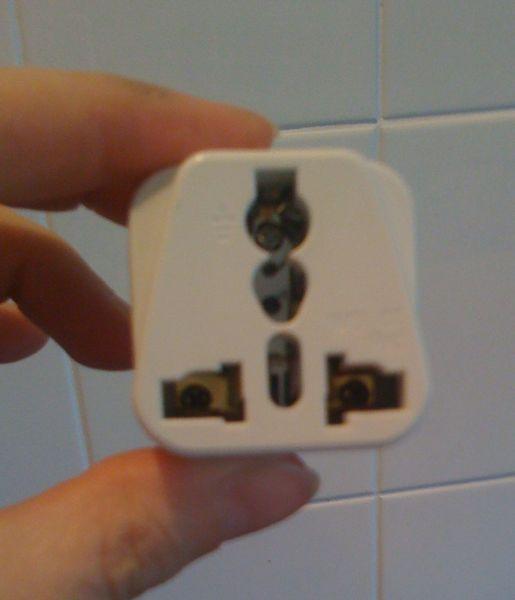

Hi folks,
I bought a twin zone induction hob from a German company called Zaxx. It was described as having a european plug fitted but would come with a UK adapter. I made sure to email the company and ask if this could be plugged into a standard 13A socket to be absolutely certain, and I was assured it could. This is the item in question.
http://cgi.ebay.co.uk/ws/eBayISAPI.dll?ViewItem&Item=200260281106&Category=71247&_trksid=p3907.m29
It arrived today all hunkey dorey.
However, the style of plug plus the adapter they sent means the whole plug assembly sticks out of the wall socket by about three inches, which is nasty and unsightly and gets in the way. So I am hoping to get one of those clamp in adapters I have seen on the net,
(like this for example http://www.powerconnections.co.uk/convert_eurotouk_scp.htm

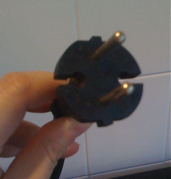

but the problem is, I don't know what sort of plug this is. A look on wikipedia makes me think it is either a Schuko plug or a CEE 7/17 (if there is any difference, I dunno). Or perhaps a Europlug ? It's all greek (or european shall we say) to me !
So here I submit some pictures, taken by a woman with shakey hands and very poor eyesight and no knowledge of european plugs whatsoever, in the hope that someone can nail the identification of said plug and tell me where I might get an adapter that clips the plug safely in, and causes the cable to come out of the adapter downwards, as opposed to sticking out like a venus on a bunrock (as my nan used to say).
My dad has suggested rewiring the plug to a UK one but I suspect that would void my warranty, which I don't want to do.
Thankyou for your patience !
Adapter, and plug;

It has no provision for earthing your new hob, and I doubt that its double insulated, which is a requirement for unearthed appliances (I cant tell if the hob's plug has a brass contact in the earth lugs on each side)
And the adaptor also appears not to be fused? Correct me if I'm wrong. Again, another non-compliance.
That plug looks to me like a CEE 7/17, powerconnections reffer to this as "unearthed schuko" (which is a self contradictory name). The converter plug you have linked to is the right one. Unfortunately thier converter plugs can be a little tricky/expensive to get hold of in small quantities.

Never realised it was a freestanding unit. My George foreman grill came with a power connections plug already attached to the schuko. It had been done en-mass for a cheap bulk import to the UK.
Being freestanding it probably is double insulated since it will have a plastic base etc. Normal hobs have a metal base and this is what my earlier advice was based on.

Yes. They are all pretty much the same shape, but some countries have different variations. Spain has earth contacts at the top and bottom, the plug itself being totally round.
France and (it appears) Germany have the plug you see there, where their sockets have an earth pin that sticks out from the socket and goes into one of the slots on the plug. An earthed plug is a lot bigger, since it has to have a receptacle for the earth pin, whereas on yours the earth pin would stick through the plug and just be left exposed.
There should be a little plate on the appliance somewhere with the specification - wattage and hopefully a little symbol with a square inside another square with means class II (not needing an earth).

On the hob's plastic under belly there is the double square symbol of which you speak. Result ! Ta for that tip. And a CE mark and a GS mark fwiw.
Soooo, I am looking for an SCP adapter, the non earthed type. Would it be one like this ? http://www.euronetwork.co.uk/acatalog/Euro_to_UK.html
6th one down, Schuko Converter Plug - No Earth (SCP)
