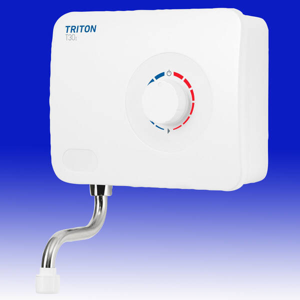

What about adding a water heater?
The other half just does not want HW.
So I’m happy. Lol.
