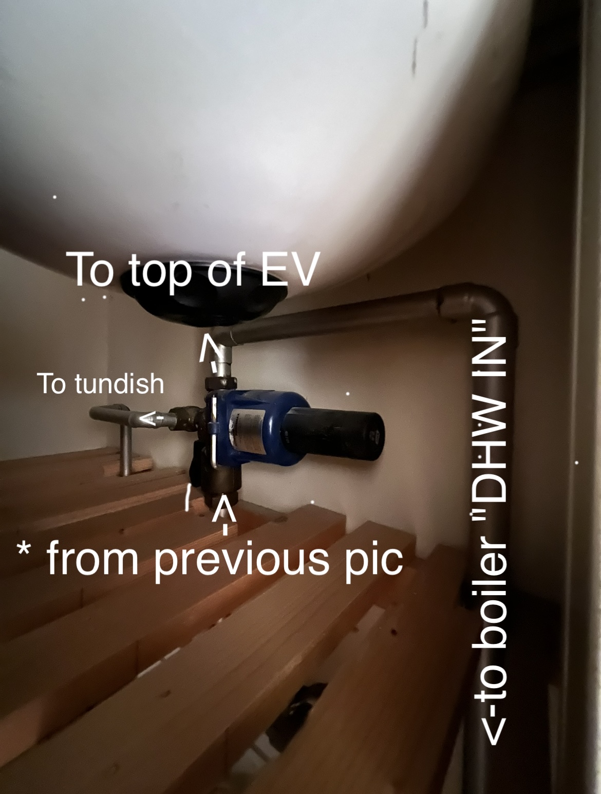

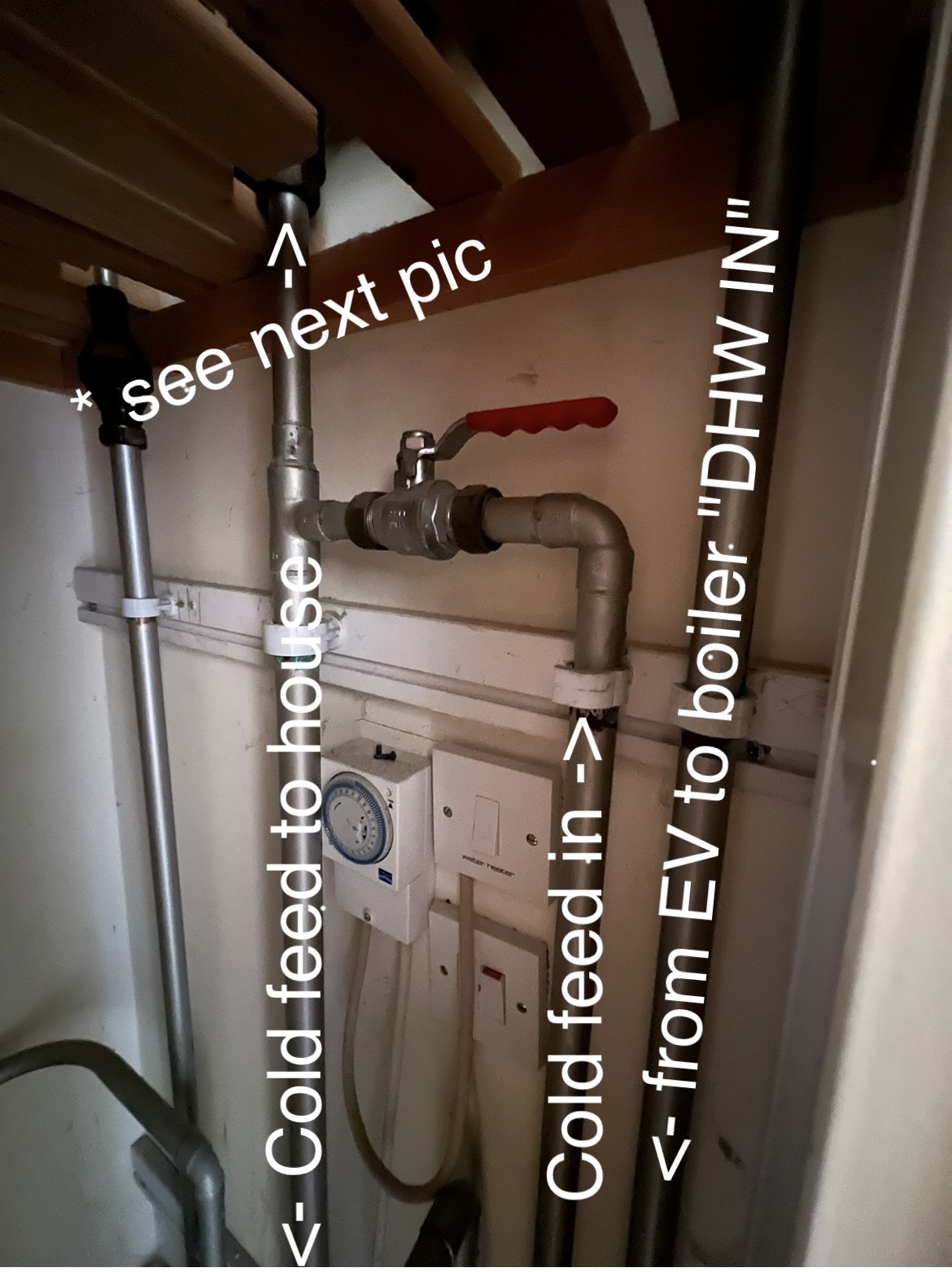

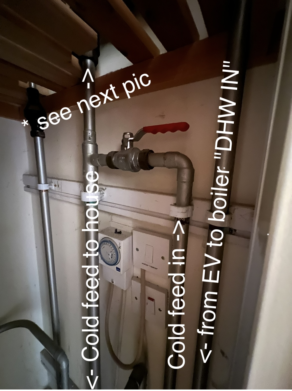

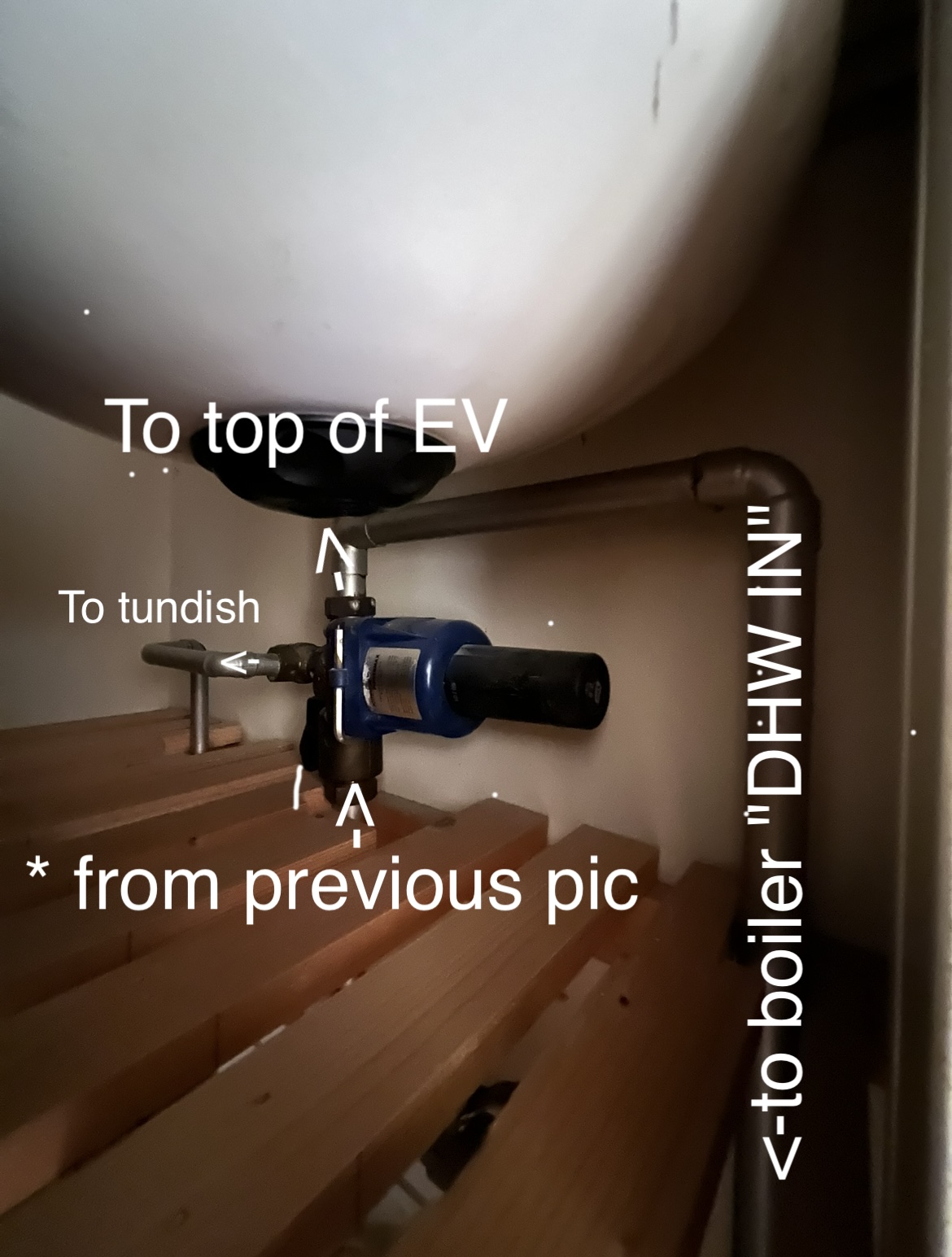

The issue I've got with isolators is I only have access to each utility so would have to put isos on everything as and when I get to replace each. Would it be acceptable to put a 22mm full bore ball valve directly after the boiler DHW outlet before it disappears into the floor cavity and disperses around the house? That way I know everything is isolated from one valve?
Here's the setup.
I am assuming that the "cold feed in" and "cold feed to house" is the right way round, otherwise there would be no isolation of the cold feed to the boiler.

UV EV usually 3bar when open to atmosphere. When water pressure is against the diaphragm it skews the reading.
Here's the setup.
So you have a pipe from the EV going into your boiler?
I can't picture the setup but seems wrong as how you've annotated it!
Normally, you'd have cold mains going into a combination valve which would balance the pressure to the hot and cold feeds to the house. Then, on the hot side from the combi valve (which goes to feed the cylinder) you have the expansion vessel.
Is this supplying hot water to a combi?
Confused.com
Can you do a system sketch as those photos don't really add up!
