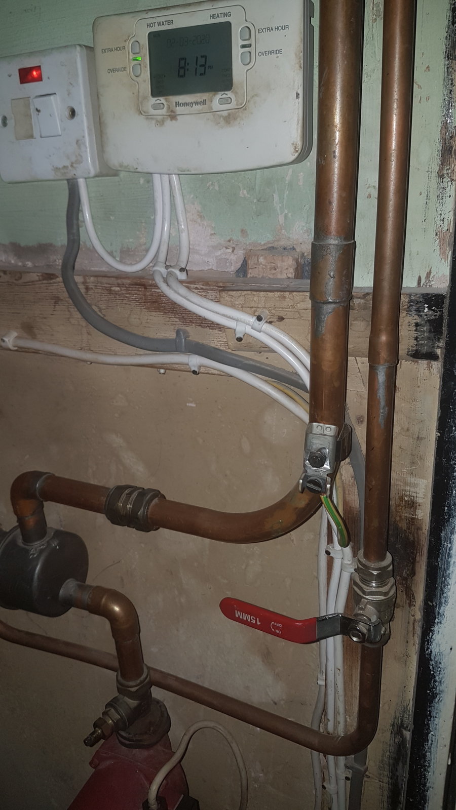

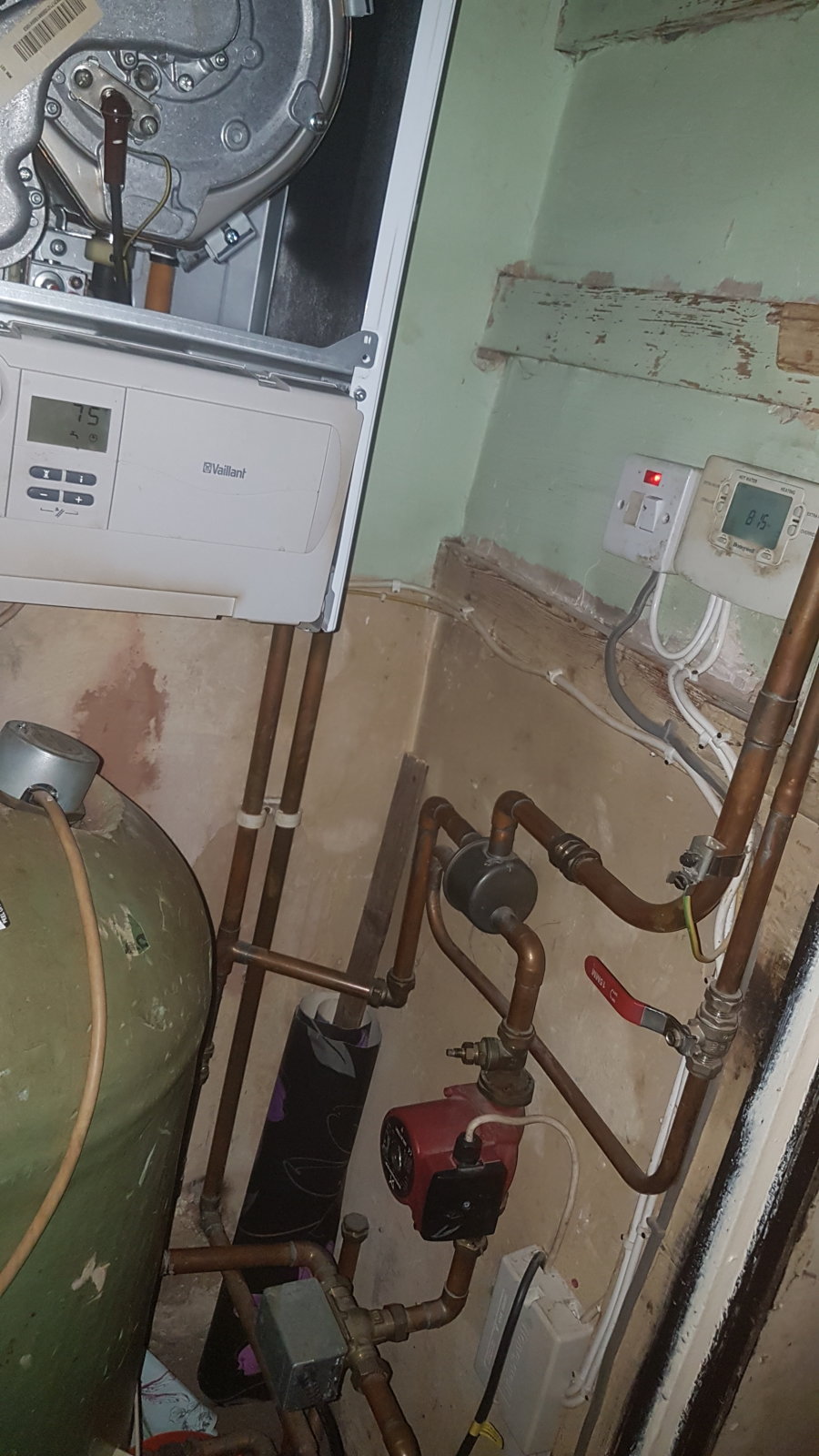

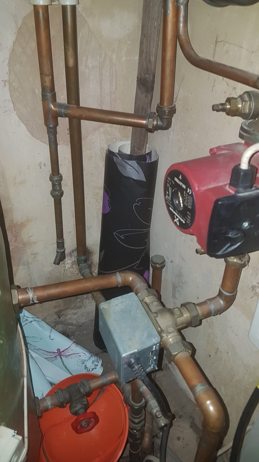

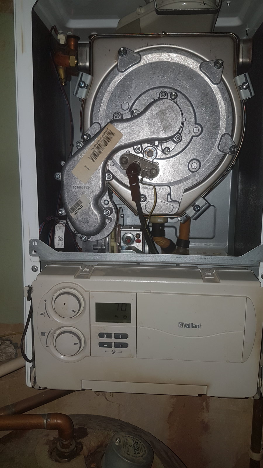

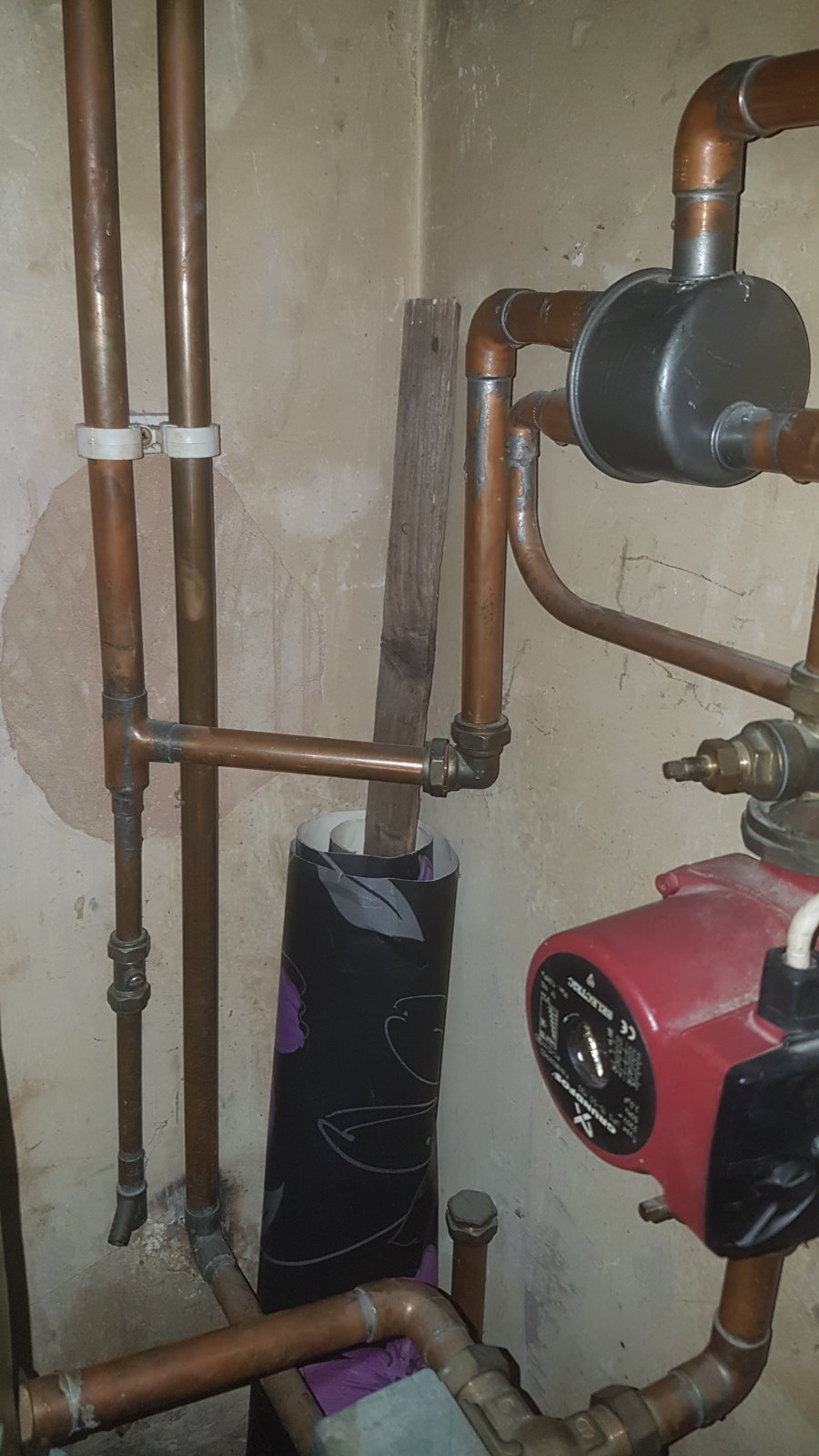

I will post some pics of my set up in a min so u can see what type it is .

As others have said, the pump could be siezed/stuck, especially if the pipe from it is only warm.
Ok thanks
Yes the pipe right next to pump is warm but nowhere else
Pump is definitley louder now
The bleed screw is certainly stuck it wont budge at all
I got my bro to try n turn it too n it truly stuck .
Anyone any udeas of ways to free the bleed screw

That lever valve should be open, I'd guess you've starved your system of water. You shouldn't have the casing off your boiler - it forms the safety room seal and should only be removed and refitted by a Gas Safe Registered engineer
As other have said you need to open this valve and leave it open do not close it again , 1/4 turn to open it
