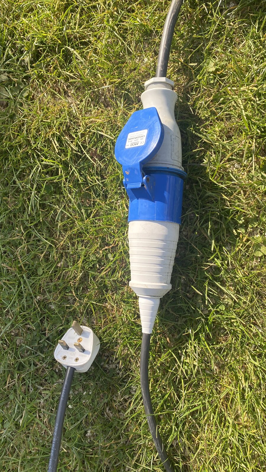

Hi guys, I'm looking for a more permanent power supply to my man cave. I currently run an extension lead to this:

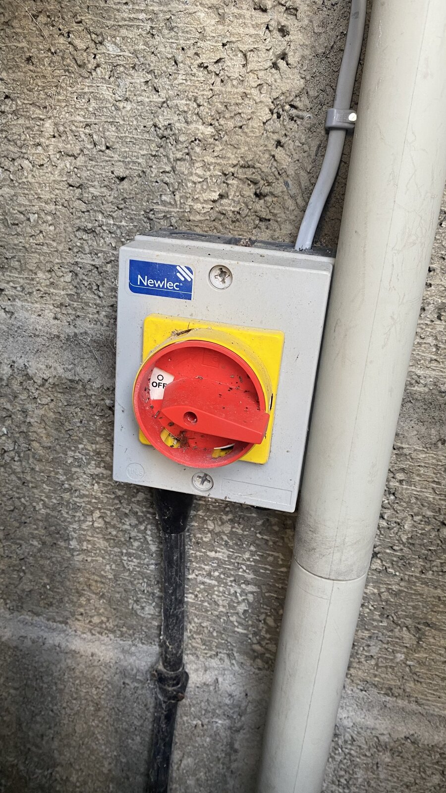

I have this under the stairs in the garage that was once used for a water pump. I'm currently using it to power a light.
My plan is to bury 2.5mm armoured cable in pipes over to it and connect in.
Does anyone see any issues with this?
Thanks.
I'm sorry to be negative but It's notifiable work, not something you are able to do yourself unless qualified.
In general:
Armoured cable doesn't need to go in conduit in the ground.
The cable size is determined by your anticipated load requirements and the voltage drop as worked out from the cable length.
The earthing arrangement needs consideration.

Could I simply power to a socket via armoured rather than my standard over ground extension lead? I’m looking for something more permanent.

If you are keen to keep the costs down and use an electricianthen first contact one. Find one who would allow you to dig a trench to their specs and either fill it in after they run the cable, or bury the spec' cable or some trunking for them to pull through.
I could be wrong but you may be able to fix an armoured cable to a fence but I wouldn't.
You need someone who can evaluate what needs to be done while keeping their work to a minimum
