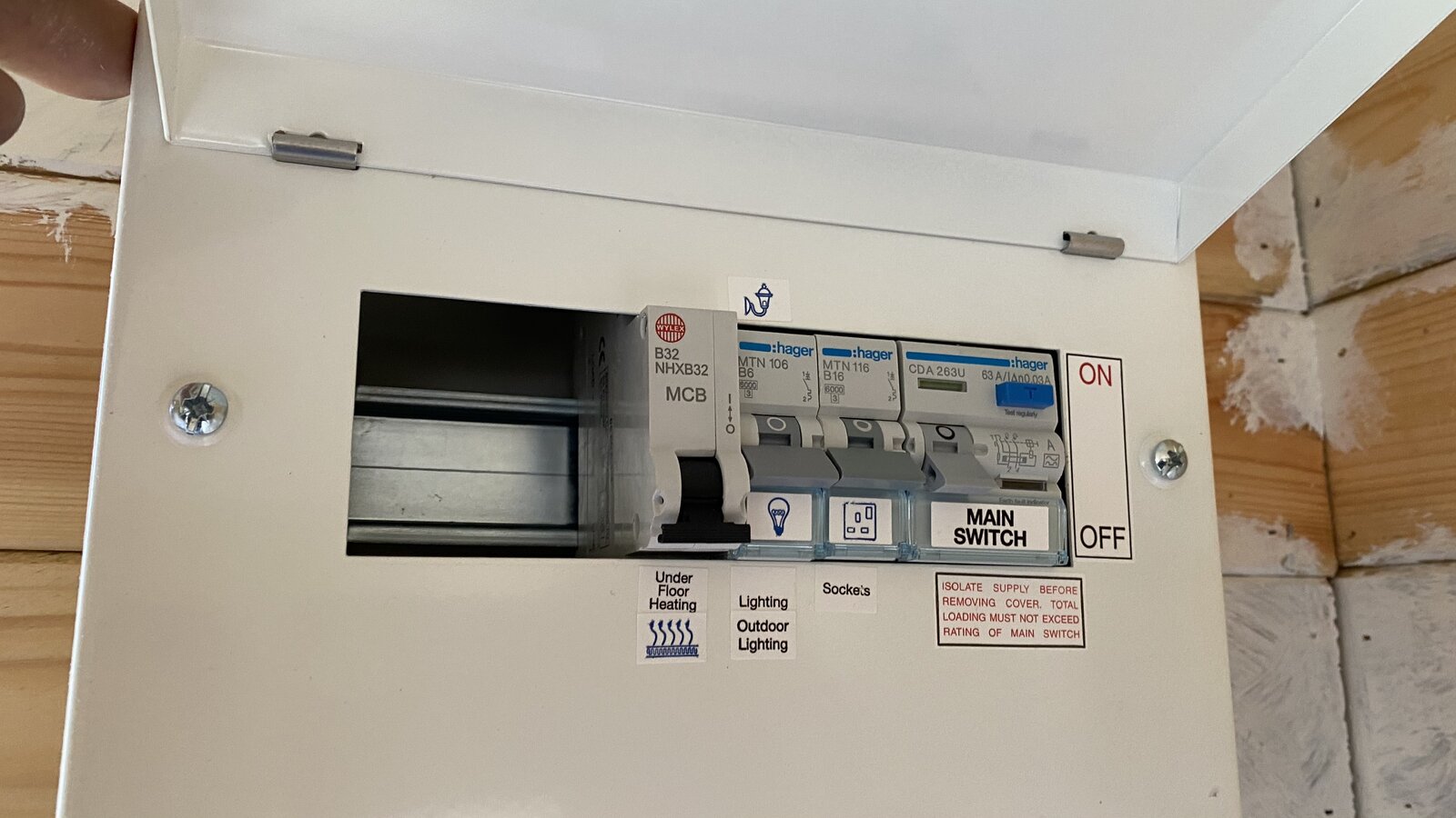

This is the consumer unit for the man cave:
5 x LED lights
4 x double sockets (rarely used)
Electric UFH 1500watt

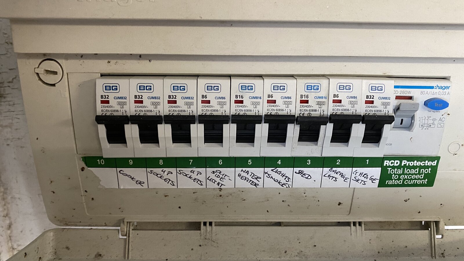

And this is the consumer unit for the garage / apartment upstairs.
No. 3 is the switch for the pump / single light that I have wired into its old place :)
This is the consumer unit for the man cave: 5 x LED lights .... 4 x double sockets (rarely used) ... Electric UFH 1500watt ....
And this is the consumer unit for the garage / apartment upstairs. .... No. 3 is the switch for the pump / single light that I have wired into its old place :)

The circuit you're planning to use currently has a 16A MCB, which would allow for a total load of about 3,680 Watts (including the UFH) - so about 2,180 Watts in addition to the UFH. It may be possible to increase the MCB rating (maybe to 20A, perhaps even 25A), to provide a bit more capacity, but that depends upon the size of cable in which it's wired - do you happen to know what that is?

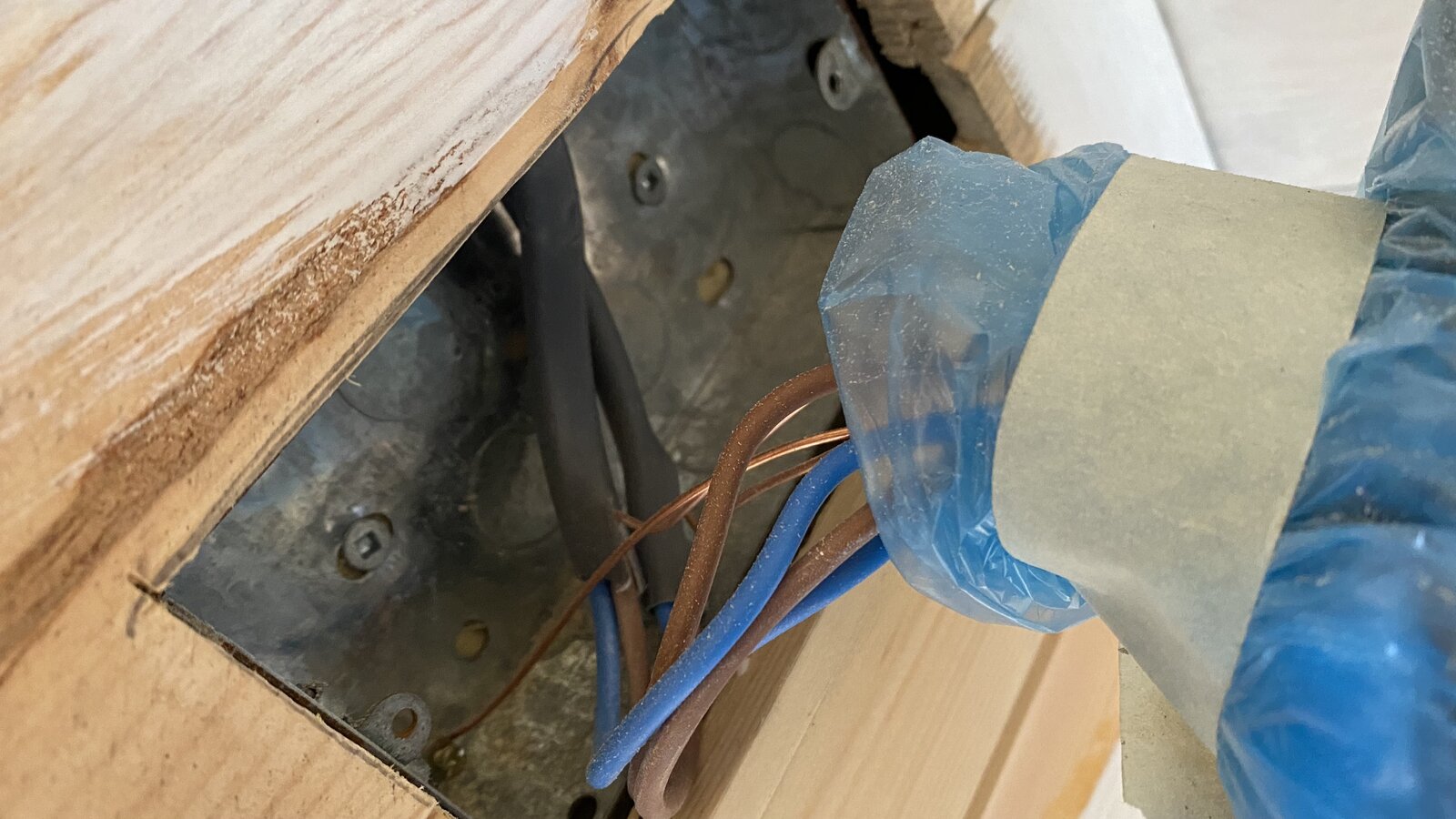

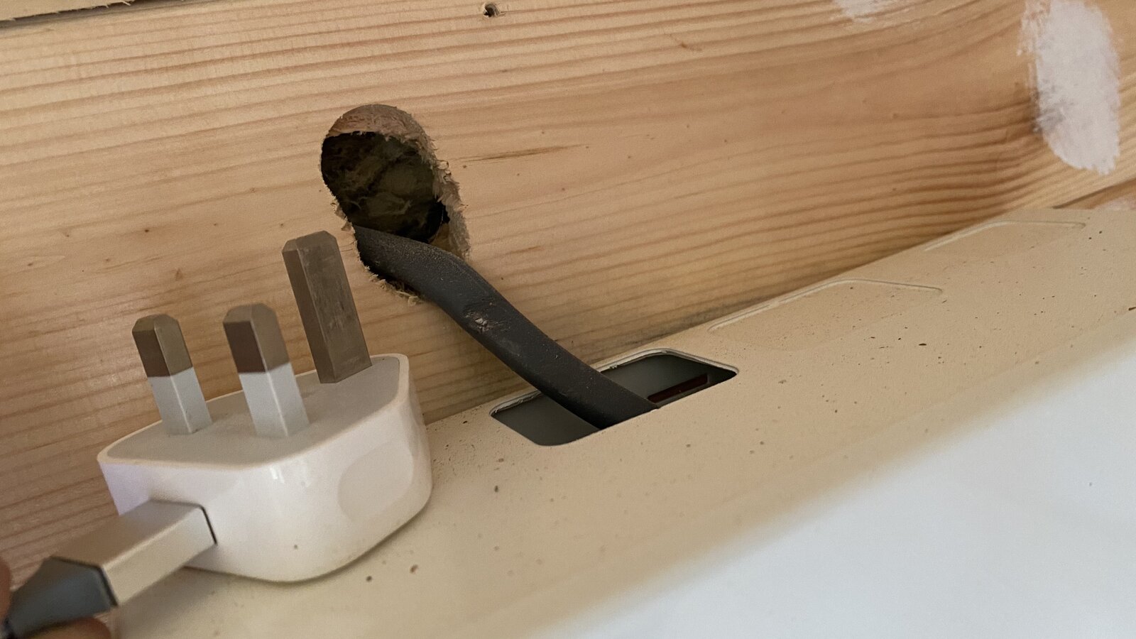

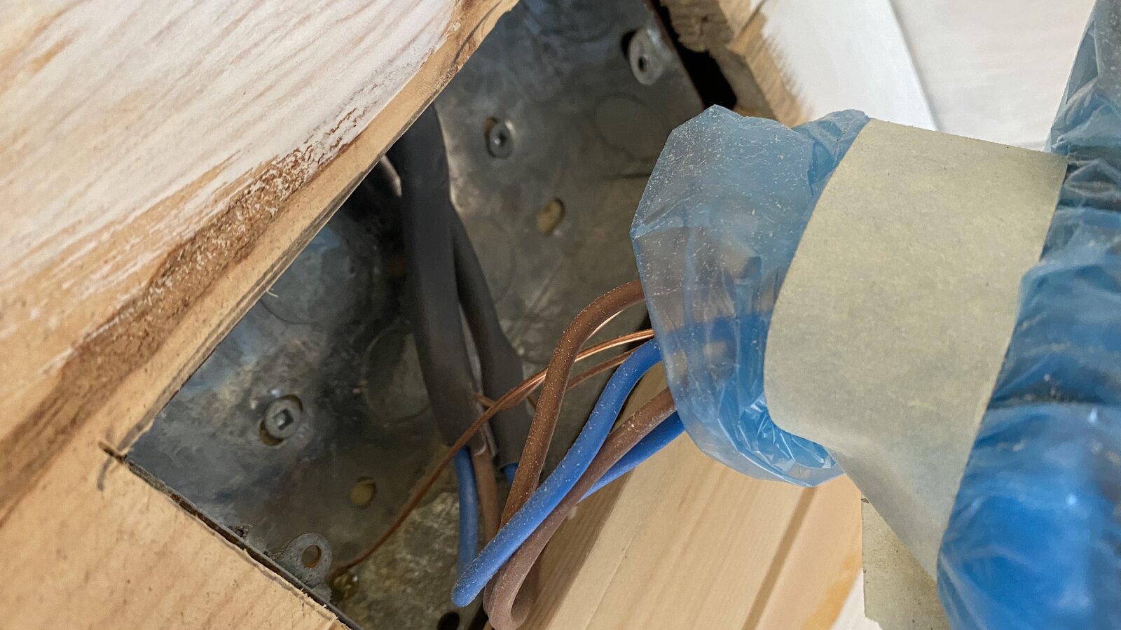

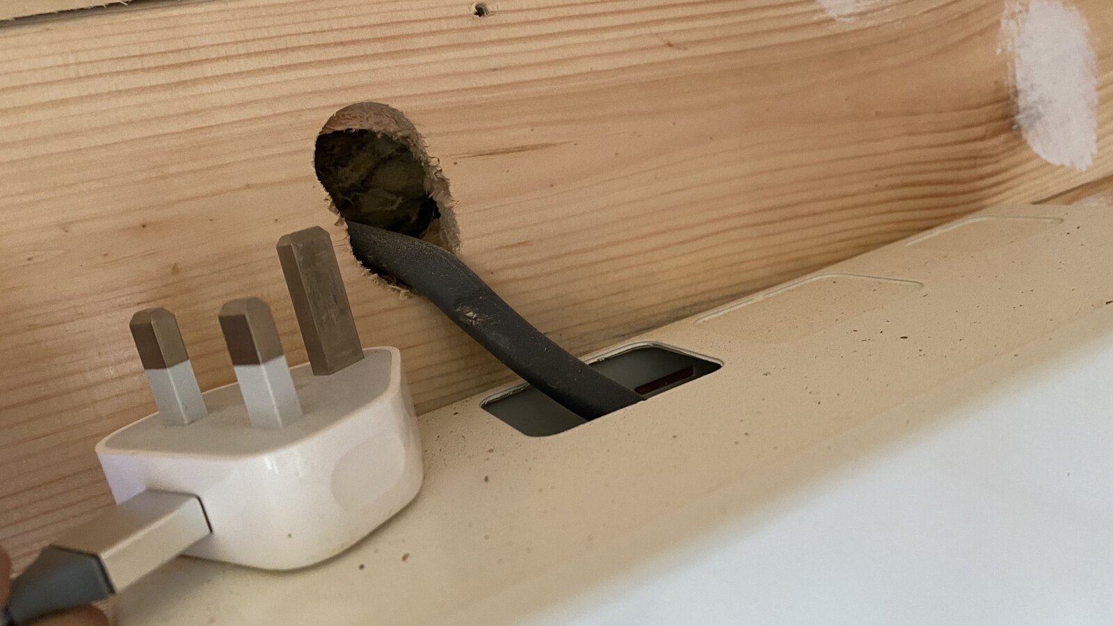

I'm not sure what size cable was used. Here are photos of the cable that enters the top of the consumer unit (with a plug beside for some scale) and also a photo of the wires to a plug socket.
It's not really possible to determine from the photos with any confidence what size cable that is - you'd really need an electrician to ascertain that. There should, by the way, be yellow/.green sleeving over those bare 'earth wires'.

There is no point having a 30 mA type AC RCD supplied from a 30 mA type A RCD, you want it done proper, so the first thing is sort out the supply. Having one 30 mA RCD feeding 7 MCB's is asking for problems, and a mixture of BG, Hager and Wylex in same box is clearly not correct, and working inside a live distribution board is not permitted even for an electrician, although we have been known to work on live stuff even if not allowed.
I would say swap the type A for an isolator and replace all the MCB's with RCBO's is likely the first job, but as @JohnW2 says you really need an electrician. There seems to be no point in replacing one lash up for another lash up.
