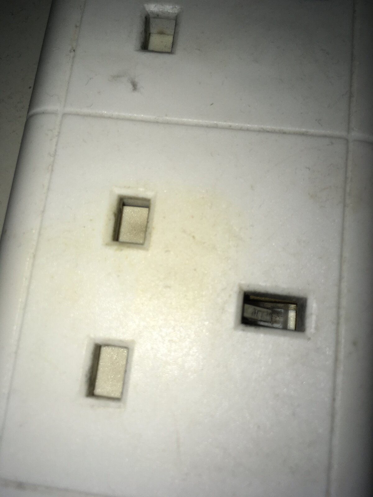

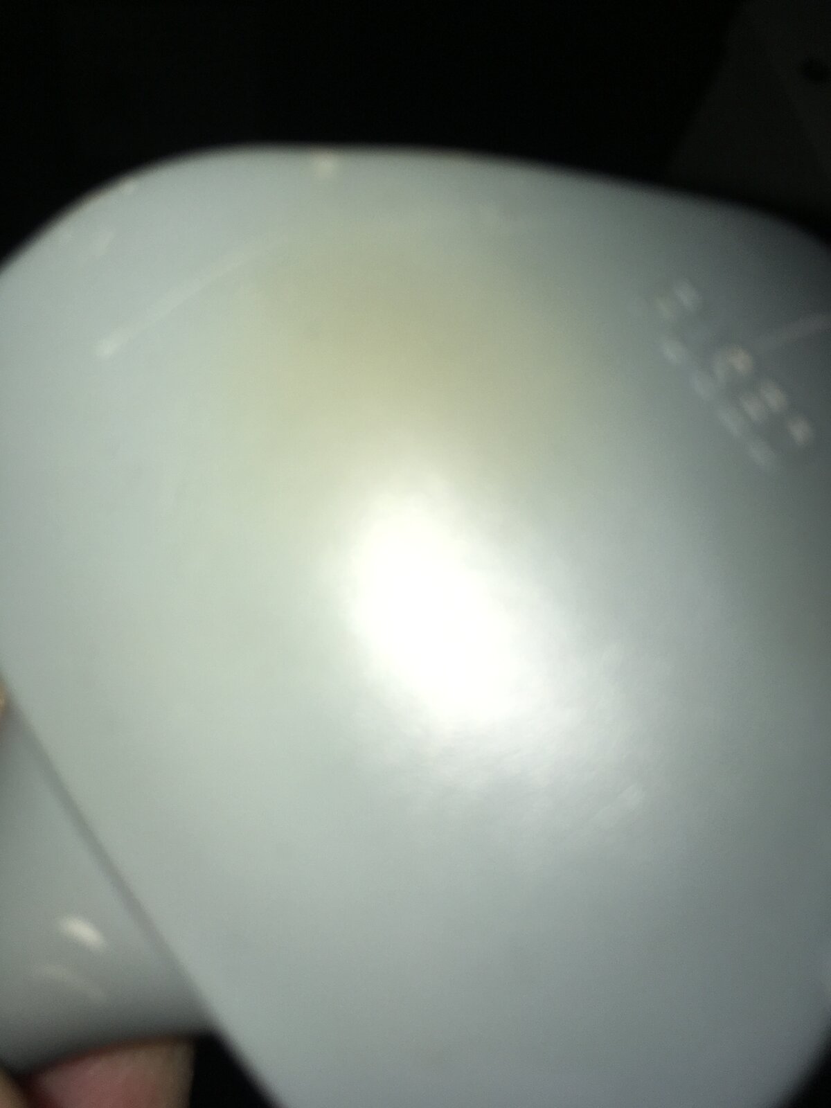

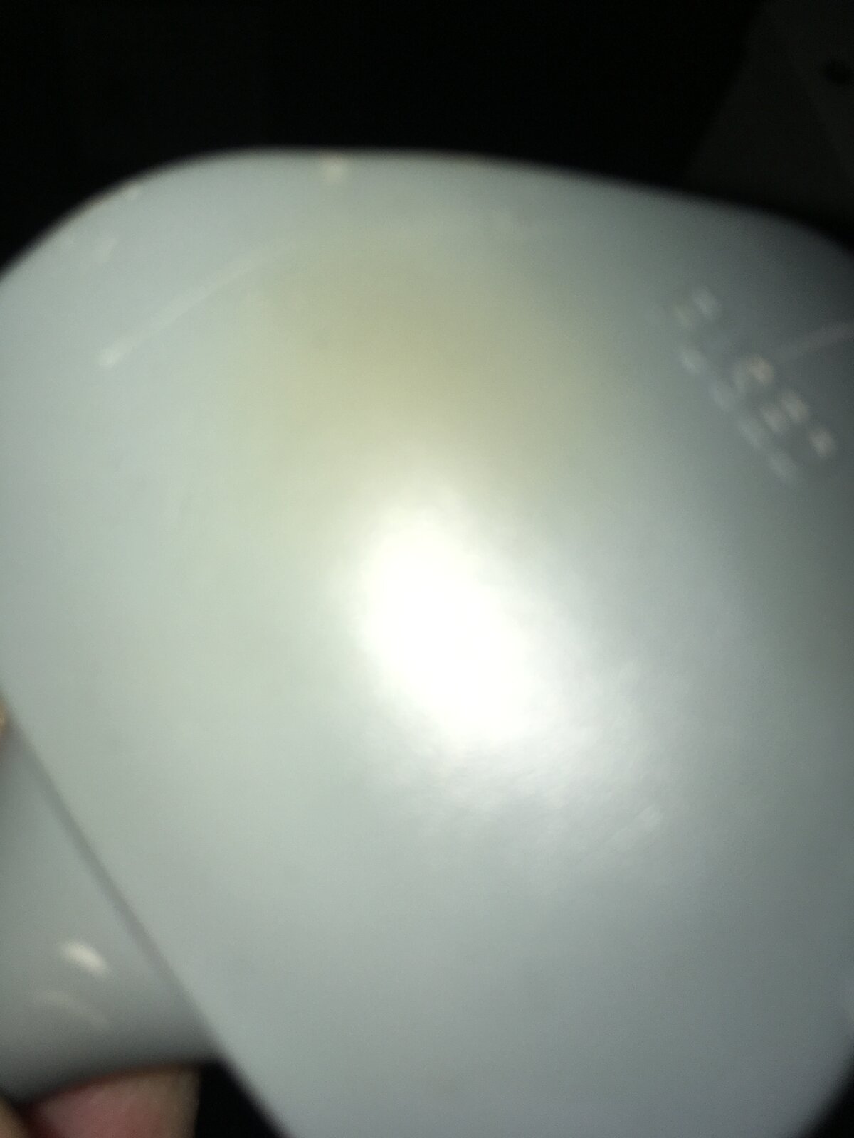

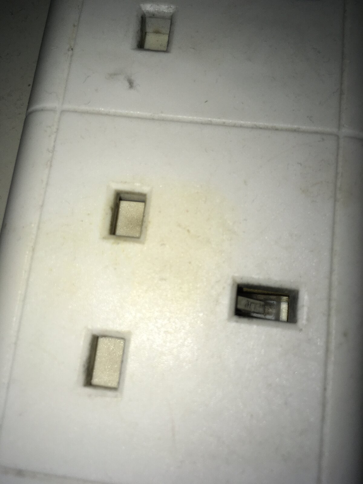

Good evening good people,
I’m after some advice, my tumble dryer plug top and extension lead socket outlet seem to be browning. Weirdly though it’s the face of extension lead and the top part of plug, doesn’t seem to be the pin side of plug? Photos attached

A fuse works by the wire inside melting when the current goes over the rating, so all fuses run hot, which is why all plugs should be in free air for cooling. Also some of the heat is transmitted down the line pin, and transferred to the socket and from socket into the wall, as a result most high power items say you should not use an extension lead.
Double sockets are especially prone to overheating when a large load is connected to both sides.
It seems that they are. However, we are talking here about an 'extension lead', which has two or more outlets (only two can be seen in the cropped photo) - albeit presumably theoretically 'limited' to 13A total load across all the outlets.

It has 2 outlets, but only the one is used for tumble dryer only. The other isn’t used.Would it be better to have a single use one or pay for another socket outlet? I’d probably be able to spur off existing double socket, but not sure my wife wants me to as I’m not an electrician.

The burning is over the neutral connection so probably a loose wire in the plug causing the overheating. Either way chop off and fit a new plug and replace the extension lead and socket. An electrician can always check the circuit if you suspect that to be the cause.
Screwfix do robust rubber plugs and sockets which you can wire up yourself with new 1.5 mm flex
