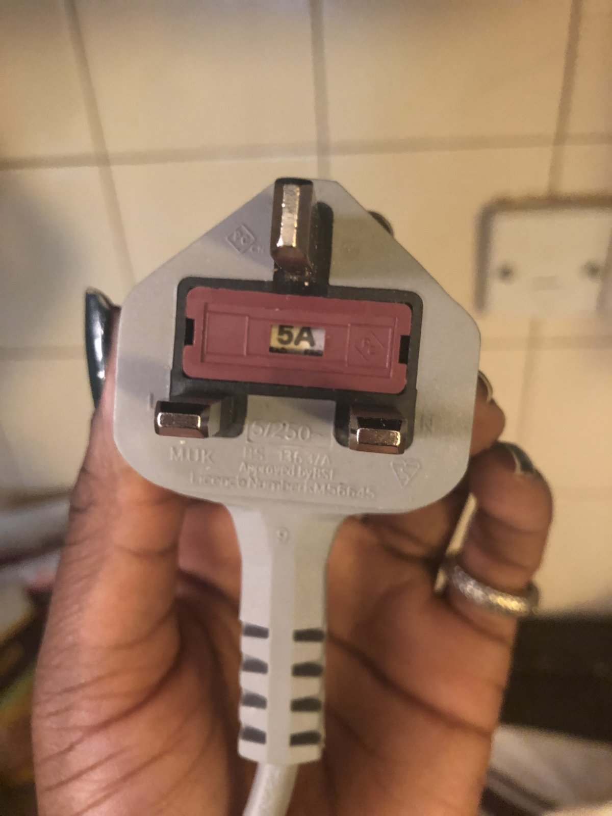

Hi all,
Slight disaster here. Bought an extractor hood from ikea with fused plug (5amp).
The older unit it’s replacing was hard-wired from a wire coming through the wall with one of those terminal blocks. Easy I thought, I’ll just swap them over as I managed to hard wire the cooker and heater yesterday with no issues.
This wasn’t the regular style plug you could unscrew to pull the wires through so my silly self went and snipped the plug off the hood, only to find there are only two wires (brown and blue, no earth).
The wire coming through the wall has the usual 3 wires (N,L&E). I’ve also already attached the hood to the wall and screwed it into the cupboard above, so I’m fairly sure I’ve voided the warranty :(...I know I know schoolgirl error!
Needless to say I need help connecting this up please. I just can’t afford to get an electrician out hence trying to do things myself. Any help greatly appreciated.
P.S There a couple of FCUs nearby but all 13amp
Here it is

That's just an ordinary plug.
Just connect brown to supply L brown or red and
the the blue to supply N blue or black.
Connector block is not ideal but not the end of the world if on top of the units.
One of these or similar would be better -
https://www.tlc-direct.co.uk/Products/ASJ501.html
Warranty will not be affected.
The hood must be 'double insulated' and not require an earth.
You can replace the fuse in the relevant FCU with the 5A.

So I actually connected the blue and brown wires to the blue and brown cable coming out of the wall and taped off the earth. When I tested it, it didn’t work. What could I be doing wrong?
As a test, I re-wired the hood cable and it worked when I plugged it in. Unfortunately, there are no sockets near by or I wouldn’t have just plugged from the start.
The two FCUs have 13amps in them...am I right in thinking that one of these leads to the cable sticking out the wall and that I just need to change it to a 5a fuse?
You can't assume the cable is even still connected to anything.
But any chance did you switch the cooker switch on at the wall, the big one?
A multimeter is your best friend here.
Seems like no power at the FCUs. Are fuses good?
Do you have a multimeter?
Impossible to say from here. What were they used for before?
Yes but that will make no difference to whether it works or not.
Test fuses in another plug - something low powered - and see if they are good.
