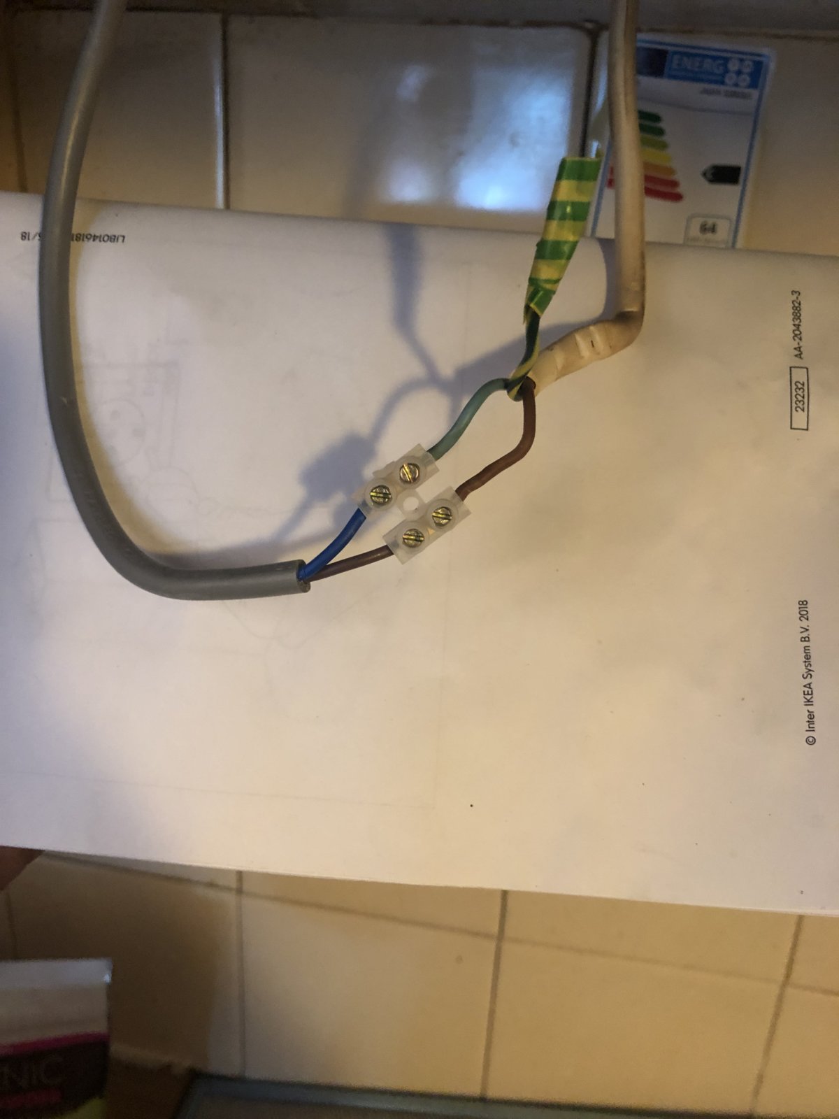

I’m so sad. Swapped the dead fuse with the 5a and then re-wired the unit (Grey cable is unit, and white is from the wall). Still no luck :(
Have I wired it incorrectly?
Coco,
Wiring looks ok, but when you look up the holes, are the screws sitting on the base wire or the on insulation?
At this point I would say wire old Hood back on (as you said it was working before??) and see if it works (to test to see if gray lead is live or not).
SFK

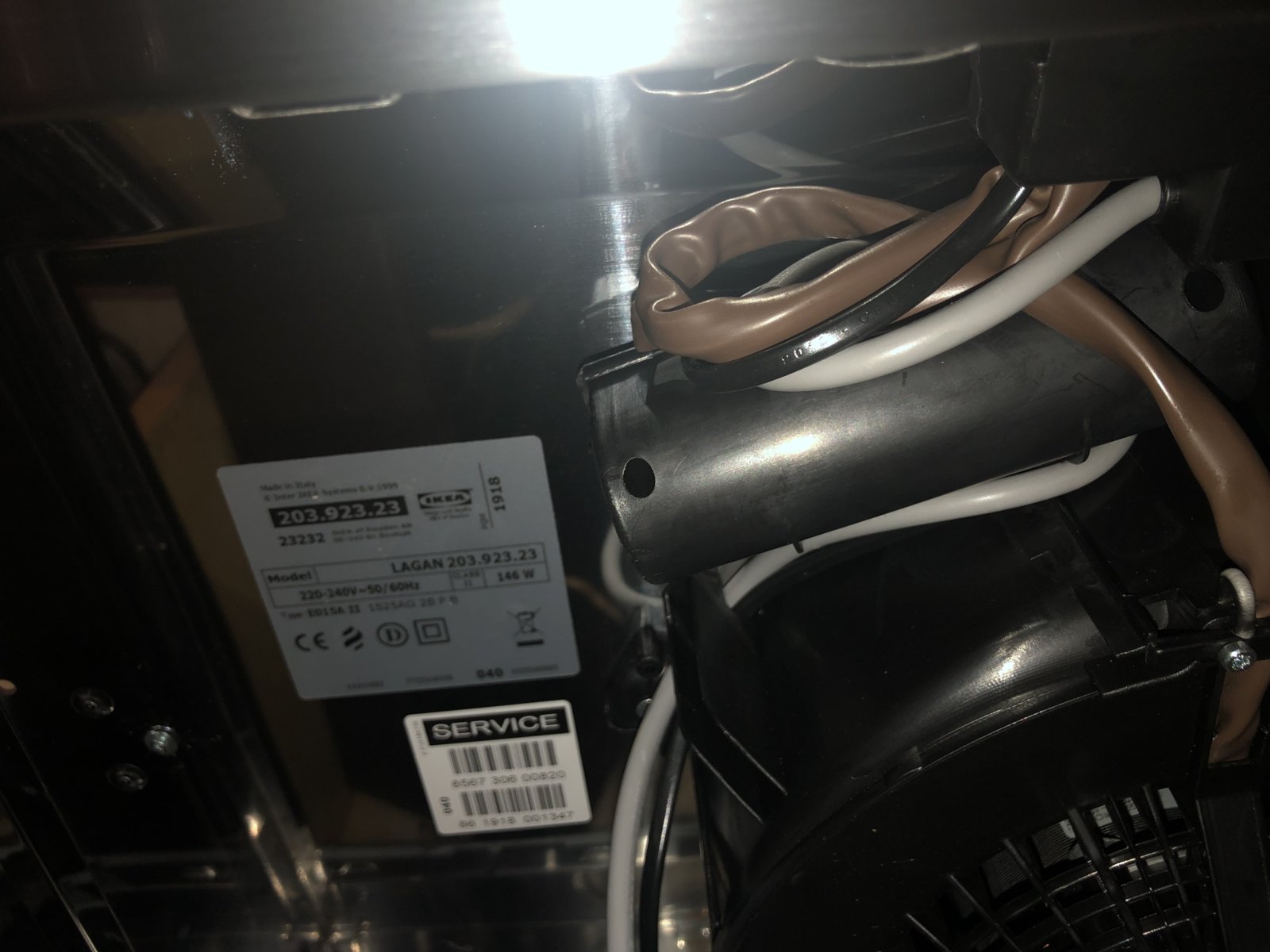

I don’t see any screws. It’s just the grey cable coming from the hoods. There are other wires but they’re all tucked in:

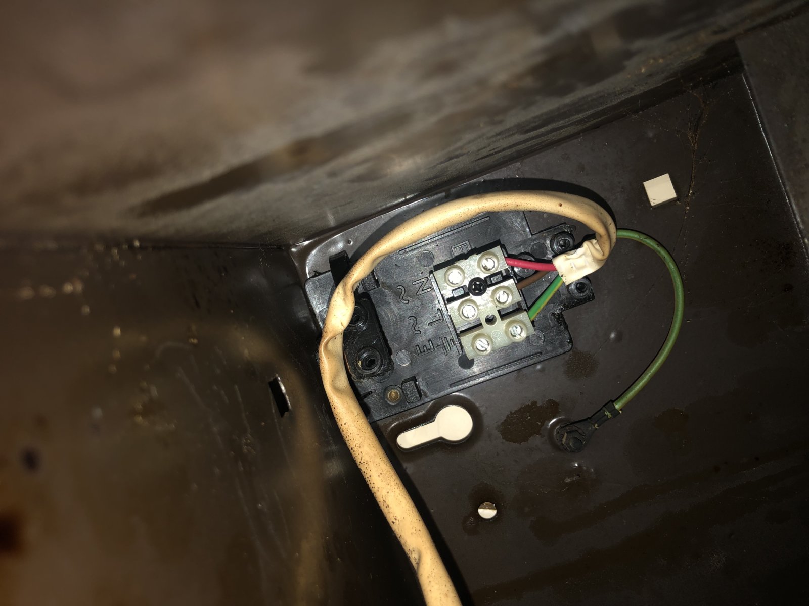

Noticed this from old hood. The earth wire I thought was coming from the lead but it actually just solitary and screwed into the metal body
Coco,
Apologises. When I said check the screws I meant at the termination block between the old wire and the new hood wire. This was in case the wires inside the termination black were not properly connecting to metal (all it needs is one wire ):
