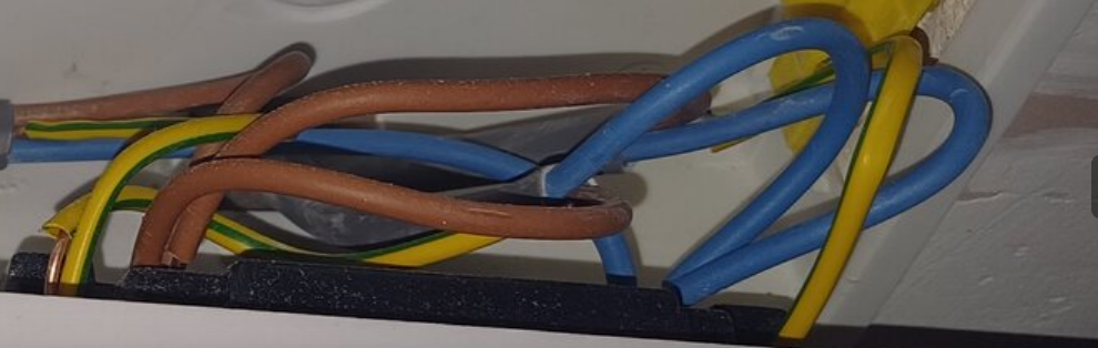

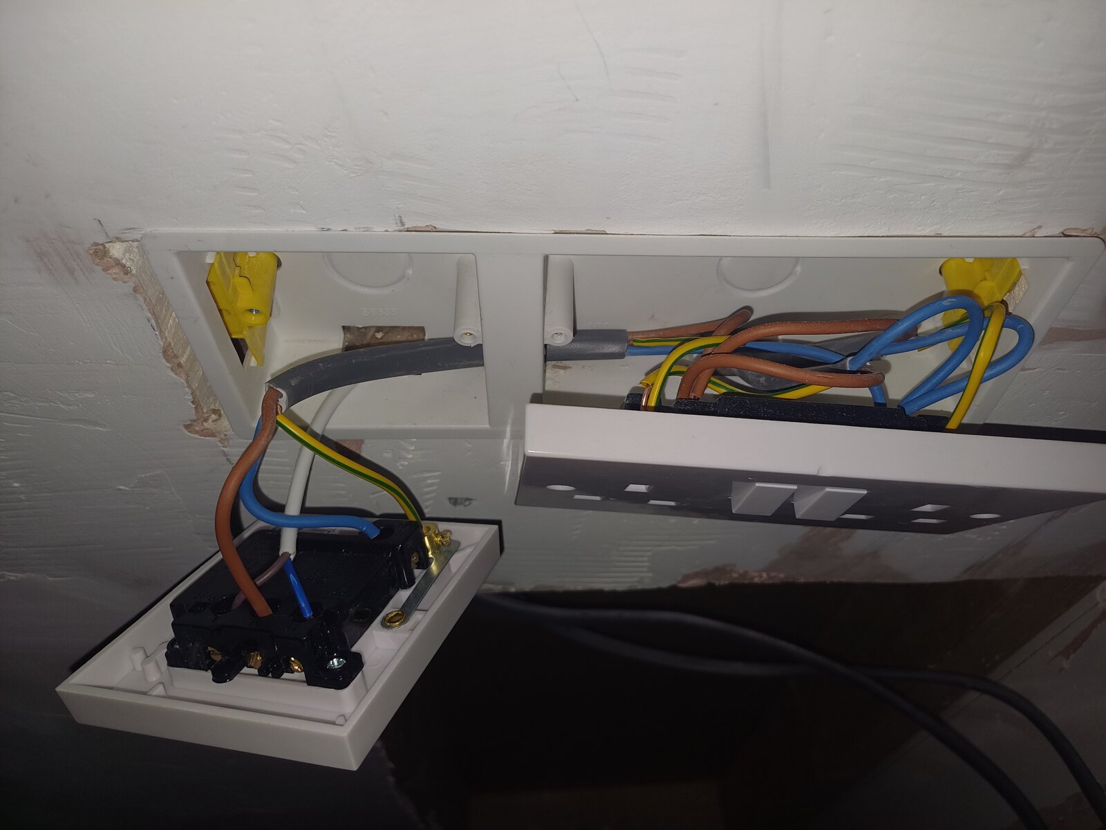

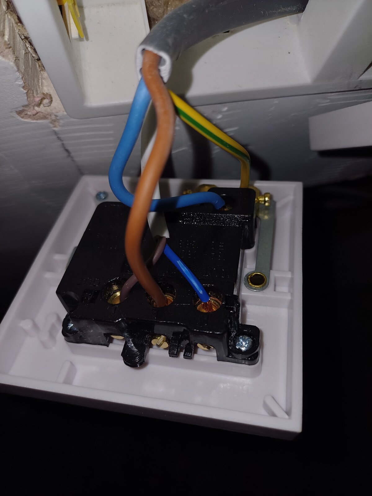

Hi all,
I've been trying to sort out wiring for extractor hood, but isn't working currently.
I've put a double pole isolation switch spurred onto a double socket in the ring (shown below), which connects the twin cable that goes to the hood.
When on there's power in the double socket, but the hood doesn't do anything; no light and no fan.
I'm pretty sure there's power in the hood, as the live wire detector goes off around it, but it does that whether or not the switch is on or off....
Am I wiring the switch incorrectly?

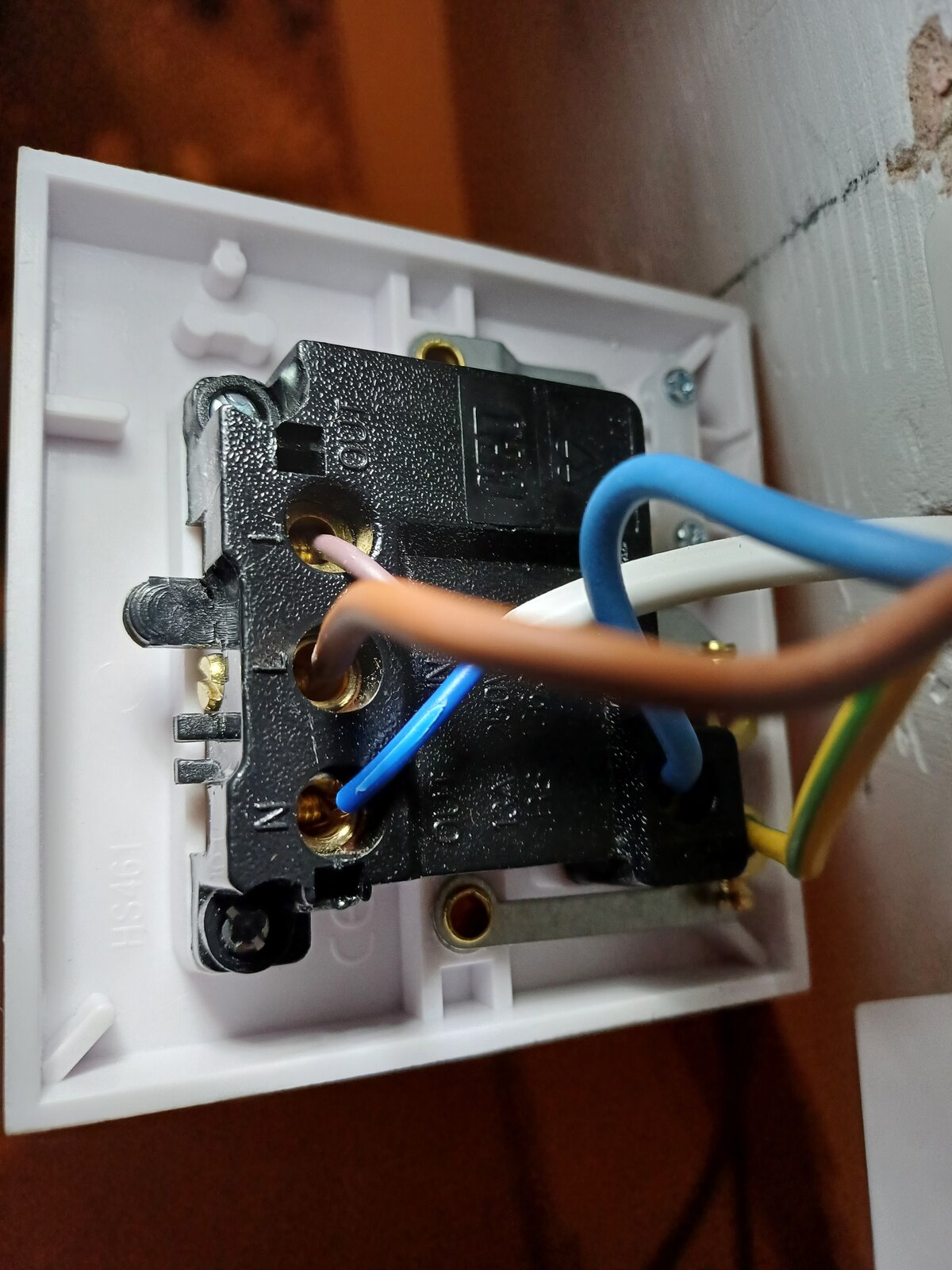

Doubtless but I can't see.
Turn them both towards the camera and use flash or a good light.
There are letters by the terminals, embossed on the black block
Have you got a better testing devices such as a two pole voltage tester?

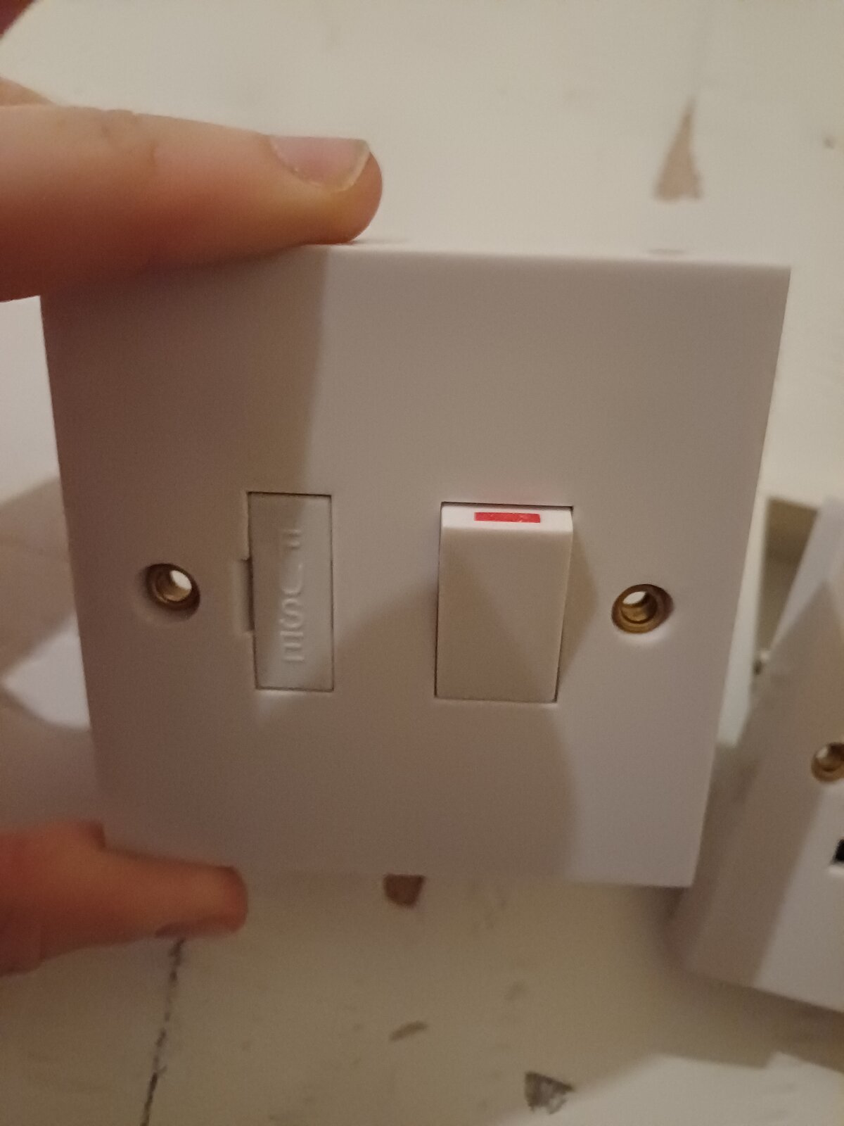

That is the reason why you don't rely on these. The chances of you wiring that switch incorrectly is very low have you checked the fuse? Does the neon light turn on at the switch?
The smaller Brown is in 'L OUT' and the smaller Blue is in 'N OUT' so it would appear to be wired correctly.
Is the fuse good?

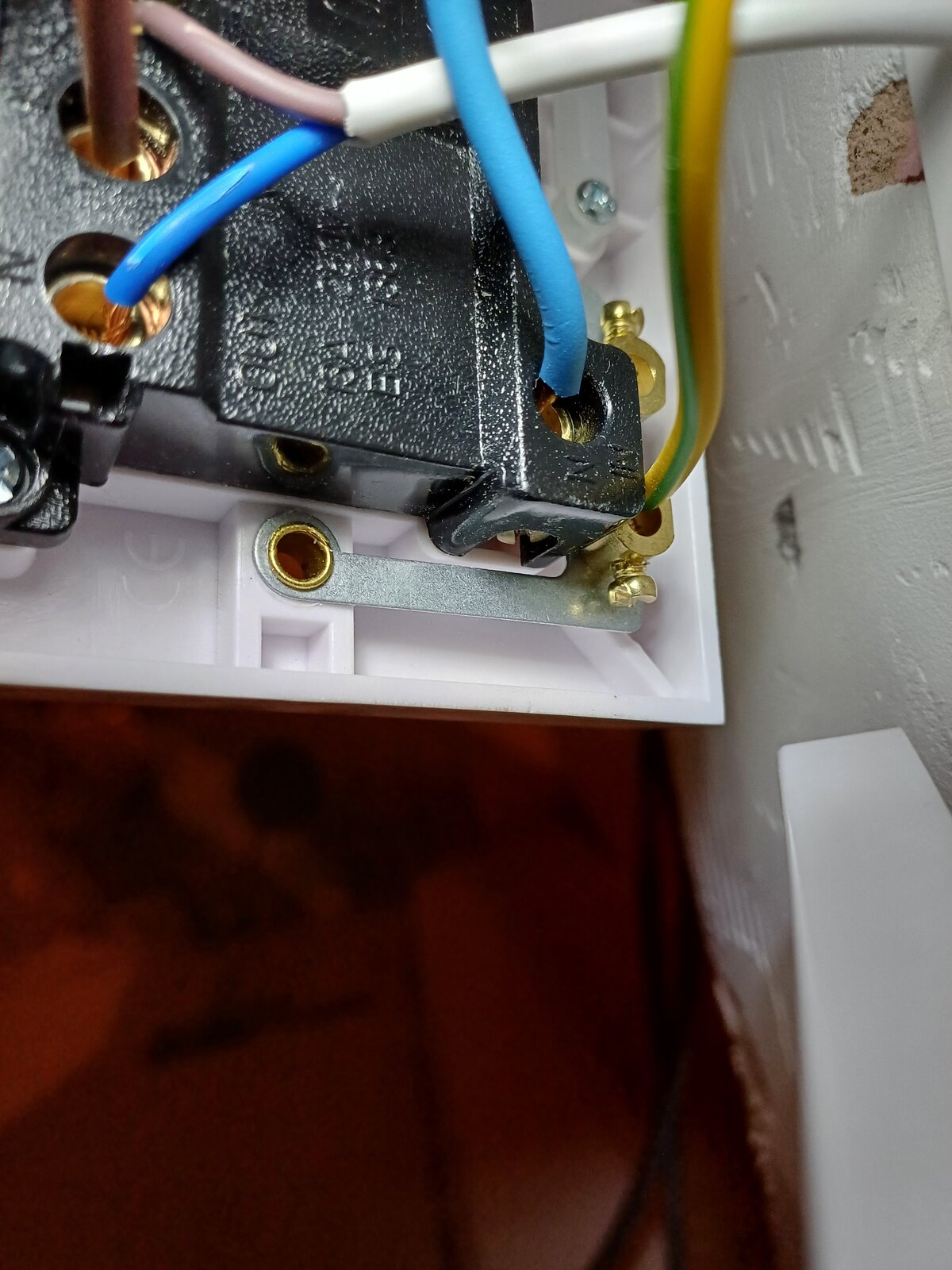

Hopefully these are a little clearer. Black letters on black is hard for the camera. For the double socket, the blues are in the N, and browns in the L, so dont think thats gone wrong.
I thought maybe the fuse so changed to another 3A, but no change.
Theres no light on the front of this switch.

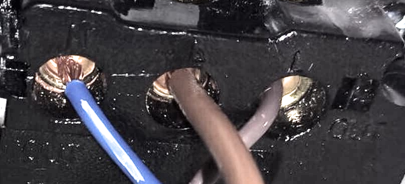

Is the brown of the flex actually gripped onto the copper? It looks as though it may be screwed onto the insulation.
