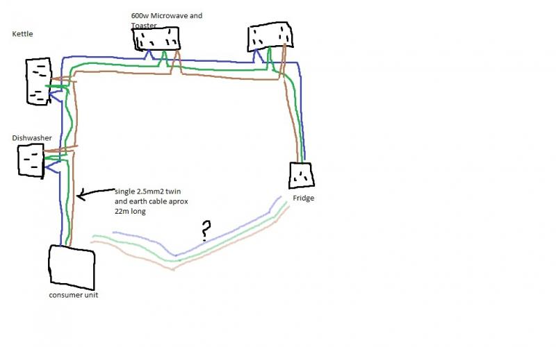

I am building a new kitchen and there is no electric in there so i need to put in a new circuit. I have drawn a diagram of what im doing. Iam not sure if I should make it a 32A ring or weather I need to increase the cable size .Also what size breaker should I use? can I use a 32A on this radial with a 4mm2 cable?
[/img]
I do realise I have a lack of knowlage thats why I am asking on here.

While you deserve credit for raising the issue, this is a diy forum and the installation of a new circuit, especially one in a kitchen, does require a level of knowledge above that of the majority of diyers.
You do not say what information you have provided to your Local Authority Building Control for example. You have not mentioned the need to additionally protect the circuit - nor have you identified how you intend to test that the ring/radial final circuit meets the testing criteria.
