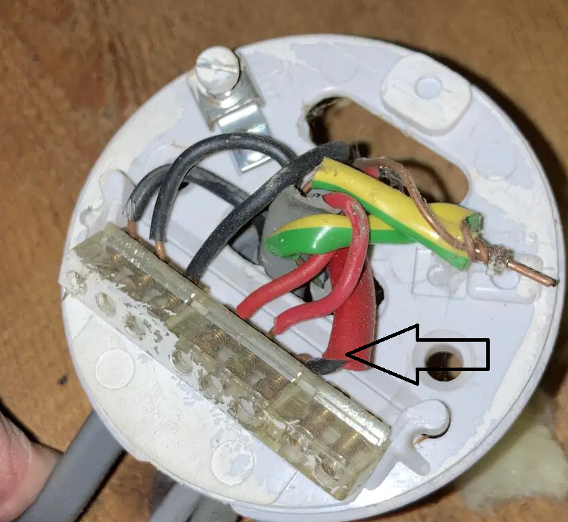

I have been talking with a family member who is an electrician and I have a new fan that needs to be wired to a switch live from a previous bathroom light installation.
The light switch outside the bathroom is the black wire with red tape shown below.

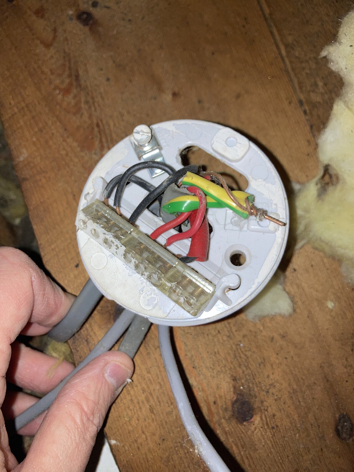

I have found the old ceiling rose from the bathroom in the loft which seems to be powering 6 spotlights in the updated bathroom.
The thing that is stumping me is that the switch live cable from the light switch outside the room is in the loop terminal not in the live side.

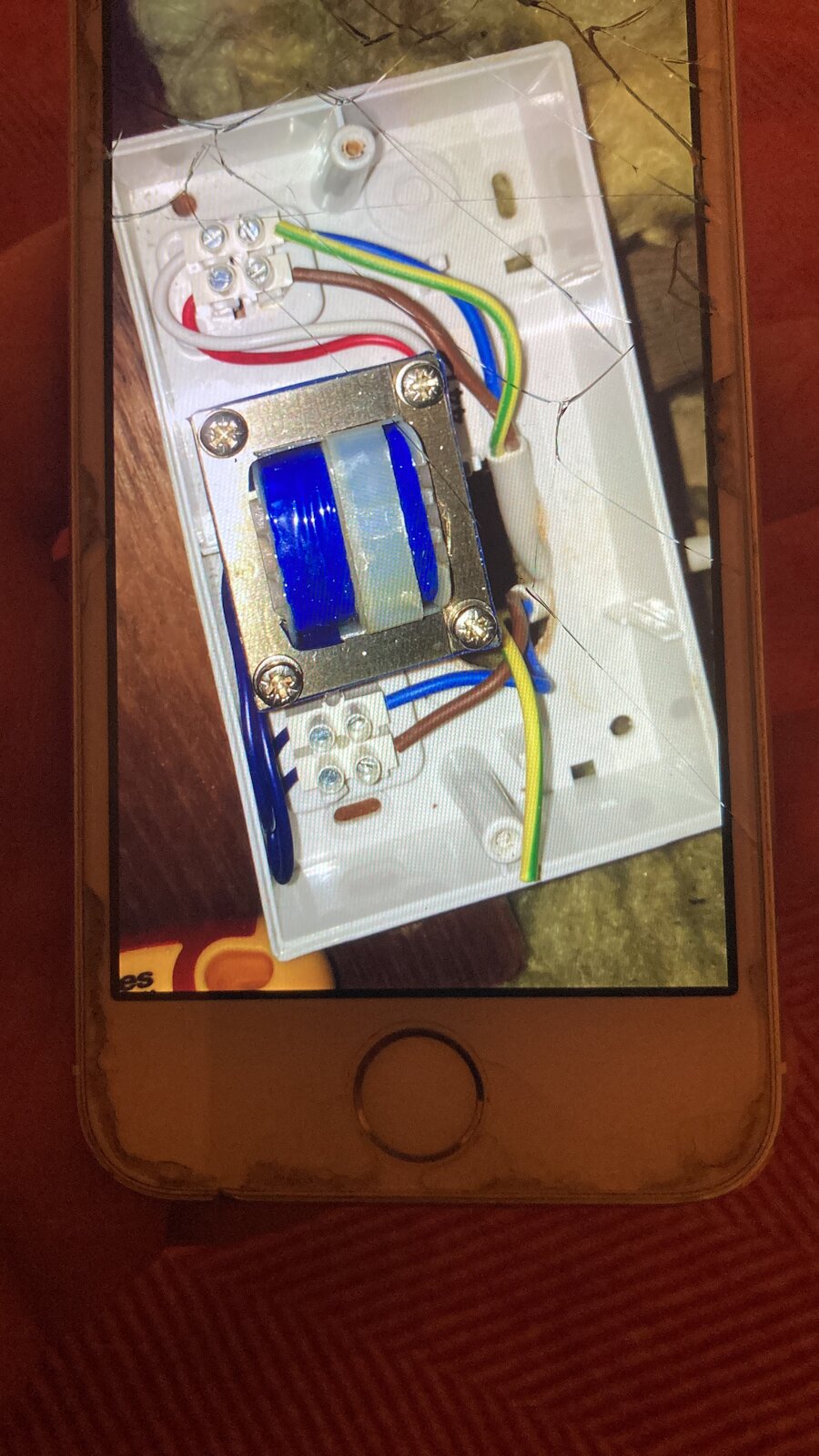

The previous 12 volt fan was connected at the other end of the spotlights into a 12 v step down transformer which I will have to remove.

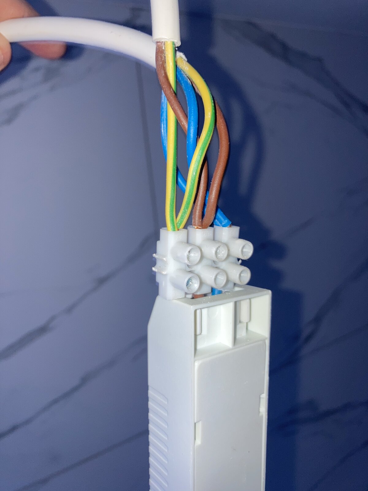

The right side of that wiring goes down into the shower fan which is now defunct. The left side flex comes from inside the false ceiling where the bathroom spotlights are housed now.
Any ideas how to wire the new fan isolator switch in properly once the old 12 volt fan is removed? I will have a live and neutral coming from the spot lights. I just need to work out how to take the switch live from the ceiling rose ( pictured above) which is now acting as some sort of junction box.

And the rest of the wires please.
Which I'll make a stab as being 2 reds in a connector block behind the base of the rose.
Thank you which wires do you need?

The spot light wires go into the old fan junction box on the left hand side ( couple of pictures above)
When I say junction box it is the fan one with the step down 12 volt transformer in it that feeds the defunct shower fan below.
Do you need permanent live and switched live and neutral for the new fan?

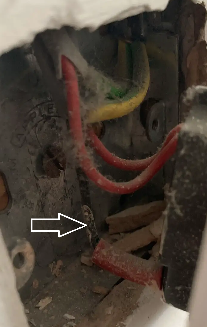

If the answer is yes: Is this black wire with white arrow
part of a twin & earth with one of the reds?
If the answer is yes: make sure the power is off and look behind the remains of the ceiling rose and find out which of the twin&earths this black arrowed
belongs to
I ASSUMED because some of the grey cables looked smaller, that single sheathed and insulated cable had been used for the 'extra' black wirres.
If the answer is yes: Is this black wire with white arrowView attachment 330070 part of a twin & earth with one of the reds?
If the answer is yes: make sure the power is off and look behind the remains of the ceiling rose and find out which of the twin&earths this black arrowed View attachment 330071belongs to

My next question is do I place a new wire from the SL wire ( black with red tape) in the ceiling rose terminal to L1 in the isolator switch?
I am going to wire in a fan isolator switch into that ceiling rose if that’s the right thing to do?
I have an electrician coming tomorrow but it would be nice to get it working today and cancel him if possible. It seems fairly simple once you know where to put the wires
The wiring doesn’t seem to follow convention but it’s the same electrician that installed it so hopefully he knows what’s going on!
I’m guessing all the red cables in the ceiling rose you can place a wire into any for the L2 on an isolator switch? and the same regarding a wire going into the neutrals terminal going into N on the switch?
The spotlights have a twin and Earth feeding the defunct shower fan from one of them in guessing just disconnect that wire and the circuit will be complete and safe?
Yes and I think that is the highest possibility, there is the slightest of possibilities they are different size conductors but it doesn't seem apparent from the red and black
Hence they way I worded
... Is this black wire with white arrow ... part of a twin & earth with one of the reds?
If the answer is yes:...
