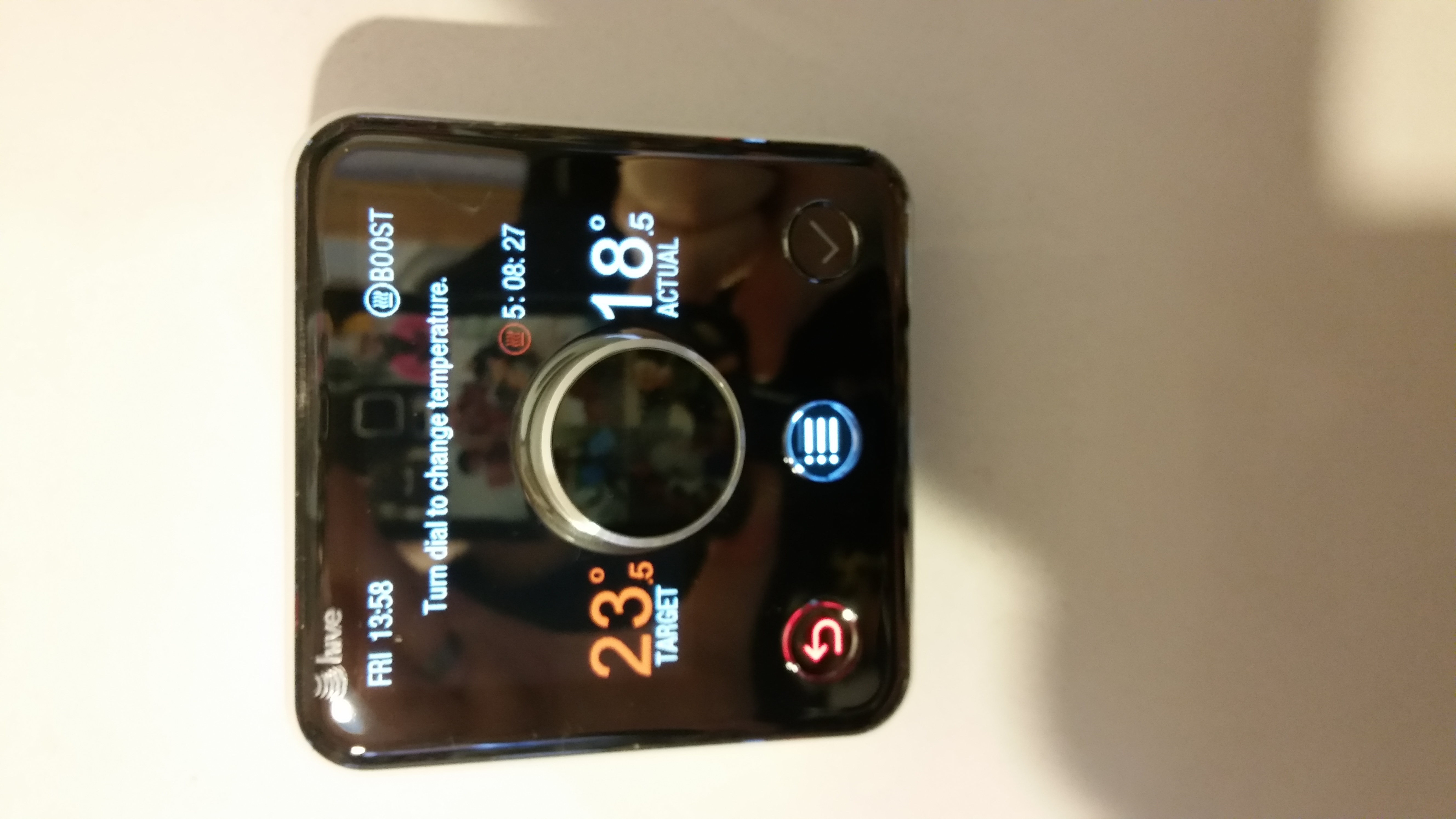

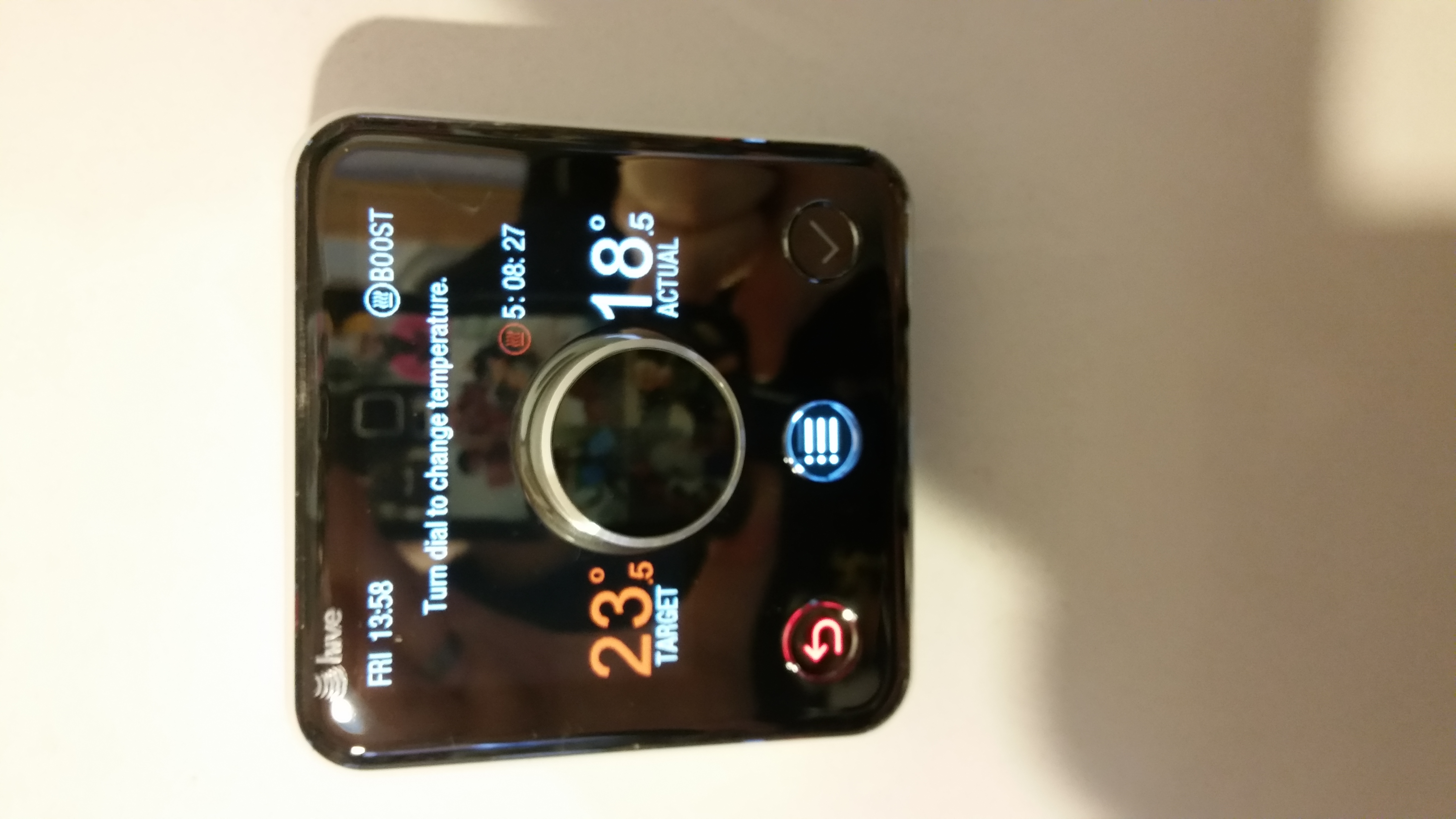

Well it's in and working
A huge thank you for your help and advice. I really appreciate it.

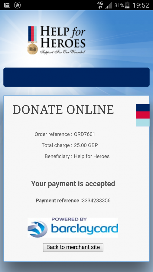

As mentioned I'll make a 25 quid donation to h4h (charity close to my heart) as I saved that paying someone to tell me what goes where.
I'll post the screen shot shortly.
Thanks again and happy new year from a warm house with a now happy wife lol
