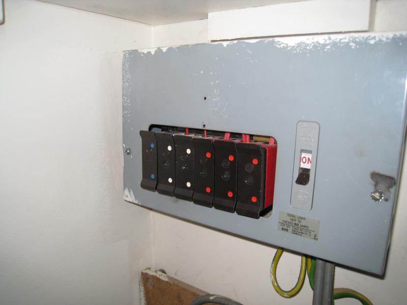

Right. The facts:
Hob 6.4kw = 27.8 AMPS
Oven 3kw = 13 AMPS
TOTAL = 40.8 AMPS
The plate with the large red switch doesn't appear to have a fuse inside. Where does my 40 AMP fuse need to be? Does it need to be in the consumer unit under the stairs? I have an old unit that has cartidge fuses. Do I need to know which refers to my kitchen then ensure that a has a 40 AMP fuse?
And can someone tell me what is wrong with the square junction box I have? Yesterday everyone shrieked and howled and said I was 'stupid', rather than being sensible and responsible by telling me what was wrong with it.
(please only reply if you genuninely have some help, not if you're going to make nasty, snide comments. That helps no-one)
You need to look in your fuseboard and see what value of fuse is protecting your existing cooker circuit.
Right. The facts:
Oven 3kw = 13 AMPS
TOTAL = 40.8 AMPS
No - the cooker should have a separate fuse in the consumer unit, which will most likely be labelled (written inside the small cover over the fuses)
It should not be on the kitchen circuit
Apart from the fact that you are ignoring the professional advice given, the connector strip you intend to use is rated at 30A, whereas your own calculations above indicate you need one rated at over 40A
no! its not supposed to.
yes .
your cooker should be on its own circuit.
the sockets are on a seperate circuit.
Ok, I have one of the old type fuse boards below. The fuses are rated, from left to right, 15, 5, 5, 30, 30, 30
When you say I need to see which one is protecting my cooker, do you mean which one is protecting my kitchen? There are 6 fuses in the board and I assumed they each related to a different room in the house. Thanks for your help mogget...
Ok, I have one of the old type fuse boards below. The fuses are rated, from left to righ, 15, 5, 5, 30, 30, 30
Not true - is there anything written inside the cover?
Nothing written on the inside cover. It's just blank. Why would the cooker have it's very own fuse, but not other appliances in the house?
Because the cooker draws a lot of current and so uses different size cable (6mm) instead of sockets (2.5mm) and lights (1 or 1.5mm)
The fuse closest to the main switch looks from the picture as though it has a single 6mm cable going into it. Can you confirm that this is the case since I can't see it clearly?
