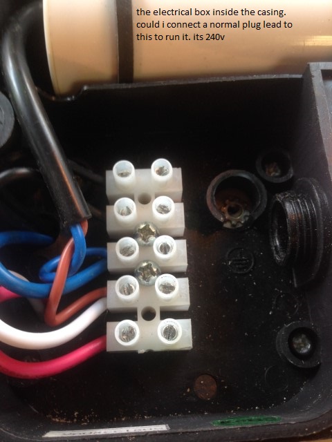

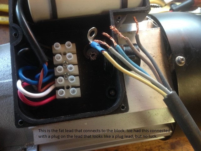

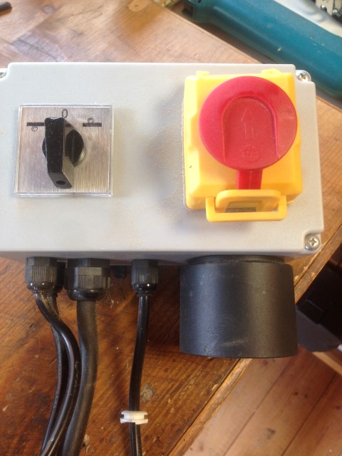

hi all,
i was given this motor free of charge from a member on the site and apparently its off of a record planer/thicknesser.
as you can see in the pictures it has an NVR switch.
there is 4 wires comming from the NVR and i was hoping someone would point me in the right direction in how to wire this up properly.
even if i cant use the NVR, is there a way to just connect a normal plug to it to power it .
hope you can help
thanks
chris....

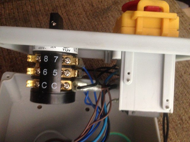

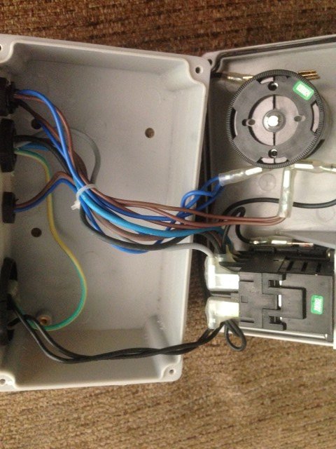

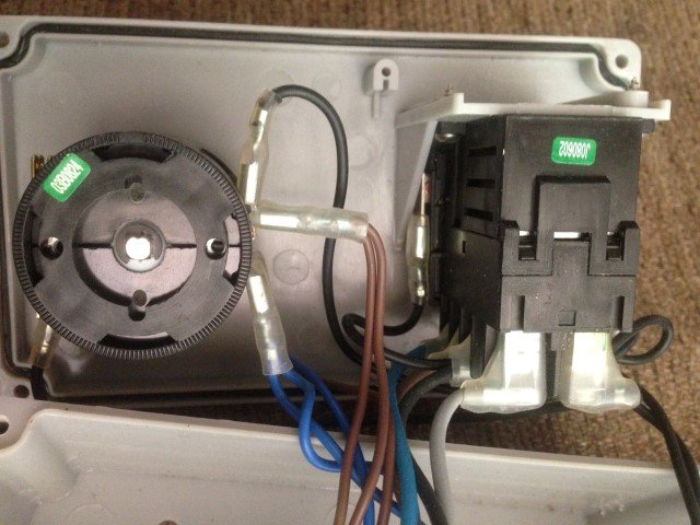

Can you show us the No Volt Release with the cover off?
Originally I'd have thought the schuko plug will have been the power supply. The only other things I can think you'd have other than the motor supply are stop buttons/interlocks and indicators.
I'm thinking as it was from a planer that it will only be wired for the motor running one way.
Quite often there is a diagram in the motor terminal box lid. I'm not sure what the two black wires are for, possibly a thermal cut off or a centrifugal switch.
As above,
Did you check the reverse side of the cover, that youve took of the motor, there may be a schematic

these are the inside pics of the nvr switch.
if i cant run it with the nvr, surely someone knows how i can fit a normal plug to it to run it that way...
