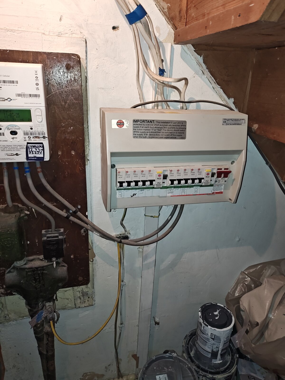

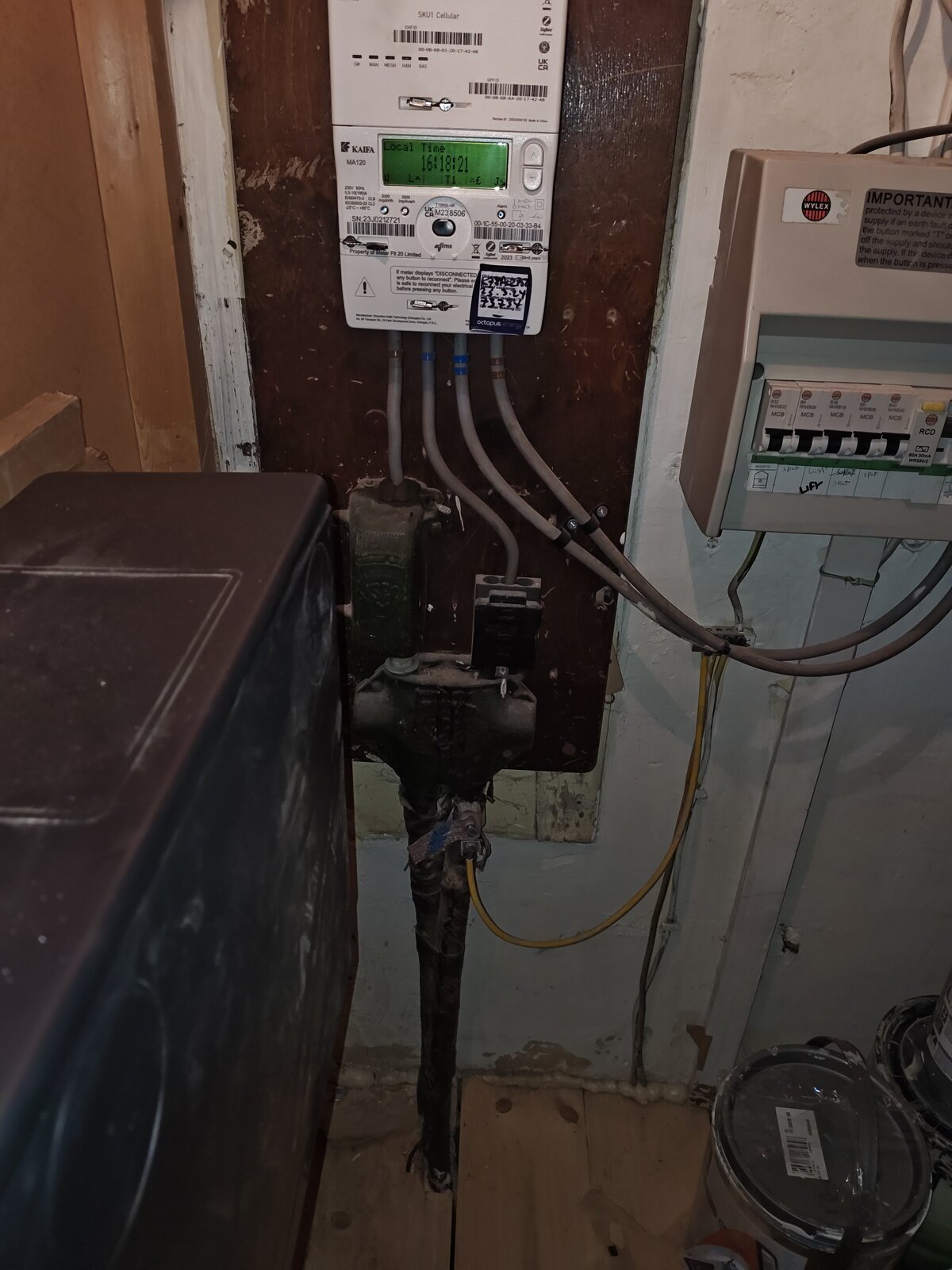

Hello all
I need some advice . So I have a high earth reading electrician came out and said my earth reading is 235 which is very dangerous . I have my electric meter underneath my staircase in a cupboard
He said the easiest way he can fix it is put in a tts cable from my garden through my kitchen in the where the meter is . He has quoted me £600.
I have spoken to UK power network and they have said they won't install a new pme? System or do anything as yes it their earth wires but it's a Tenby system and they can't work on it ?
Any advice I have attached pics

Its a TN~S system, Looks like 2 cables, its possible your neighbour has same problem

Has this been a TN- S system which has been converted to a TN-C-S system, necessitating a Local Grounding Electrode?
(There is a 4 or 5 connection "Earth" Block under the CU.
Is there any local Earthing Electrode Conductor now provided?
What is the purpose of the two conductors going down from this Earth Block - one fixed to the wall and one hanging loose?

Looks like it might have been TNS and somebody decided to connect a broken off Earthwire using a "Temby" earthclamp.

I do recommend you get this re-tested and the spark should do the Ze “inside” the CU and again with the earth connection directly to the service head connection
As for the DNO saying they can’t touch the income - they are the only people that should be touching it unless this is a flat

The dno saying they won't touch it because of the tenby clip so it's no longer their responsibility

It could be that the DNO are saying that because of that clip (which they wouldn't use), that earth' connection to the cable sheath must have been installed by someone other than themselves in what they regard as a TT installation - and if that were the case, they would have no responsibility for providing an earth, which you would have to provide with your own earth rod.
