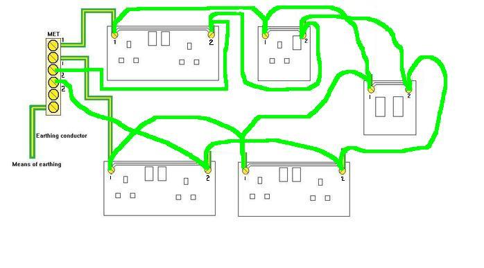

Spark123, what did you use to draw that picture?
And what is the rightmost fitting? looks like a double lightswitch?

So BAS, just to clarify things, is this picture more in agreement with what you are saying?
Yup.
And if I can out this diagram up without some frustrated petty twonk saying "ooh that doesn't comply either because the colours are wrong" you can see more clearly what is meant by "two individual protective conductors"
And how either one of the two individual protective conductors can be removed, leaving one remaining protective conductor which complies with Section 543.
"The" cpc is the problem You must have two of them, not one. And if you're going to argue that you do have two protective conductors at each point then you have automatically admitted that it's not complying with 543.7.1.3 (iii), because you can't count them as two AND show that EACH ONE is a ring with BOTH ENDS connected to the earth terminal at the origin.
543.7.1.3 (iii) does not ask for two separate independant circuit protective conductors, it asks for two individual protective conductors. As they are protective conductors they need to meet the criterion for protective conductors, not necesserally CPCs.
So as far as rings go, as long as the CPC is installed as a ring then it complies with 543.2.9, as long as there are two individual* protective conductors forming the CPC at each point** both complying with 543 then it gets the thumbs up from me.
The picture I drew (last april) is from guidance note 8 from the IET.
* individual as in separate i.e. if one is lost/broken, the other remains.
** teminated in separate terminals.
Read the disclaimer in the preface.
PAINT! OMG.... OK cheers, methinks I'll get some sockets drawn in google sketchup then lol.

But you also say that because you can do this:
http://i215.photobucket.com/albums/cc91/Spark-123/rfc2.jpg
you have two protective conductors.
Now you're saying you have one.
Do you really not see that your whole argument rests on illogical and inconsistent grounds, and requires you to ignore what common English words mean?

Nope, that pic shows a high integrity ring earthing system with a single fault taking out a protective conductor.
Nope, how I interpret it is obvoiusly different to the way you interpret it. I have taken on board what the on site guide and the guidance notes say on the matter also.
But then you do not have a protective conductor remaining which complies with 543.2.9. 543.7.1.3 says that you must have two separate ones, each of which complies with 543.2.9. If you have two individual conductors, each of which complies with 543.2.9, then if, as you say, you take one of them out, you must have one left which complies with 543.2.9.
But you don't.
If you claim that your diagram shows two protective conductors, each of which complies with 543.2.9, why when you remove one of them are you not still left with one which complies with 543.2.9?
If x-1 /= 1, then x /= 2.

Here's another way of illustrating the inconsistency in Spark123's argument.
According to him the diagram posted at the start complies with 543.7.1.3 (iii) because of his interpretation of "two individual protective conductors", and the way he counts things.
But it must also comply with 543.7.1.3 (i) and (ii), as all the aspects of topology and connections are outside 543.7.1.3 - it would look the same no matter which of 543.7.1.3 (i), (ii) or (iii) you decided to go with for the specification of the protective conductor itself.
So what consistent meaning for "protective conductor", and consistent way of counting them are there such that that diagram shows a circuit with both a single protective conductor and two individual protective conductors?
