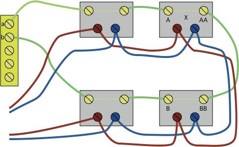

But here is my interpretation, and another diagram :
To my reading, 543.7.2.201(i) specifically states that A (singular) ring PE is acceptable.
I don't think that there is any doubt that that statement on it's own appears to be saying that other than the use of separate terminations, a standard RFC with a ring cpc already complies.
For the purposes of 543.7.1.203(iii), a-A forms one PE (which is also part of the ring cpc), AA-BB-B-b forms another PE (which is also part of the ring cpc).
These together make a standard RFC comply with very minor modifications.
So I believe the argument comes down to : can the ring cpc also be those two separate PEs at the same time ? I do not believe that is incompatible with the definition of PE "A conductor used for some measure of protection against electric shock and intended for connecting together any of the following parts ..."
You can of course argue that you cannot consider part of the ring in isolation like that. Well that's fine, and I believe that is your position.
But, in this image :
does that argument not also mean that you do not have "two individual protective conductors".
So short of complying with 543.7.1.203(i) or (ii) you need an extra PE over and above that. That contradicts what you've stated in the past to be your belief - that linking the ends of radials like that complies.

No, I mean it is a protective conductor, as used in 543.7 and defined in section 2
WHERE DO THEY EVER USE THE TERM "PE"?
In the definition in section 2. JohnW2 has raised this oddity before - the abbreviation for "Circuit Protective Conductor" is cpc, the abbreviation for "Protective Conductor" is PE :unsure: Would you be happier if instead of using the abbreviations in Section 2 I copied and pasted protective conductor every time ? Would that also apply to the use of other abbreviations in this forum - EFLI, Ze, Zs, R1, etc, etc, etc (it would make for some very long winded sentences :rolleyes:).
They don't use the term "PE". They use "Protective Conductor" which are the last two words of what?
"wine" is the last word of "wine glass" - that doesn't make every glass a wine glass.
"tipper lorry" are the last words of "articulated tipper lorry", that doesn't make every tipper lorry articulated.
Perhaps someone should email the IET and ask why there are two terms, and why each is used as it is in 543 ?
If you accept that cpc and PE are not the same thing, then 543.7 all makes sense and there's no problem. If you don't accept that, then 543.7.2 makes no sense at all.
