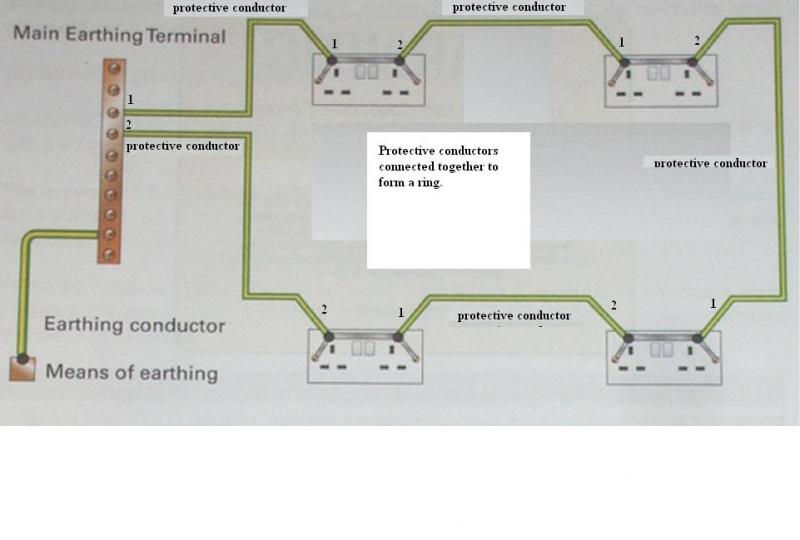

Nope, that pic shows a high integrity ring earthing system with a single fault taking out a protective conductor.
But then you do not have a protective conductor remaining which complies with 543.2.9.
No you wouldn't as it is in effect in a fault condition. Nor would you in a normal ring though. The risk is still reduced as the other of the two paths to the MET still maintains the connection to earth.
543.7.1.3 says that you must have two separate ones, each of which complies with 543.2.9. If you have two individual conductors, each of which complies with 543.2.9, then if, as you say, you take one of them out, you must have one left which complies with 543.2.9.
But you don't.
No you don't, but did you ever need the two to comply with 543.2.9 on their own? In a healthy ring state it will comply.
If you claim that your diagram shows two protective conductors, each of which complies with 543.2.9, why when you remove one of them are you not still left with one which complies with 543.2.9?

I don't claim them both to comply with 543.2.9, I claim there to be two protective paths via conductors from each accessory and in a healthy state it to comply with 543.2.9.

It has one circuit protective conductor made up of a number of protective conductors.
OK - so let's go with that for a while, and assume that when the regulations talk about the requirements for the protective conductor(s) of a circuit they don't actually mean the circuit protective conductor(s).
You say that there are a number of protective conductors, and that it's these to which 543.7.1.3 refers.
So how do we resolve the inconsistency between that, and 543.7.2.1 (ii) (a) where it also uses the term "protective conductor", but says "a radial final circuit with a single protective conductor" and "the protective conductor being connected as a ring"?
You can't take one of your multiple protective conductors and claim that it is also the single protective conductor for a radial final circuit, nor can you take one of your multiple protective conductors and form it into a ring.
But if we regard "protective conductor" and "circuit protective conductor" as synonymous (which is really hard not to when faced with phrases like "a ring final circuit with a ring protective conductor", or "a radial final circuit with a single protective conductor") then all of the inconsistencies just disappear, and we are left with a perfectly clear, logical and unambiguous set of requirements which all fit together.
In the pic I drew the protective conductors were formed together and connected as a ring. It still doesn't alter the fact that there are two paths for current to flow through two different and independant of each other legs. A protective conductor can connect together an exposed conductive part and the MET. It can also connect together two exposed conductive parts.
If you had two then you would be able to measure two different continuities between two sets of ends at the CU. But you can't, because you don't have two.
You can't do this with a bog standard radial circuit, but that doesn't mean it doesn't have a protective conductor.
I was talking about ring cpcs. You can measure the continuity between the two ends of a bog standard radial cpc, just not at the CU. And if the radial circuit had two separate cpcs then you could measure two separate continuities.
I have never claimed there to be 2 ring protective conductors though.
No you haven't, but then that is the basis of your argument, that "protective conductor" and "circuit protective conductor" are not the same thing, even when the regulations say "a ring final circuit with a ring protective conductor".
I am not saying they are completely different, just the circuit protective conductor can be made up of protective conductors.

Of course, if we consider it as a single circuit protective conductor no matter how many times it's bent and connected to a socket terminal then we don't have that inconsistency to deal with.
Yep, I would consider it a single CPC.

Notice the use of the word protective conductor as opposed to Circuit protective conductor though
Could you please pick one of the rings at any of the points in your diagram and remove it, and show how at that point there's only one ring left?
I don't need to remove a ring though, just one protective conductor. Each accessory will still be connected to the MET via protective conductors.
But if you had started out with two separate protective conductors, each of which complied with 543.2.9 then removing one would still leave you with one remaining protective conductor complying with 543.2.9.
The fact that you don't have one left proves that you didn't have two in the first place, because the solution to

With the explanatory text removed this could be showing a ring cpc for a ring circuit, complying with 543.7.1.3 (i) or (ii), or according to you (iii).
It could also be showing the cpc for a radial circuit complying with 543.7.2.1 (ii) (a).
Can you please show how a consistent definition, and method of counting, could be applied to that diagram to label
  1. 543.7.1.3 (i) a single protective conductor
  2. 543.7.1.3 (ii) a single protective conductor
  3. 543.7.1.3 (iii) two individual protective conductors
  4. 543.7.2.1 (ii)(a) a single protective conductor connected as a ring

Yes you do - 543.7.1.3 (i) defines the characteristics of the conductor, 543.7.2.1 (ii)(a) tells you to connect it as a ring.
(ii) if it's a 4mm cpc ( with mechanical protection ) you don't need to connect back form the last socket..
Ditto
(iii) if it's less than 4mm then you need to connect it back from the last socket ( via metal trunking / conduit, a seperate earth wire, or by connecting to the last socket of a similar radial
Not quite - you need to do that whatever.
for (iii) you then have 2 individual conductors connected in the form of a ring.
Which makes one ring.
by your definition then, as soon as you connect the ends of the conductors at the sockets and earth terminal, you no longer have 2 individual conductors, just a single one..
Yes - one single ring conductor.
Which is OK in 10mm², or 4mm²+protection, but if not (e.g. the circuit is wired in 2.5/1.5mm² T/E you need two individual rings.
No you don't - you only need one.
But to comply with 543.7.1.3 (iii) you need two, each of which complies with 543.2.9.
This is where my thoughts differ in the interpretation from you.
Then your interpretation leads to an arrangement which does not comply with 543.7.1.3 (iii).
If the individual protective conductors are sized in accordance with section 543 and they form a ring then I don't see the problem.

So how does your diagram show compliance with 543.7.1.3 (i) and (ii) which require a single protective conductor?
I don't claim the diagram to show any sort of compliance with 543.7.1.3 (i) and (ii), these require a protective conductor to connect the item back to the MET in the sizes stated.
So now that we've got that little diversion out of the way, if I could ask you again to consider a circuit with the cpc unbroken (without assuming I'm saying it has to be to comply with the regulations), if you had a continuous length of copper wire with little U shaped bends in various places, when does it become two conductors and how, and why when whatever the operation is that takes it from one to two is carried out another n times doesn't it take it to n+2 conductors?
So it is OK for the conductors to be classed as separate conductors if connected but looped at the MET, but not if they are connected and looped at an accessory? The idea of high integrity earthing is to either ensure the path to earth is not lost or to provide another path should one be broken.
I read "two individual protective conductors, each complying with...." as meaning two individual protective conductors, each complying with... :?
i.e. "this individual protective conductor, complying with... and this other individual protective conductor complying with...".
There really is no more reasonable interpretation, and in fact I'd hardly call it an "interpretation" at all - English is my first language, and it's written in English. I just read it, and understand it, in the same way that if I read "two individual fillets of white fish, each weighing about 250g" or "you'll need two individual pieces of 4x2, each 8' long" I'd know exactly what it meant without engaging in tortuous "interpretation".
Maybe the fact that you feel you need to "interpret" what is written rather than just simply reading it is part of the problem here?
The problem is that if in 543.7.1.3 you decide that "protective conductor" means one of the individual links, that doesn't allow you to just have a single one as per (i) and (ii), nor two of them as per (iii), nor does it allow you to have each one complying with 543.2.
Do you take into account the disclaimers in those?

However you define and count them, this diagram:
does not show two individual protective conductors.

OK - assuming that the sizes are OK, do you claim that the layout of the protective conductor(s) complies with 543.7.1.3 (i) and (ii)?
Never mind what the reasons for high integrity earthing are - will you please stop evading a request for you to explain how you designate and count individual conductors.
If you had a continuous length of copper wire with little U shaped bends in various places, when does it become two conductors and how, and why when whatever the operation is that takes it from one to two is carried out another n times doesn't it take it to n+2 conductors?
Can you clarify what the numbers mean?
I can see individual lengths of protective conductor with:
. a 1 at each end
. a 2 at each end
. a 1 at one end and a 2 at the other
so they can't be saying "this is protective conductor #1 and this is protective conductor #2"
Also that drawing has 5 components each labelled "protective conductor" - can you explain how they relate to either the requirement in 543.7.1.3 (i) and (ii) for "a single protective conductor" or the one in 543.7.1.3 (iii) for "two individual protective conductors"?
It shows a duplication of a protective path which the people at the IET who write the guides appear to deem to be an acceptable method.
If the conductors were larger then they would comply, I don't rate the idea of using the 2 screws in the back of the sockets to extend the protective conductor of the circuit around. A bus bar system or individual protective conductors from an earthing terminal may be a better idea for (i) and (ii).
I'd count them between their terminations and/or change in use. The diagram before clearly shows the conductors to be separate conductor lengths though.
. a 1 at each end
. a 2 at each end

A ring final employing accessories with 2 terminals with a protective conductor in each terminal provides duplication of the protective conductor. They are separate from each other as in they provide a separate route for current to flow. In the event of one being lost the other one maintains the protective path.
Two separate routes is not what The Wiring Regulations say is required.
You'd have to check each of them complies at each point.
So at each point you believe that there are two conductors, each of which complies with the requirements of Section 543?
I've checked, and I can't see that there is. Yes there are two individual current paths back to the MET, but there are not two rings at each point, and that is what is required by one of the paragraphs in Section 543.
Furthermore, if you are now to use "two independent current paths" as what is really being asked for by 543.7.1.3, then please use the same interpretation in the rest of Section 543 and show how the circuit has two independent current paths each of which complies with Section 543.
So you say that it shows an arrangement which complies with a requirement for a single protective conductor.
And with one which requires two individual protective conductors.
And you really don't see any inconsistency there?
If that circuit was installed with just a 10mm² cpc being done first, and then phase & neutral added in a radial design then you say it would comply because it had the single protective conductor required by 543.7.1.3.
If it were then turned into a ring final by extending the phase & neutral conductors back to the origin then you say it would comply because it had the two individual protective conductors required by 543.7.1.3.
Can you please show how turning the phase and neutral conductors into a ring and doing absolutely nothing to the cpc would double the number of protective conductors?
But how many does it show, in your scheme?
Does it show the single protective conductor required by 543.7.1.3 (i) and (ii) or the two individual protective conductors required by 543.7.1.3 (iii)
Not really, the protective conductors do not need to form a ring when they are larger.
It shows a single ring circuit protective conductor which is made up of a number of lengths of protective conductors. The integrity of which is doubled as it has two connections with the MET.
Nothing to do with (i) or (ii). It shows two paths for protective currents to flow through separate conductors.
There are two protective paths via the various protective conductors back to the MET from each point. Point 1 on the each socket is providing a path back to 1 on the MET. Point 2 is providing a path to 2 on the MET via a separate protective conductor route to that of 1.
But 543.7.1.3 doesn't say that from each point of use there shall be two protective paths back to the MET.
It says that the circuit shall have two independent protective conductors.
The two protective conductors at each point are independant of each other :wink:
So, who won in the end? :lol:
If you pair need something to do you can help me put my coving up! :wink:
But not a direction described by The Wiring Regulations.
Maybe in your eyes not, but in the eyes of the IET who write the guidance notes it complies.
Well then here we have a very real and serious problem. Because even the IET intended exactly what you say, that is not what they wrote in The Wiring Regulations, which are also a British Standard.
National standards cannot be amended by non-standards body publications. GNs are published by the IET - they are not BS documents, and they neither define nor amend formal standards.
But it does not show a method deemed acceptable by the people who wrote and ratified The Wiring Regulations.
And yet it is the people from the same place who write the guidance on the document...
GNs are published by the IET - they are not BS documents, and they neither define nor amend formal standards. And they have disclaimers.
The same organisation who wrote the guidance notes and the on site guide too.
GNs and the OSG are published by the IET - they are not BS documents, and they neither define nor amend formal standards. And they have disclaimers.
543.7.2.1 (ii) (a).
In which case for it to comply with 543.7.1.3 (i) and (ii), then "protective conductor" in the phrase "a single protective conductor" in those two must be synonymous with "ring circuit protective conductor", in order to match your "a single ring circuit protective conductor".
I suggest that it would be utterly preposterous to decide that within one regulation a term varies in meaning from one sentence to the next, so in 543.7.1.3 (iii) it's also synonymous, and therefore 543.7.1.3 (iii) requires two individual ring circuit protective conductors.
How can it be nothing to do with a regulation you say it illustrates?
If it's supposed to tell you how to comply then it must show something which does comply.
And no matter how many times you talk about current paths that will not change the words printed on the pages of BS 7671:2008.
But that's not the requirement written in The Wiring Regulations.
543.7.2.1 (ii) (a).
Doesn't (iii) allow you to refer to 543.7.1, 543.7.1.3 (i) and (ii) which are the regs relating to using larger protective conductors which don't mention using ring conductors?
Yet in 543.7.2.1 it requires a ring protective conductor, as in one ring protective conductor?
543.7.2 Socket-outlet final circuits. The following arrangements of the final circuit are acceptable:
(i) a ring final circuit with a ring protective conductor
(ii)(a) a radial final circuit with a single protective conductor connected as a ring
i.e. you can meet the requirement for a radial with a ring cpc.
i.e. the diagram showing a ring cpc could be showing a compliant cpc for a radial circuit, which is what I said.
543.7.2.1 (i) + 543.7.1.3 (i) a ring final circuit with a ring protective conductor having a cross-sectional area of not less than 10mm²...
543.7.2.1 (i) + 543.7.1.3 (ii) a ring final circuit with a ring protective conductor having a cross-sectional area of not less than 4mm²...
543.7.2.1 (iii) + 543.7.1.3 (iii) a ring final circuit with two individual ring protective conductors...
I'm not disputing the fact you can use a ring CPC on a radial, this is generally for when the CPC is smaller than required by 543.7.1.3 (i) or (ii).
If you decide to want to install a conductor sized in accordance with 543.7.1.3 (i) or (ii) then 543.7.2.1 (iii) will be complied with hence there is no requirement to form a conductor of those larger sizes into a ring conductor.
I don't like the way the OSG 16th ed changes the wording of the regs! It has (iii) as duplicate protective conductors each complying with section 543. Talk about a mess. It also shows 1.5mm² cpcs, so it is back to two individual vs duplicate protective conductors!
