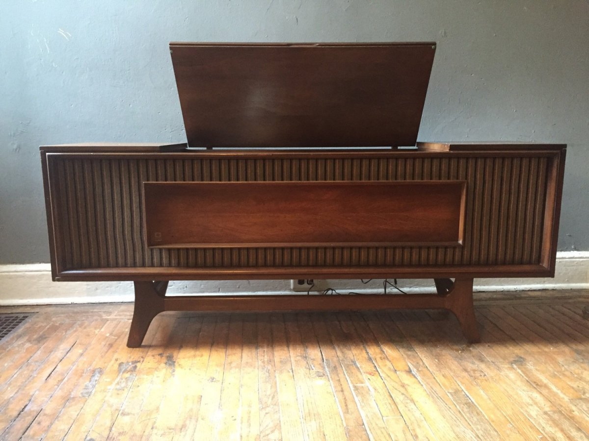

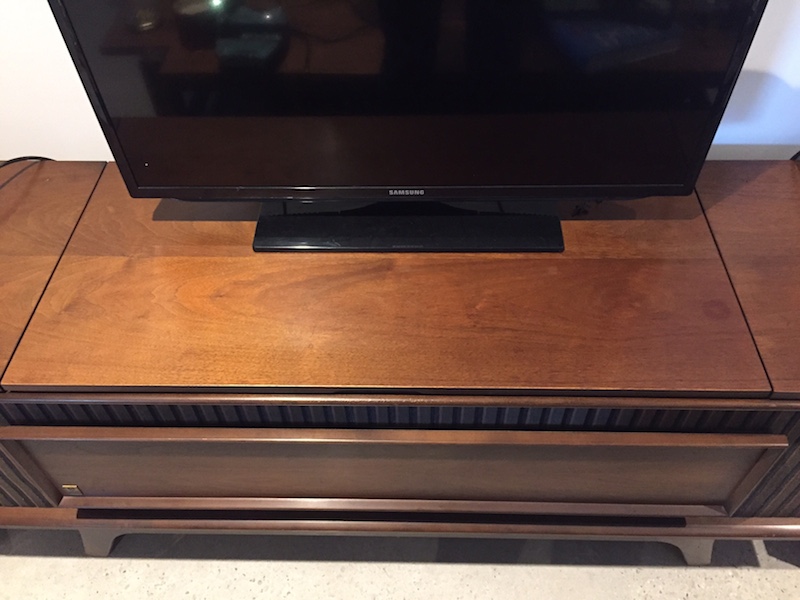

I'm repurposing a vintage radio cabinet as a modern stereo cabinet and TV console. As my components will reside inside the cabinet, replacing the original stereo components, I need to be able to access their front control panels while the TV is atop the door/lid. I want to do this by cutting the top lid into two pieces and hinging it so that I can fold open just the front half.
I'm looking for some help in how to do this — mainly in what kind of hinges I would need to install in order to have the front half fold back upon the back half, without the hinges showing on the top side of the lid (if this is possible). Any suggestions would be appreciated.
Would it not make more sense for the front half of the lid to fold outwards towards you, rather than up into the TV which is kinda in the way? This would simplify the hinging. Otherwise what you want is a 'concealed hinge'. There are many types.

I hadn't thought about the lid opening toward me. Interesting idea. Though, in that scenario, I think I'd need to add two things: 1) Some kind of surface knob in order to pull it open from the center, where it's cut, and 2) Something to hold up the front half (where it's cut from the back half) when it's down, because it would no longer be supported underneath at that point. I suppose that a small lip/rest on both sides would be easy enough.

Why not mount tv on a timber screwed to rear of unit , you could then move the unit keeping the tv above.
An alternative to hinging would be for the front part to slide forward using telescoping desk slide rails. Small slide rails could be recessed into the side edges of the moving panel.
Soss hinges. Make sure you've got enough ventilation in the back of the unit for whatever you are putting in there.

Regarding the thickness of the lid and Soss hinges, it's 7/8" thick.
there you go that's the answer, didn't know they went that small. Indeed carful fitting , I would use a router with a double fence
