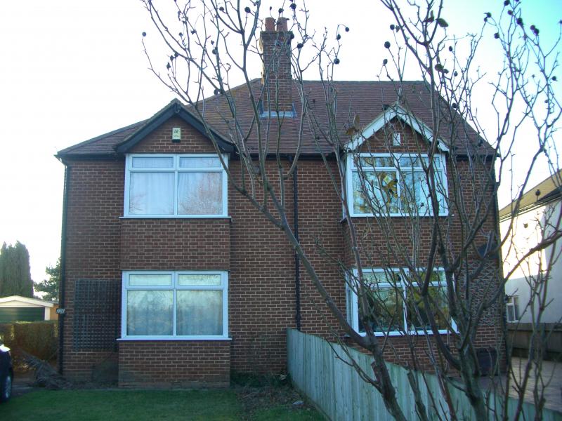

This shows what the neighbours have already done, dormer on rear.
