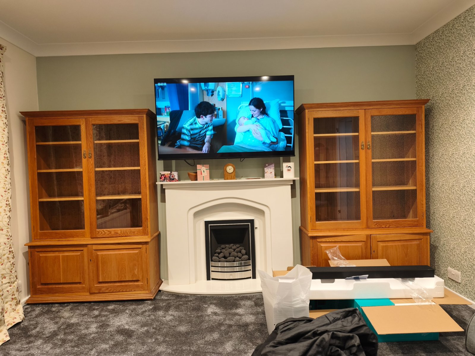

Got my soundbar kit. But there are burger all instructions about layout of the components.
In the kit are a soundbar, a sub and two rear speakers.
I have gathered the best position for the bar itself underneath the TV.
And the rear speakers are best behind the primary seating area aimed towards the middle.
But where is the best place for the sub? The instructions were not at all clear.
Any advice, please?

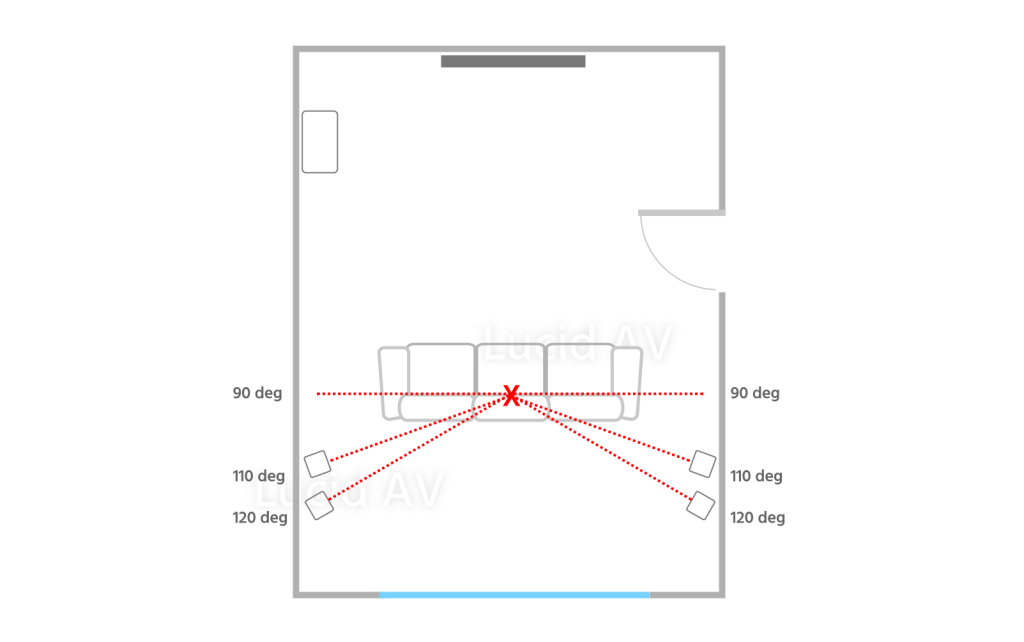

The surround speakers should be on the side walls, set a little way back. The angle from the main listening position (MLP) is 110~120 degrees relative to 90 degrees being in line with the MLP. The speakers should be turned to face the MLP.
The height of the surrounds should be 12" / 35cm above ear height for the MLP. There's no need to angle the speakers down.
Subwoofer position depends on the frequency range it's covering. Since the Hisense kit is a sound bar, and the slim profile doesn't cater for larger drivers, the subwoofer will be covering part of the fundamental male vocal range. You'll hear some of male voices speaking from the sub as well as the sound bar. For this reason, the subwoofer should be at the front of the room, not the rear. It should be nearer to the soundbar rather than further away.
Usually as central as possible , below tv
Thanks. As per the piccy, it can't go there due to the mantel and the hearth.
I'm thinking of putting it on top of the left hand oak cabinet, or at the bottom of it if that would be better.
The sound bar provides the voices to go with your picture. Do you really want the voices to come from the top of a cabinet?
Find new homes for the bits on the mantel. There’s your home for the sound bar. You might even be able to bring the telly down a bit to close the gap and hide any cables.
Sorry, there is a bit of confusion here. The confusion is a little bit me as I wrote mantel when I only meant hearth...DOH!
The soundbar is on the mantel.

But the sub can't go centrally below the TV, due to the hearth, so I guess I shall experiment with it at floor level in various positions around the room.
You can get soundbar brackets that allow you to put the bar directly underneath or on top of the TV.
This would still give a little room for nicknacks on the mantle, not the clock though.
In the real world the subwoofer typically goes in the corner or somewhere else out of sight. Because you know, it's a fecking great big ugly black box and generally people don't want to be able to see it.
Given the audio frequency the sub is covering, and its need to be more towards the front of the room, I would suggest the natural place is the right wall, a little closer to camera than the mains sockets, but also clear of the cabinet doors. Maybe disguise it with an occasional table? The sub is only 12" tall and under 9" deep.

Given the audio frequency the sub is covering, and its need to be more towards the front of the room,....the right wall, a little closer to camera than the mains sockets, but also clear of the cabinet doors.
Great!
Still got some bookcases to move back into the room before I can properly set up the sound system but I'll get back when it's done.
Thanks again to everyone.
